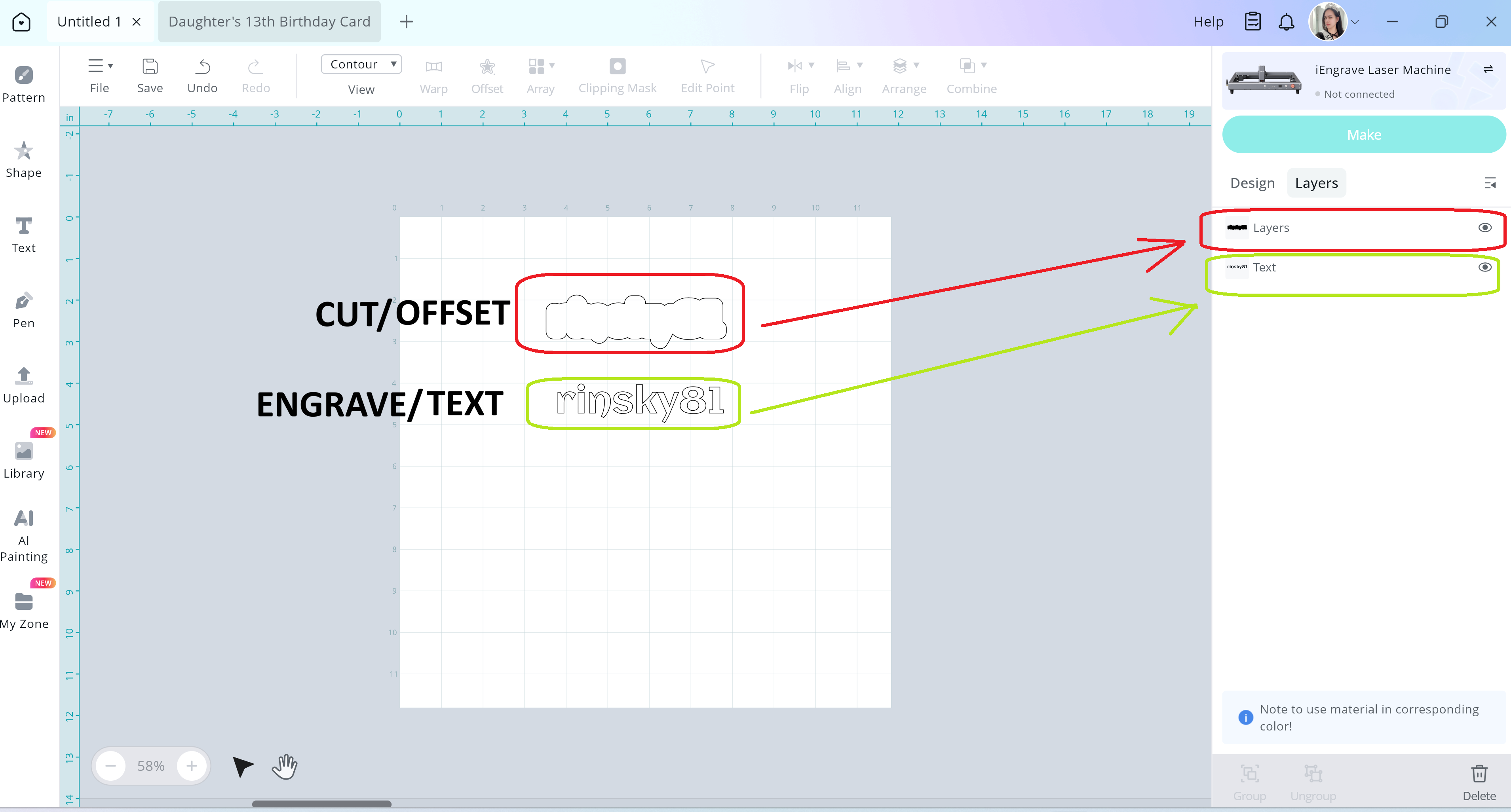

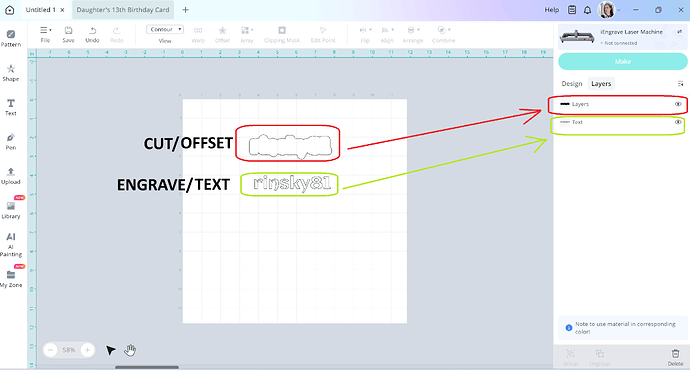

So in IdeaStudio for the engraver, is there a way to print and cut in the same design. Example write a name via engraving and then cut that name out. Hope that makes sense.
Each would be a layer one cut 1 engrave
Hi @Laura_Lynn! Yes — the iEngrave can now engrave and cut in a single task. In the sample below, I added my name as text (engrave) and then created an offset so it cuts neatly around the engraved design. Hope this helps!
