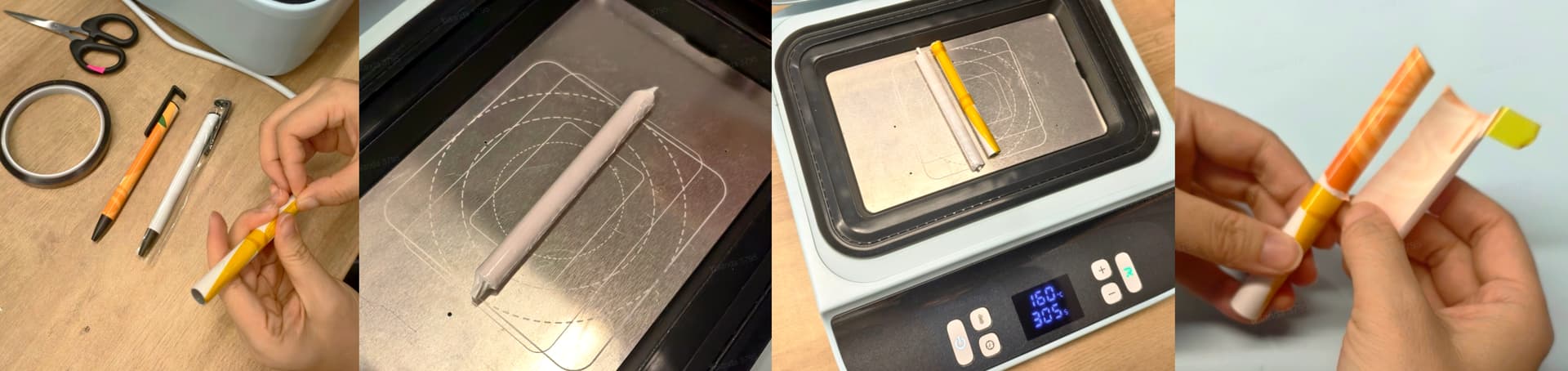

:pen: Sublimation Pens
The H17 can double as a compact sublimation “oven” for pens. You can even press several at once.
For reference, this project was done at
Top and bottom plates: 160°C
Time: 300 seconds
Steps
  1. Print your sublimation design and trim it to size. Wrap it tightly around the pen using heat-resistant tape.
  2. Slide a shrink sleeve over the pen and place it into the machine. The heat will shrink the sleeve automatically, so there is no need for a heat gun.
  3. Continue heating until the 300 seconds are complete.
  4. Remove, peel off the paper, and reassemble the pen.
Community member @Eileen_Stafford shared a detailed walkthrough titled Sublimating Pens with HTVRONT Phone Case Heat Press. If you want a closer look at the full process and results, that post is worth checking out.

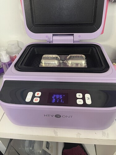

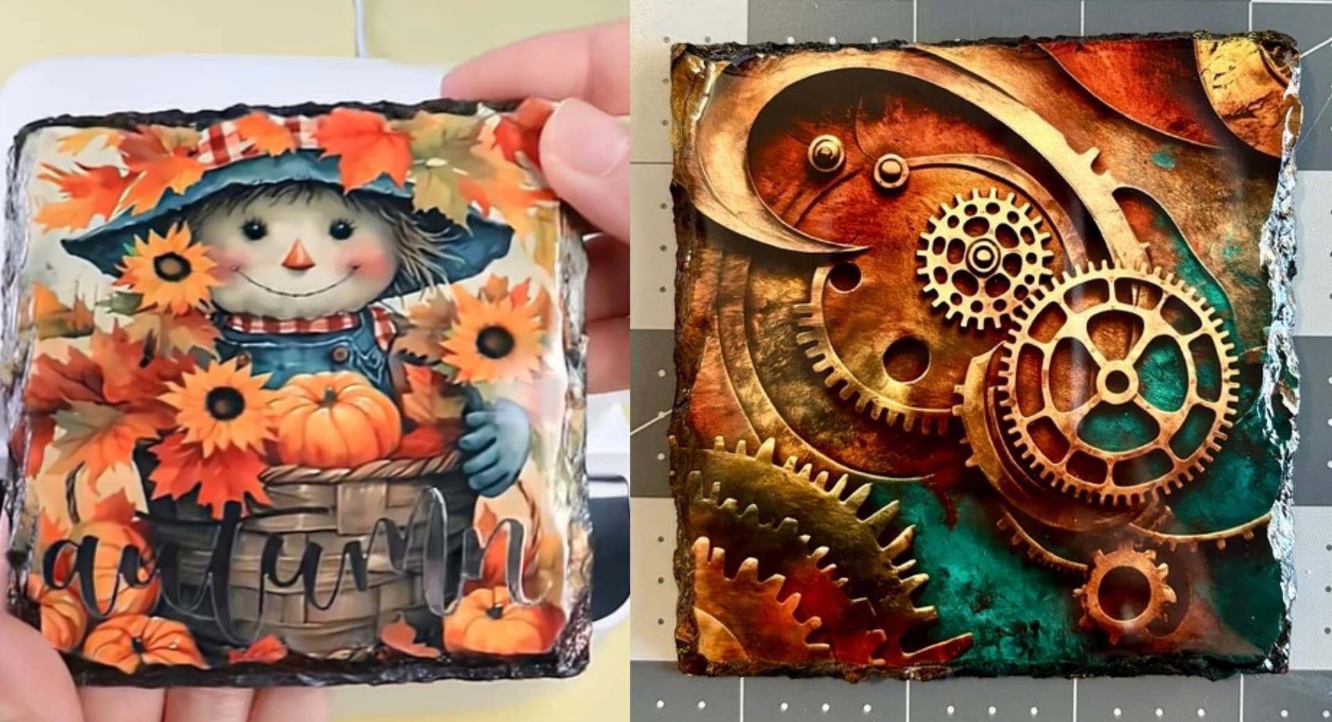

:coffee: Slate Coasters
Slate coasters are one of the more established H17 extensions.
@Eileen_Stafford has successfully used:
320°F for 400 seconds
The results show rich color and strong detail, especially for gift-oriented designs.
There has also been an interesting test using sublimation paper instead of film, combined with a thinner silicone pad to cover the transfer.
What we observed:
  • Flat surfaces such as coasters and badges transfer well.
  • Curved areas do not wrap as effectively as they would with film.
So if your design only needs to cover a flat section, sublimation paper plus a thin silicone pad can work. For more pronounced curves, film remains the more reliable option.

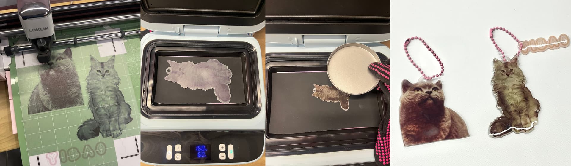

:key: Shrink Plastic Keychains
This is a fun way to create compact, personalized items.
Basic Process
  1. Use a cutting machine to contour cut your shrink plastic design.
  2. Place it in the H17 at 160°C for about 60 seconds.
  3. After opening the lid, press it flat gently with a smooth metal surface while it is still warm to help it settle evenly.
Community member @Judi_B experimented with this method in a project using the H17 blue heat press. It is a simple technique but produces satisfying results.

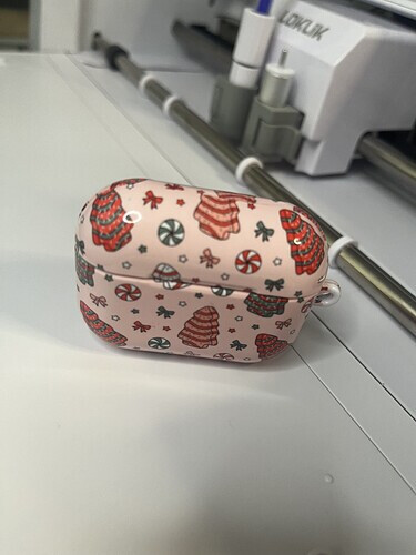

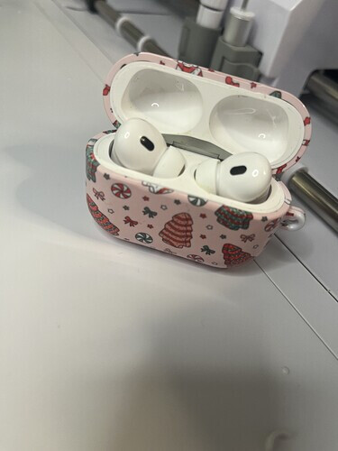

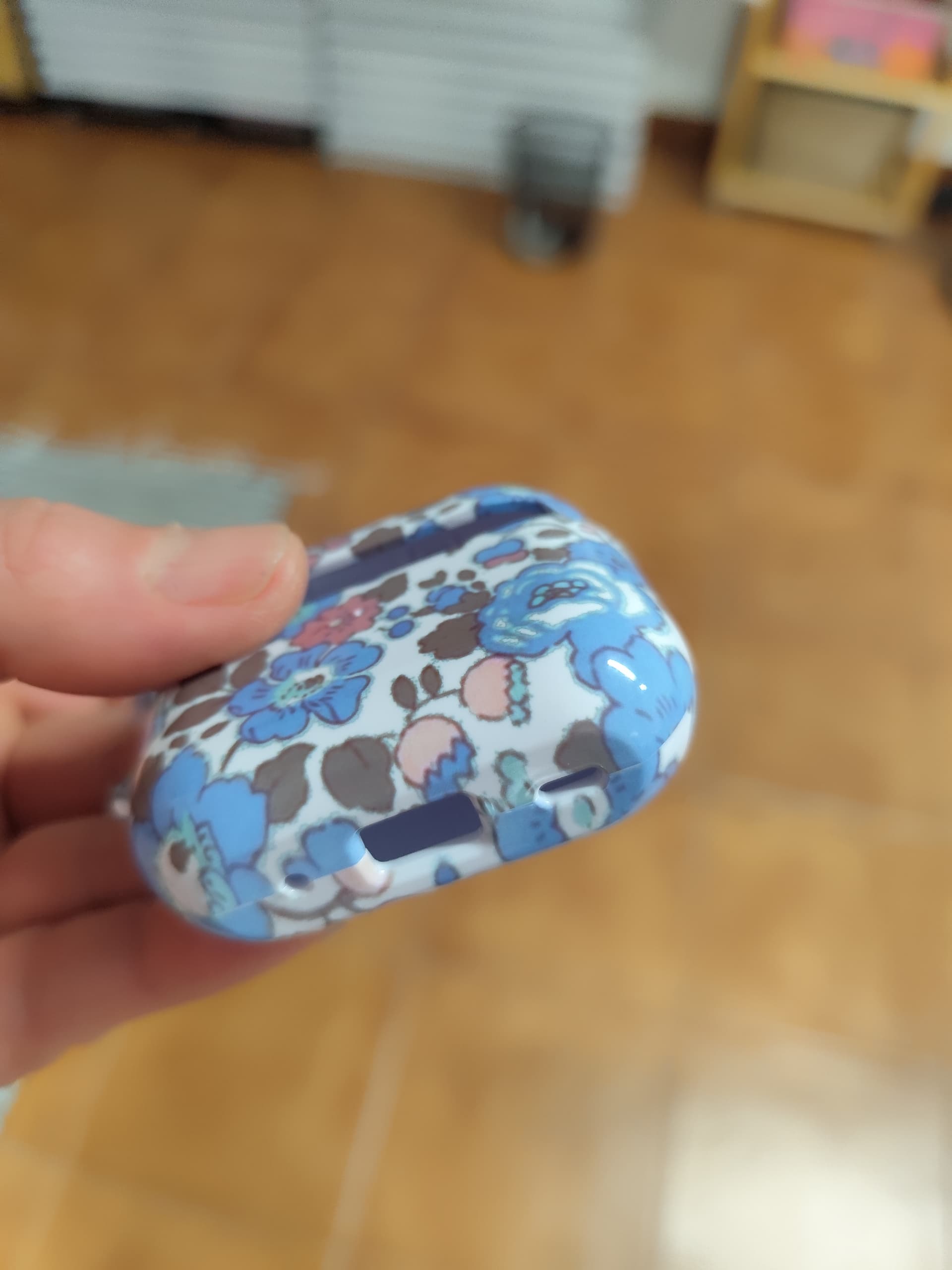

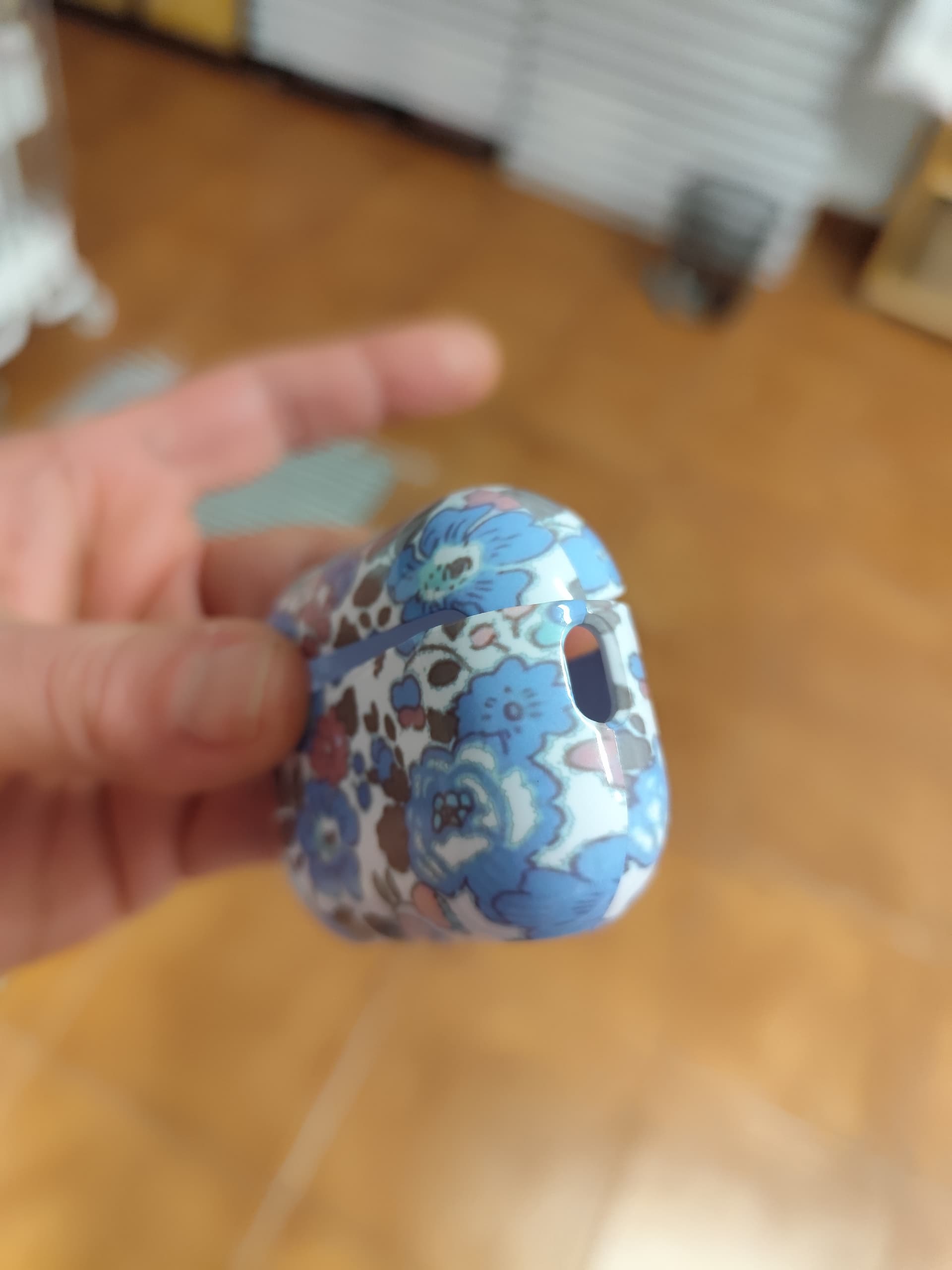

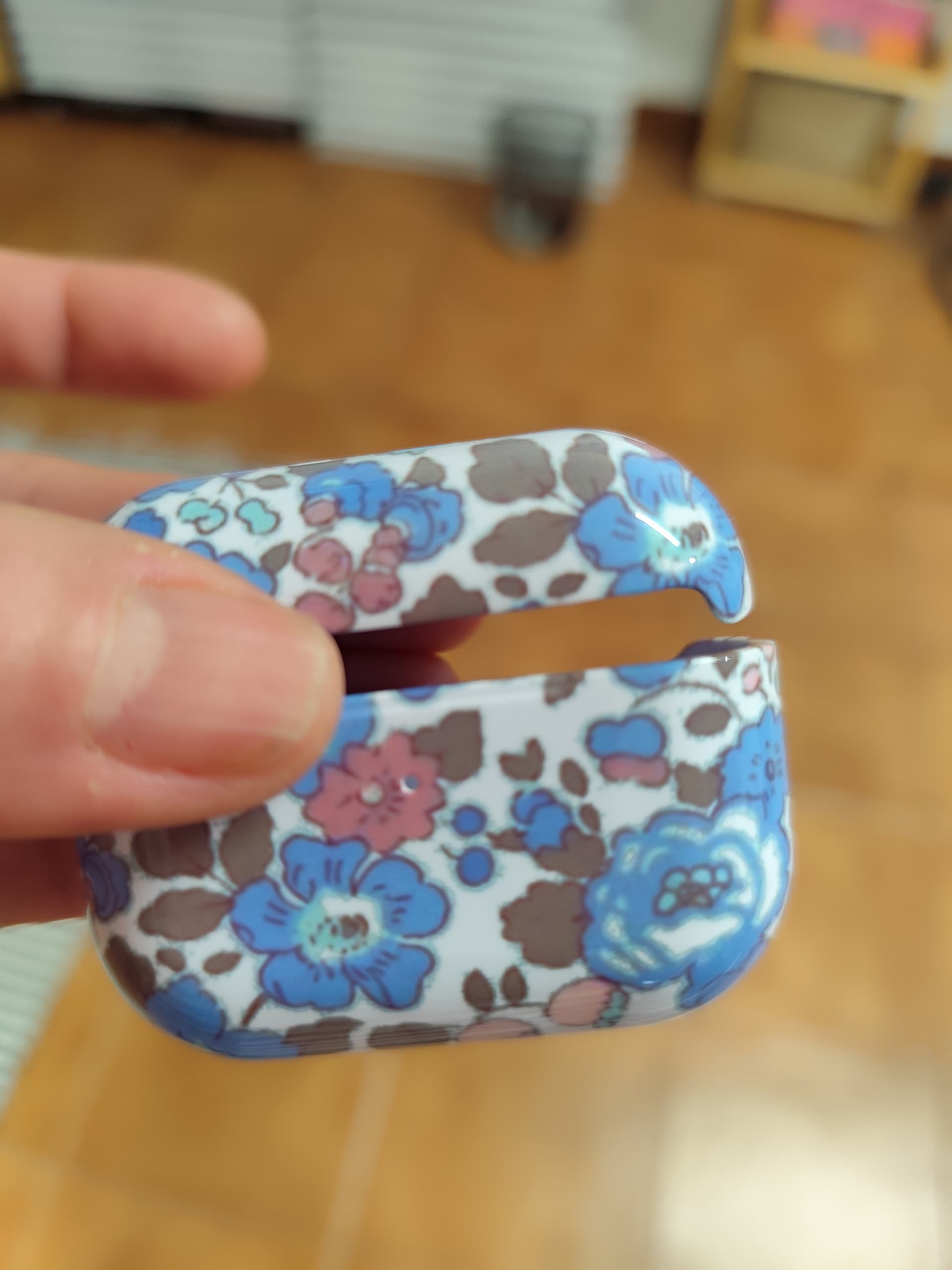

:headphones: Earbud Cases
Community member @amber_curtis shared a festive “airpod case” project inspired by Christmas tree cakes.
There are now dedicated sublimation metal heating tool jigs available for earbud cases. Paired with the H17, this becomes a strong option for personalized gift products or small-batch custom items.

Thank you for this.I see how you incorporated the cutting machine. Great ideas.
Would this also work on shrinky paper? If I had the machine, I would like to try it with that
It worked with @Judi_B shrink plastic. I’m pretty sure it would work with shrink paper, as they’re both pretty much made with the same material (polystyrene). That was the one that really caught my eye, as well.
I used printable shrink sheets I got from amazon. Theirs a lot of different brands.

I’ve used sub paper and shrink wraps in it for full wrap design and works beautifully. Acts just the same as a oven
So tickled to see people trying the silicon mat hack! I also learned the tighter you pull the mat before starting the machine, it will press too and sides as well with sublimation paper. It does help slightly to give a few small slits on the edges of the paper .
