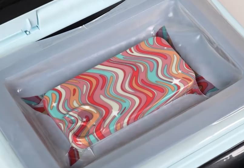

Unlike traditional sublimation paper, sublimation film is a stretchable PET-based transfer medium designed for curved surfaces. Under vacuum pressure, it conforms to the shape of the case while maintaining image clarity.
Inside the H17 workflow, the film is not an optional accessory. It allows the image to move with the shape of the product, making full-wrap coverage stable and repeatable.

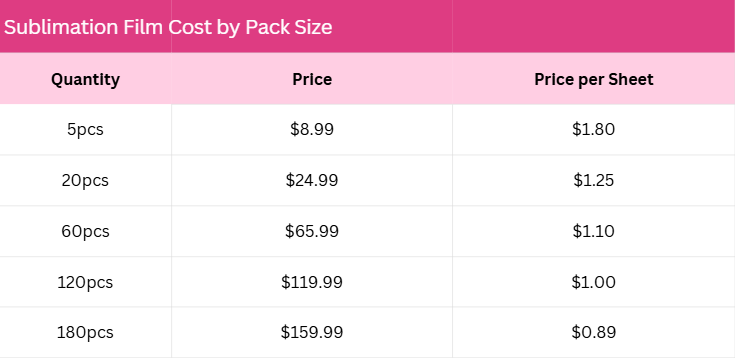

And on the cost side, film pricing also becomes more favorable with scale. As pack size increases, the per-sheet price drops
  • 20 pcs pack: about $1.25 per sheet
  • 120 pcs pack: about $1 per sheet
As production grows, material efficiency improves naturally. Within the full workflow, it becomes part of how the product delivers its value.

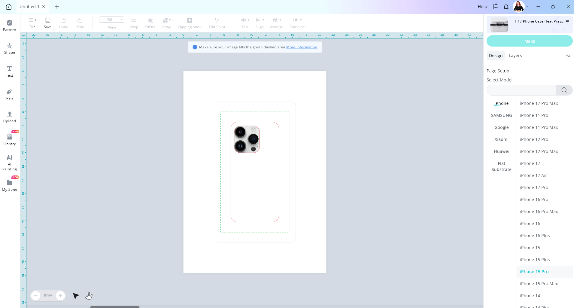

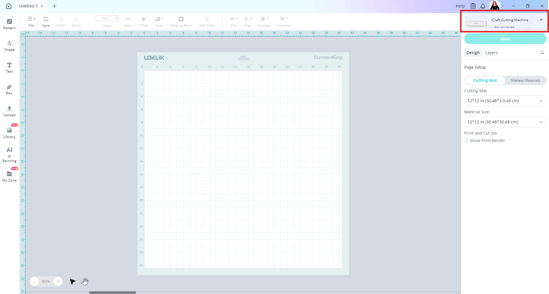

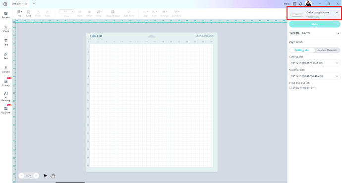

what is the custom size for a iphone15 pro
So the IPhone 15 pro is 5.77 inches in height, 2.78 inches in width, 0.33 inches in thickness.

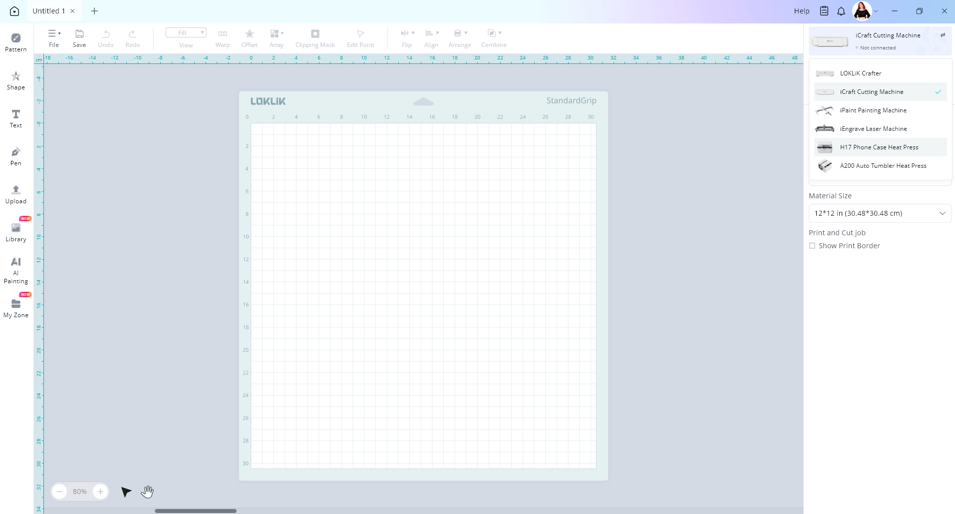

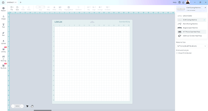

If you are looking how big your design needs to be you can go into LOKLiK Idea Studio
Change your machine to the H17 Phone Case Heat Press
Then look for the iPhone 15 pro model. Now you have a template that you can use to size your image
