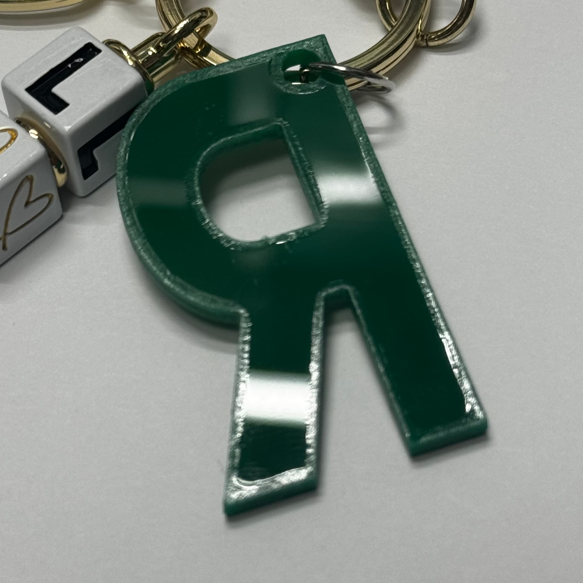

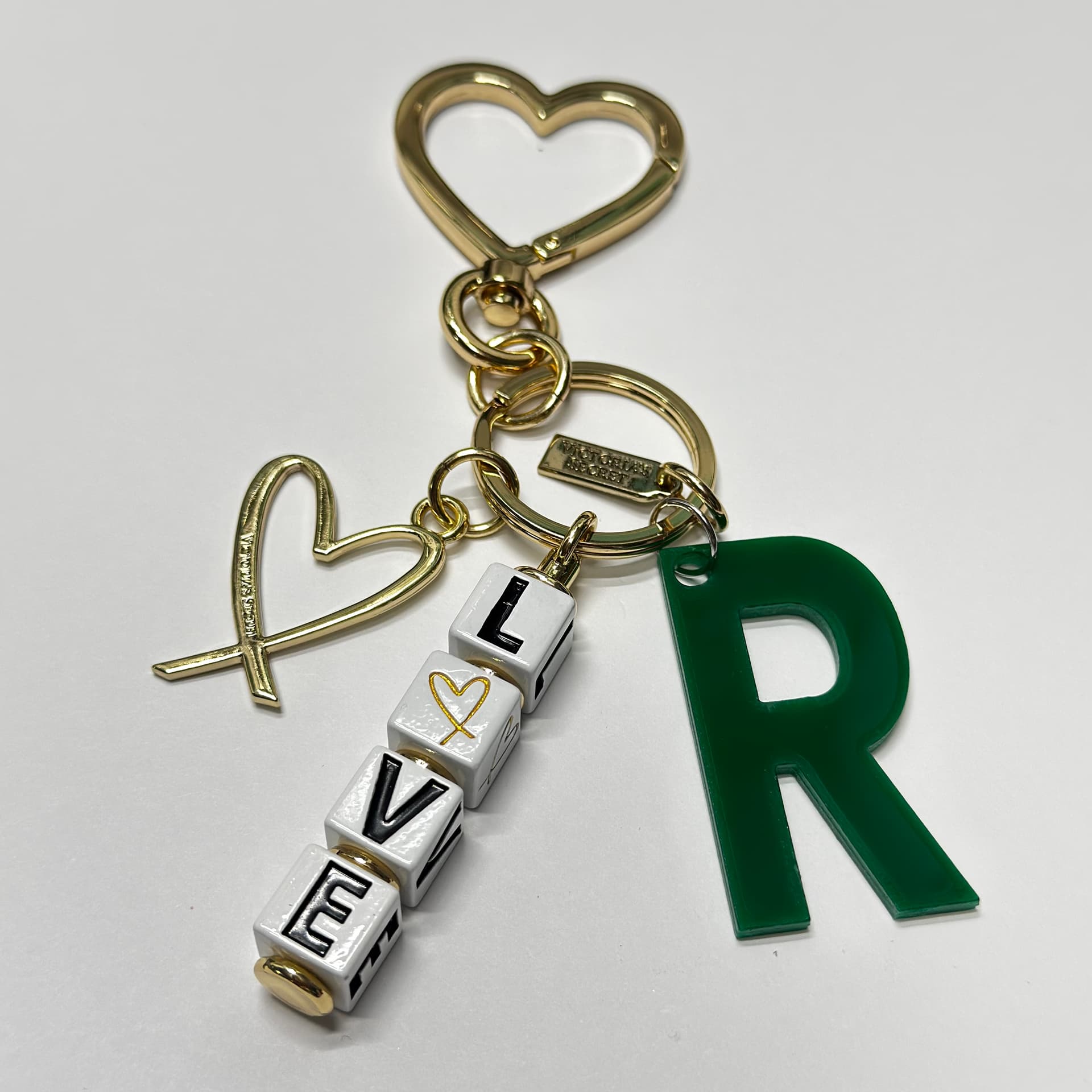

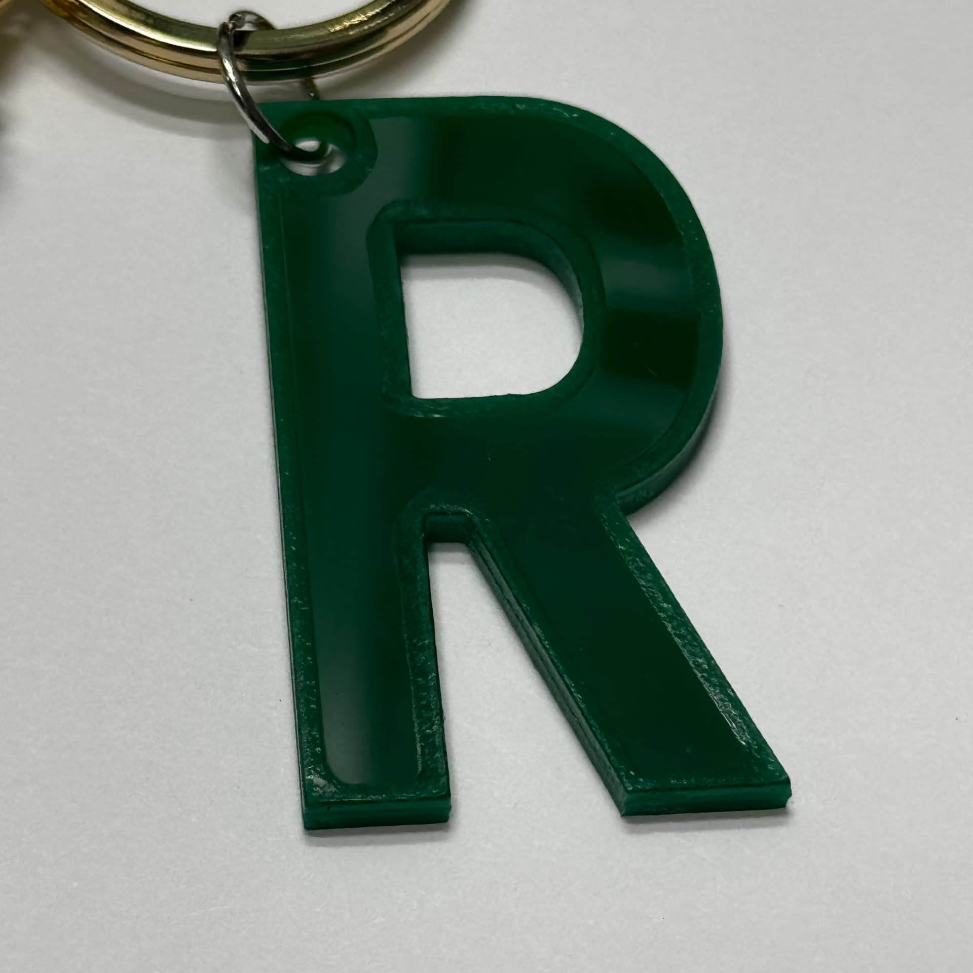

I personally haven’t tried engraving onto acrylic blanks but here’s my sample cut (closed up view) using the dark green acrylic with both paper backings still on. I didn’t use air assist for this cut, and the results came out great—but you’ll get even cleaner edges when you run it with air assist.

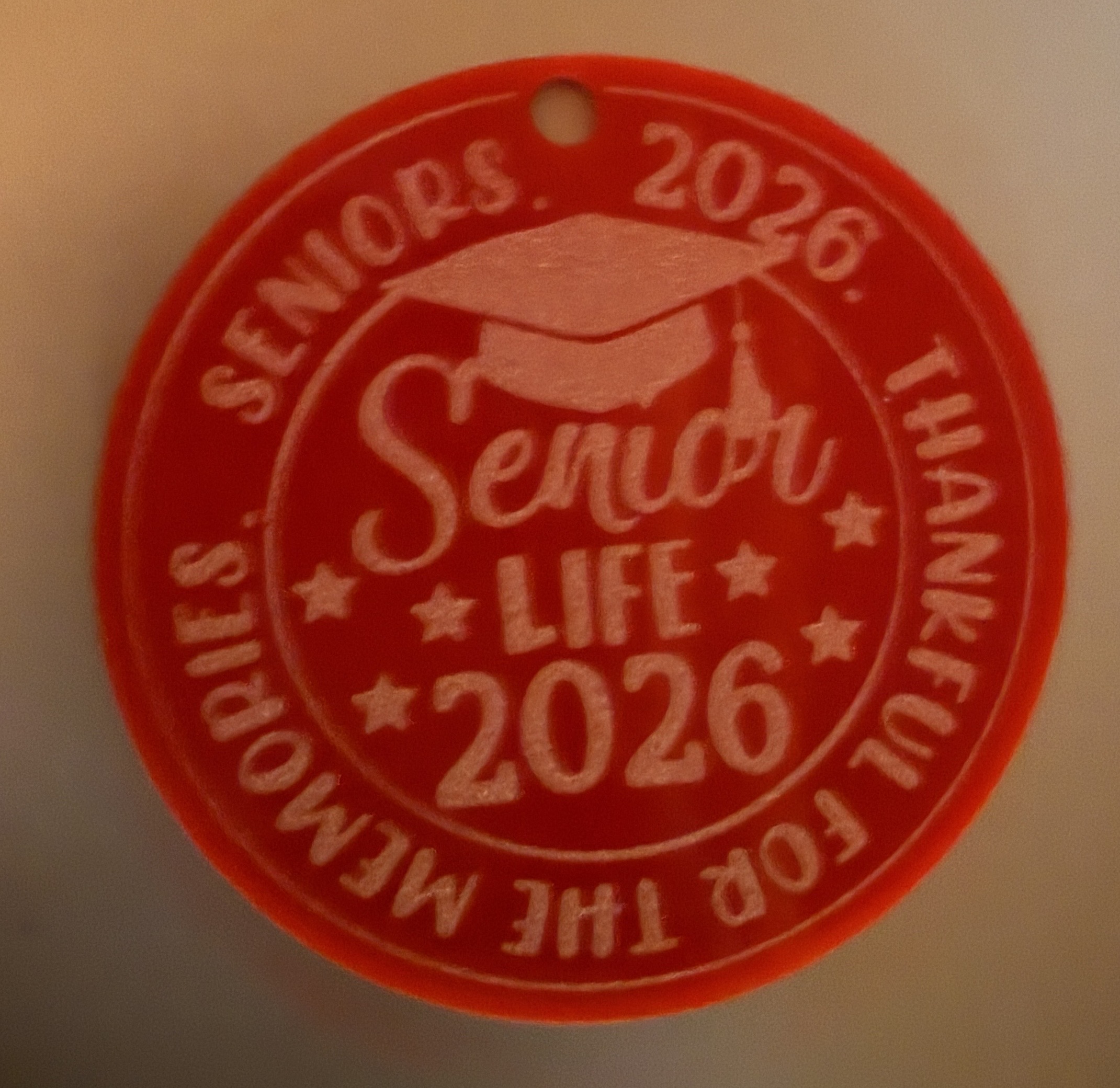

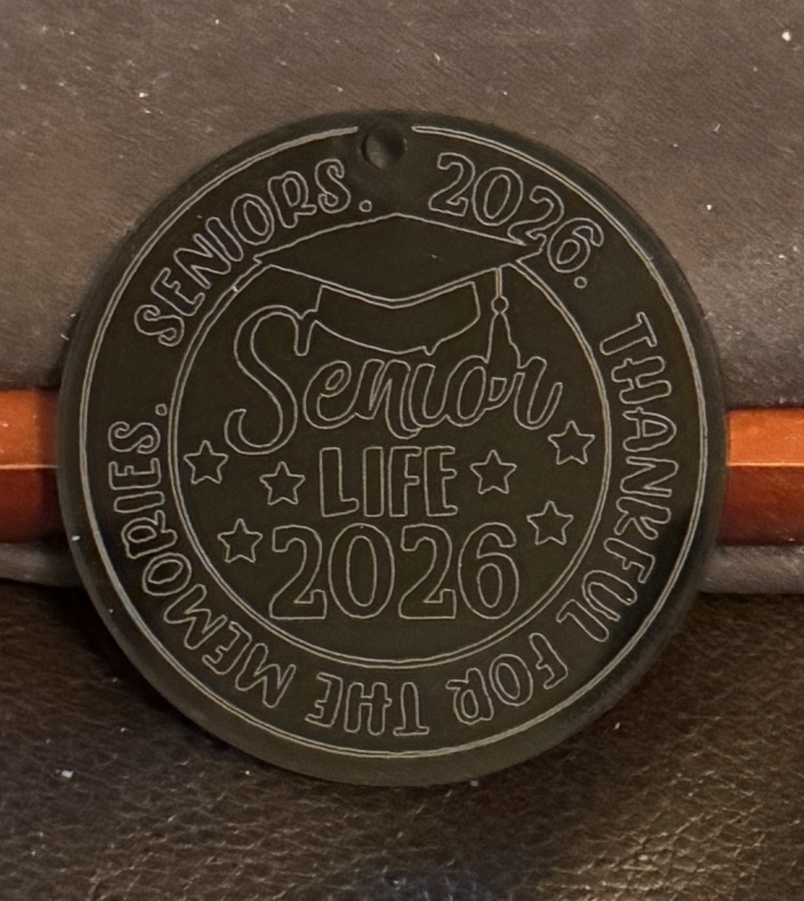

My green ones didn’t work. The red acrylic was better but still a bit rough. here is a picture of the black acrylic keychains i made.
Here is one of the red ones that actually worked okay.
