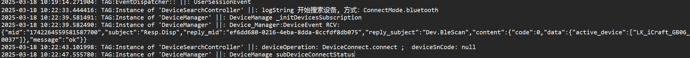

2025-05-09 20:24:21.073629: [DEBUG] TAG:DeviceTaskManager ||: saveTasks count: 1 userId: Je07qj3+UtOfMl+j0bvZrUUrqoODMYgPC1ULMqCxfBU=
2025-05-09 20:24:21.079336: [DEBUG] TAG:DeviceTaskManager ||: Saving tasks to /Users/mcglk/Library/Application Support/com.sjtech.loklikstudio/caches/deviceTasks.json
2025-05-09 20:25:06.172331: [DEBUG] TAG:Instance of 'DeviceManager' ||: DeviceManage subDeviceConnectStatus
2025-05-09 20:25:06.177301: [DEBUG] TAG:Instance of 'DeviceManager' ||: DeviceManage _initDevicesSubscription
2025-05-09 20:25:06.177945: [DEBUG] TAG:Instance of 'DeviceManager' ||: Device_Manager:DeviceEvent RCV: {"mid":"1746847506160343000","subject":"Event.Dev.ConnectStatus","content":{"connect_status":"DisConnection","device_id":"1746788261938307000"}}
《At this point, the device is disconnected; it had been working fine up to this point.》

Shared Preferences
Thing is, I didn’t actually quit LLIS at that point; I was still trying to connect, so I’m not sure what was up with that.
In any case, I did relaunch LLIS and all the other stuff I described in the above post, but there’s not that much additional information I can glean from this logfile.
Again: poopers.
I really want to work with the source code now. But for the moment, I’m not any closer to a solution.
I do have the latest firmware installed, so that’s likely not the issue.
