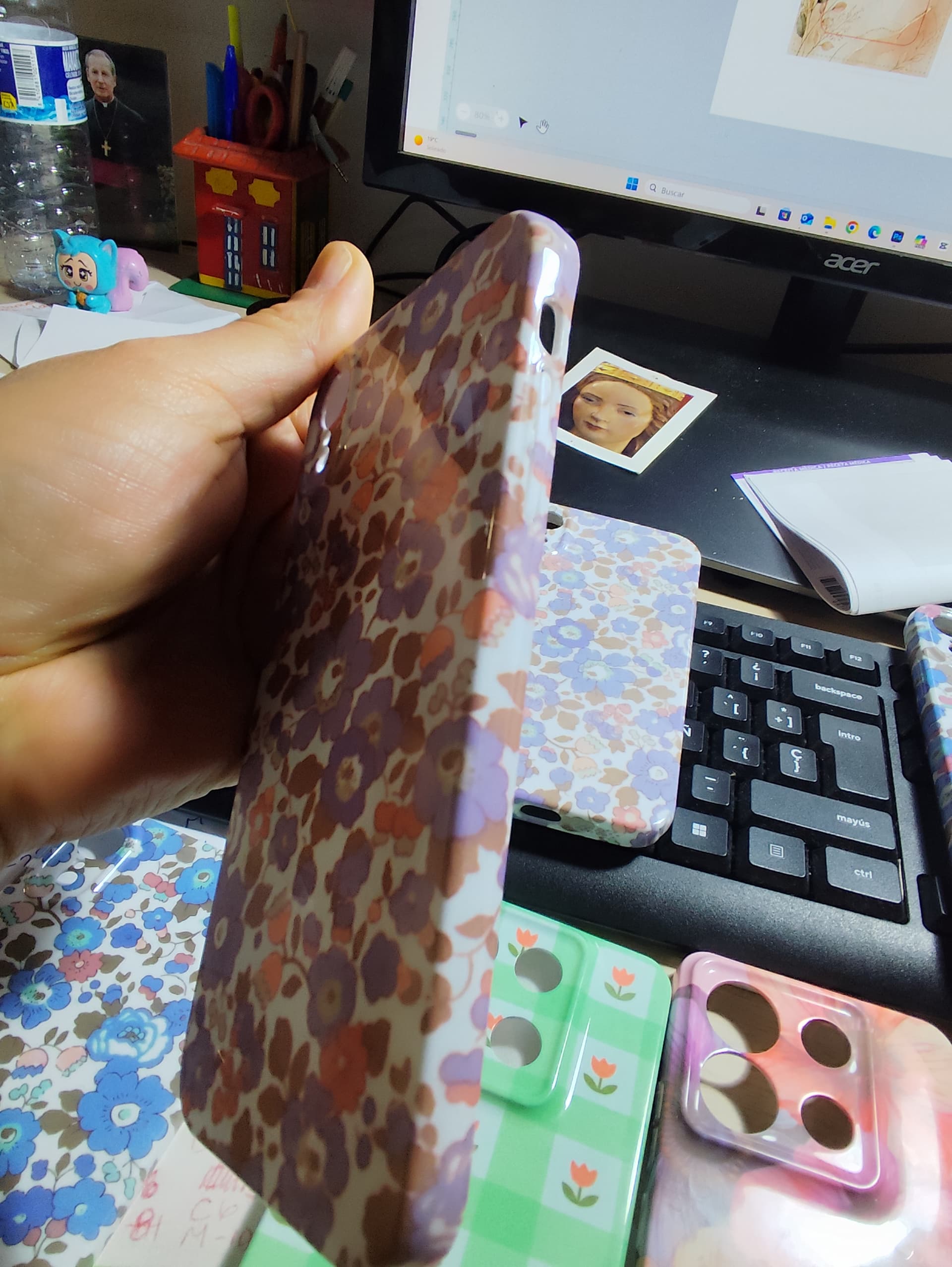

Okay, just completed my first phone case using the Htvront Phone Case press. My settings were 275°F for 306 seconds. The original and the cae are pictured. It’s not as vibrant as I thought. What went wrong?
What type of material is the phone case? It appears to be plastic. Am I assuming correctly?
For plastic cases, 275°F for 300-350 secs is recommended. Maybe, you just lifted the press too soon.
Also, did you do the initial 5-minute warmup for the machine’s fixture and the 2–10 second preheat cycle for the sublimation film during the press itself?
Did you do a hot peel or cold peel? Hot peel is recommended.
It looks really good for a first try, though! :smiley::+1:

I’ll try doing it for longer next time and increasing the temperature. I did do the 5 minute warmup. Thanks!

Color can sometimes be affected by a few different factors, such as temperature, pressing time, and also the printing settings used for the design.
