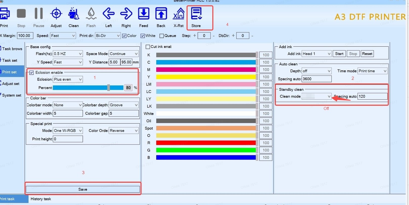

Hi there, you can try the following steps:
  1. Check whether the nozzle check is normal.
  2. Increase the Eclosion percentage to around 80% to 90%.
If the issue still cannot be resolved after trying the above, please contact support@htvront.com and note that you have already completed these steps :slightly_smiling_face:
Please let us know if you got it working :blush:
