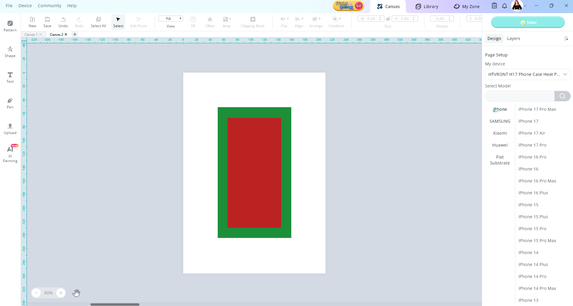

You could measure the phone case length and width. Then in design space select shape and click on square. Size the square using your measurements (thats the red square) then create another shape and make that 2cm bigger on all sides as the red rectangle. This will create a template to use.
