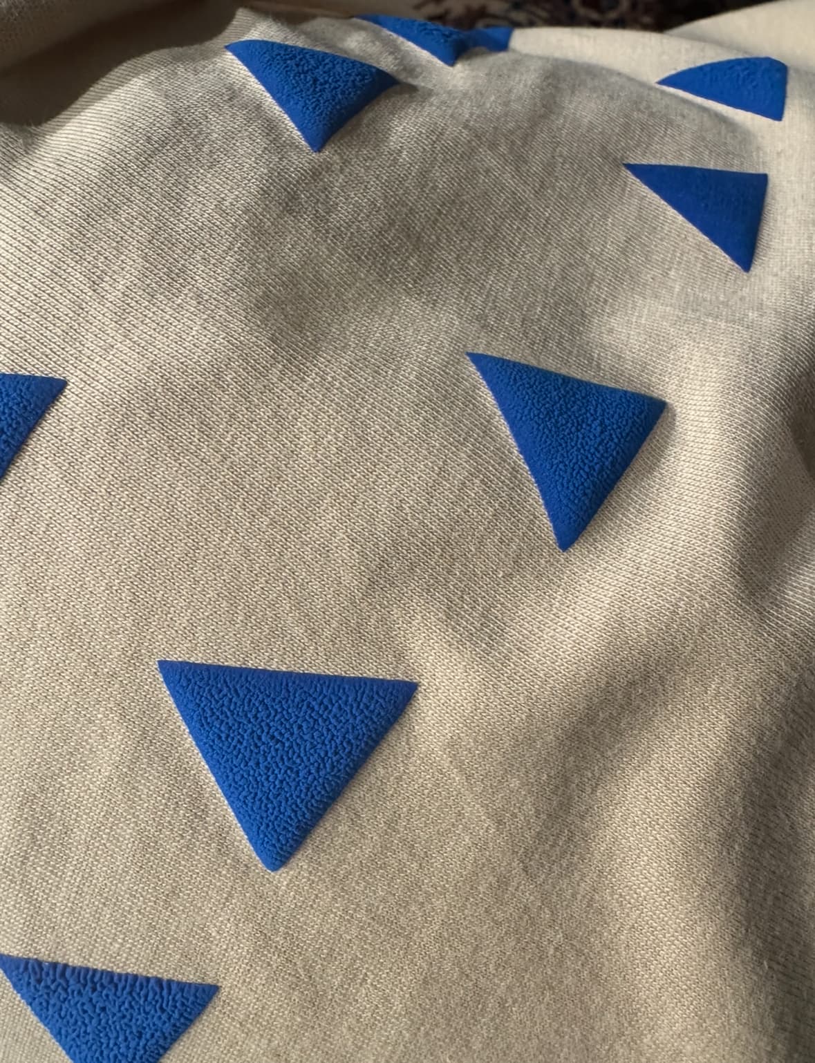

I hope ypu can help me. I have tried for so long to get the puff to look good, but it never does. It always ends up brainy or not puffy :frowning:
I have tried what feels like every option from 120-135 degrees celcius, 3-12 seconds, 20-80 kg.
Now I am wondering if i can remove the mat on Loklik to make the press more firm. But don’t know if i will ruin the machine.
Or do you have any suggestions??

I am using Siser Puff, and yes I pre-pressed it. I found out (after 1000 of try and errors) that it was all about the pressure. The more pressure the better! I ended up using wood beneath the shirt instead of the soft mat from Loklik heatpress. Ended up perfect <3
