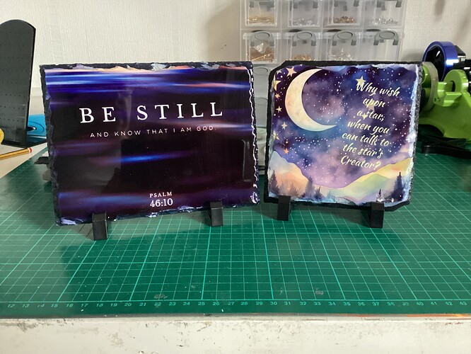

Thankyou!!! My photo slates are turning out beautifully now! I would love to send a photo, but havent figured out how to do so.
Thankyou - problem now solved - blessings
Wow they turned amazing not only beautiful :tada::tada::tada::heart_eyes::heart_eyes::heart_eyes:
This is wonderful! I feel so glad for you. Your sublimation turn out gorgeous!
They look great
