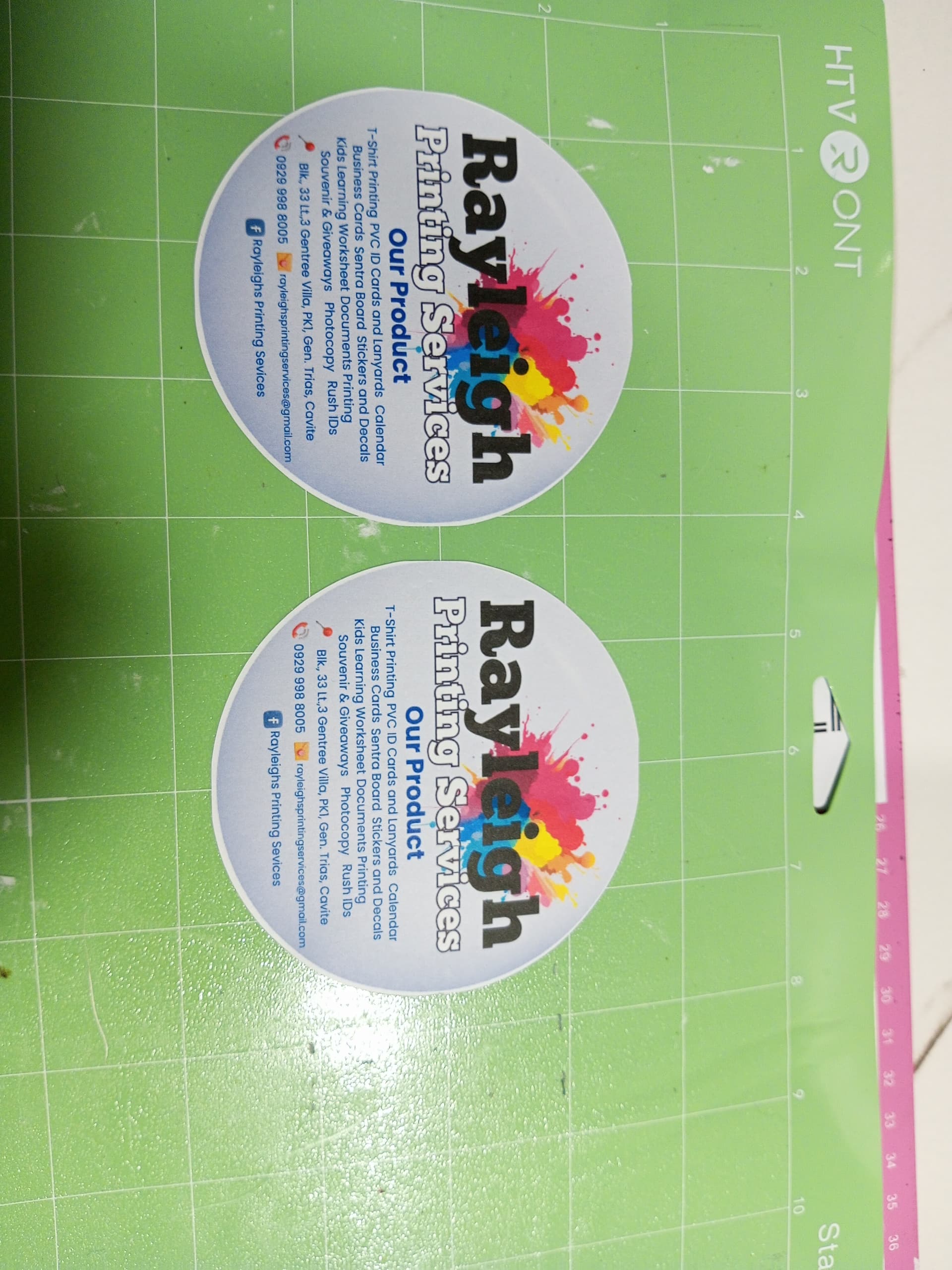

I am using icraft 6 months but still the print and cut function is not accurate. I already lost client because of uneven cuts and measurement
✓ software is updated to V6
✓Calibrate always before cutting
✓lights is on not dim
✓ tried also to cut the glossy part of phototop where reg mark is printed but still there’s still white on stickers.

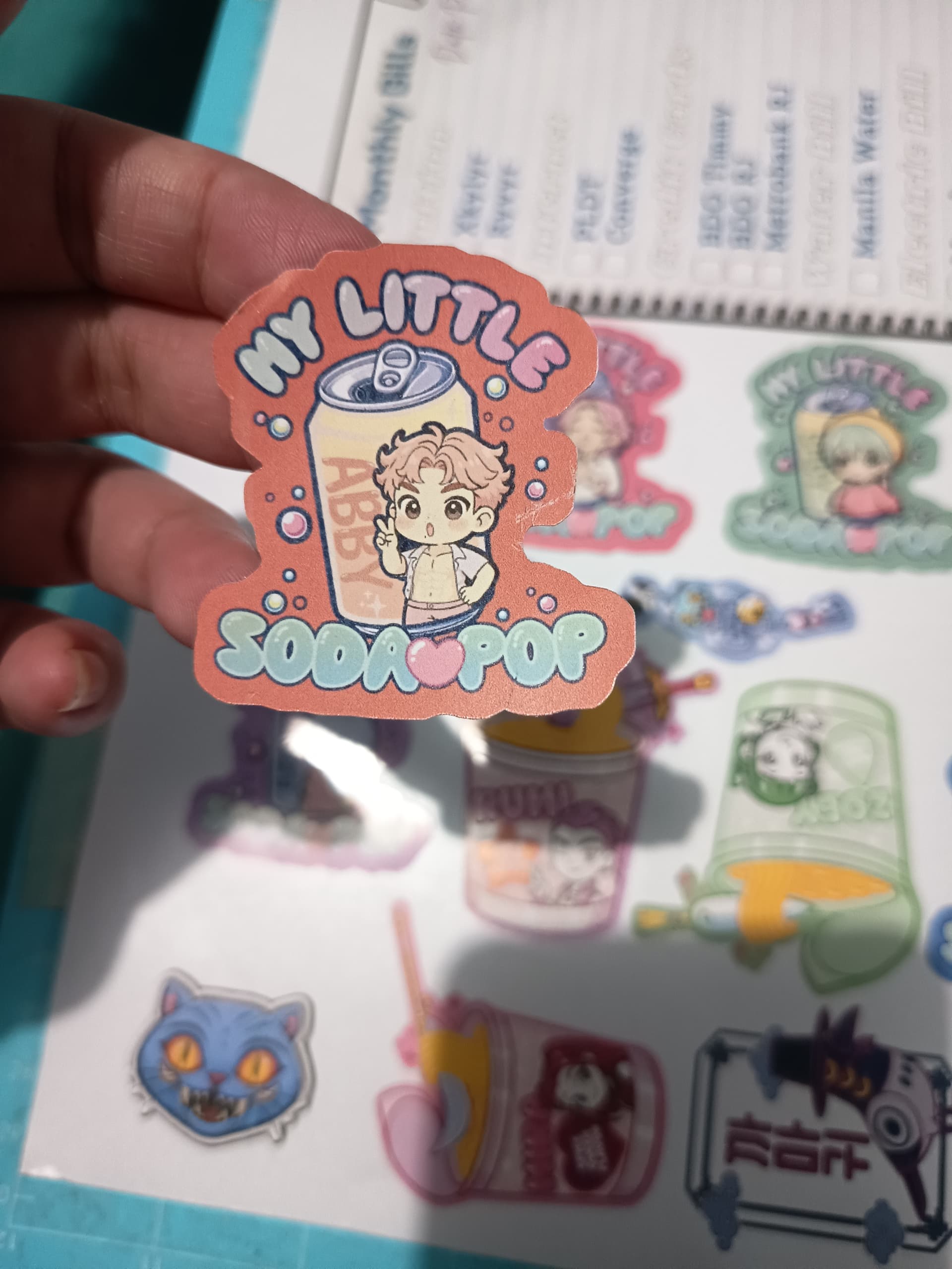

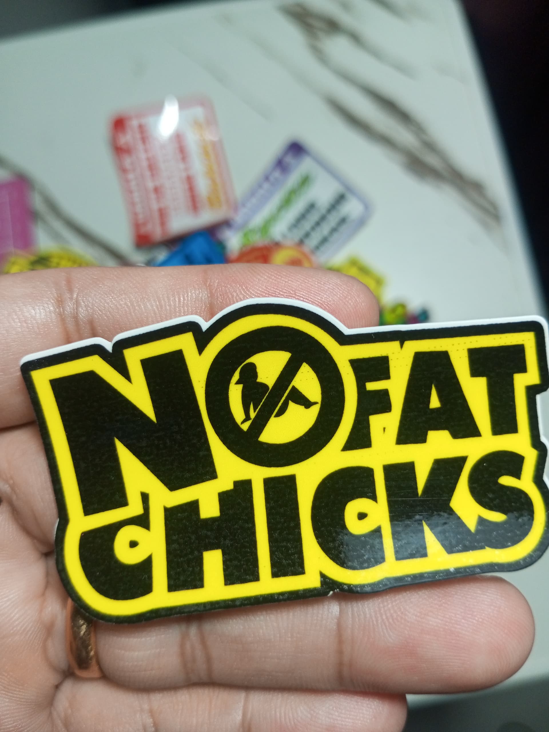

Tried different material but still, the cut is not accurate.
No phototop
With phototop
Glossy
Non glossy
Even bondpaper
I also put light on the top but outcome is still the same.

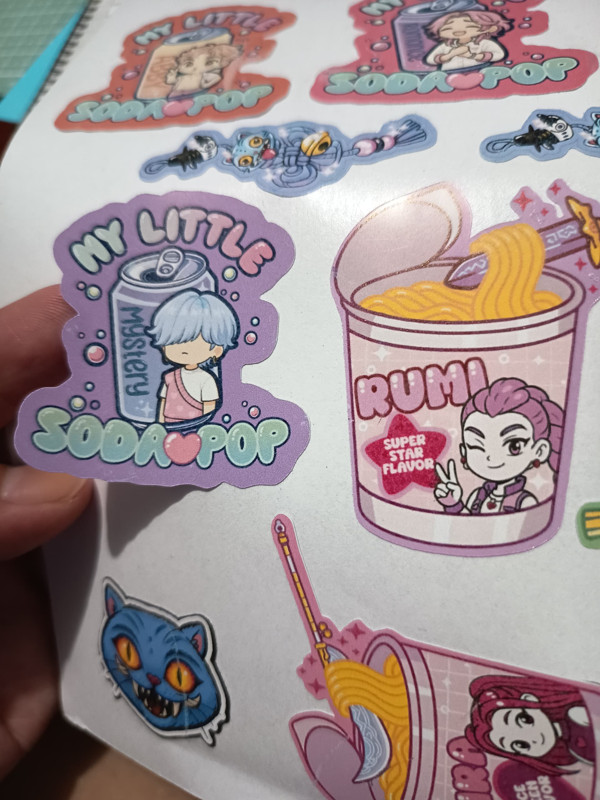

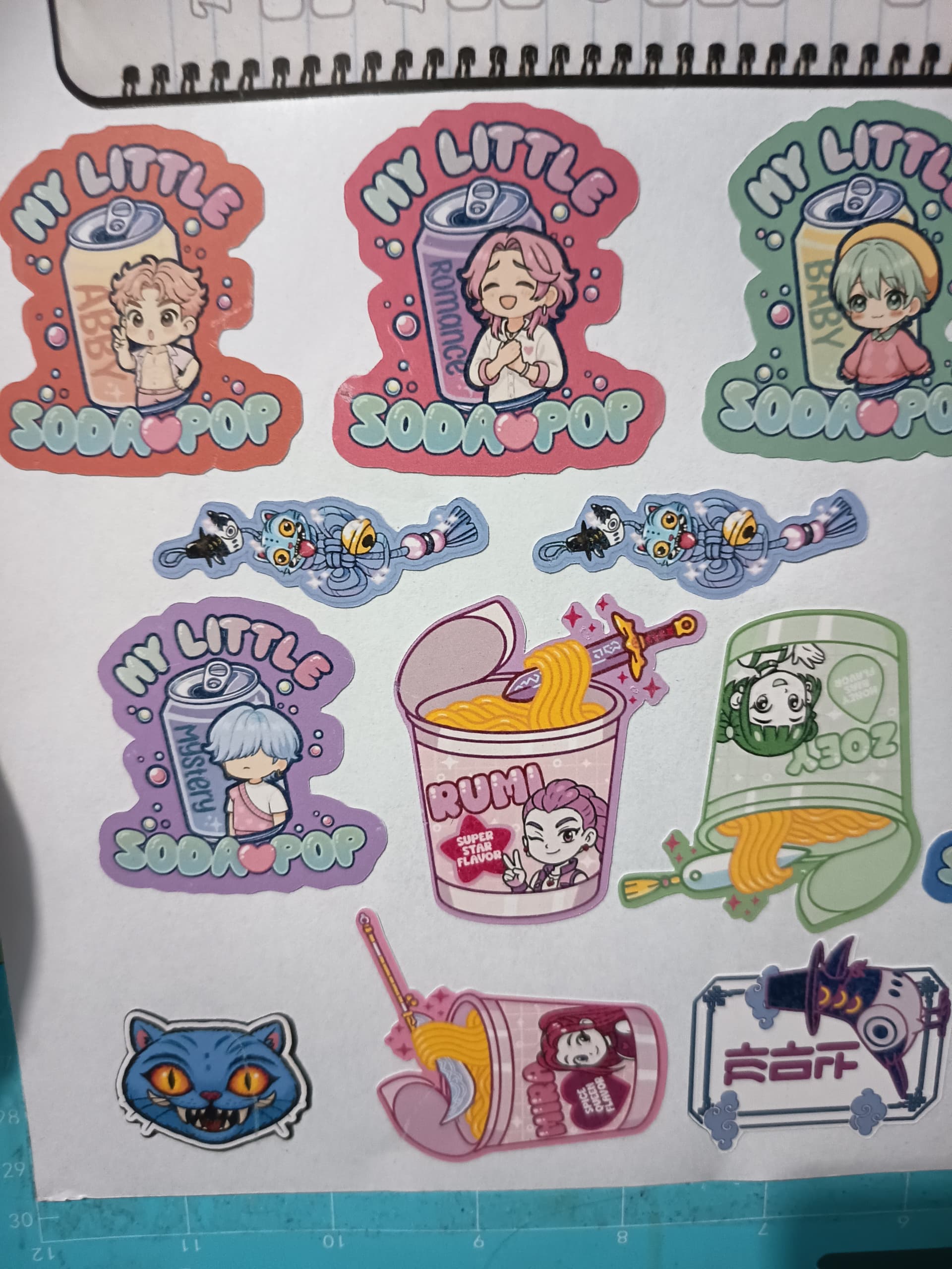

What material are you using? Just did a print and cut using glossy photo sticker and here was my result using the icraft
I dont know why my icraft is not behaving like this😅.
For circles, it’s better to use the circle shape. I noticed that the extraction of the circle contour isn’t always perfect.
Always check your contours to see if they fit neatly over your images

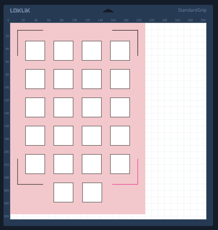

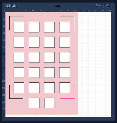

I made this calibration template back in the old days when I was learning on how to make perfect cuts. I can´t waste a cm of material so that was very important.
I performed many test until I understood all the factors apllying. With it, with only one printed sheet on regular paper, I learned all I needed, as I could select individual squares and extract different conclussions. I went nuts with it, but almost every question was answered in the process.
Some of them still remained, but they soon disappeared when I happily joined this forum and exchanged experiences and knowledge with our craft mates.
It´s been a long time now since I don´t have any issues with calibration. I never perform calibrations, the machine stays steady. Maybe once or twice I forgot to make an adjustment or was lazy to check everything. But everything is mainly internalized now, I can be done with eyes closed.
You may do something like using a similar template. You don´t need to go as crazy as I went, you don´t need to waste valuable materials, and you can share it with us with details, the solution to what is happening to you, is easy, we only need to find out where the problem is, and I don´t think it’s in the iCraft, but something you’re or you’re not doing or realizing. So please, let us help you showing us an example from calibration sheet to the given test from print to cut :slightly_smiling_face:
