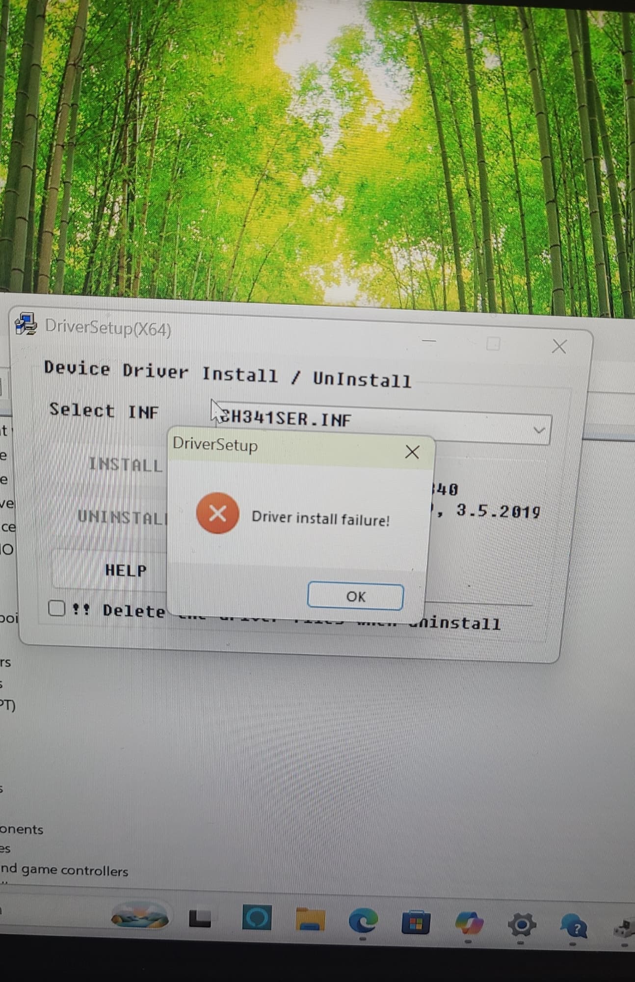

Hey Can someone please help me I am having issue setting up my iengraver…yesterday it said driver installed and I am still having issues.
Hi @Katrina_Moore that popup means the driver didn’t actually install. you may have to remove the half installed driver, and start over but I think @rinsky is the best help for you, hang tight! :+1:
Hi @Katrina_Moore! I’m so sorry you run into this issue. I just want to check in with you if you are using Mac or windows. Please follow the instructions below:
If you are using LaserGRBL
If you are connecting the iEngrave to your computer via a USB cable, you may need to manually install a driver.
The instruction manual for the iEngrave specifically states that if you cannot find the correct port when trying to connect in LaserGRBL, you should go to “Menu” > “Tools” > “Install Driver” to install it.

For any setup, make sure you properly connect the physical cables.
Connect the power adapter and the USB cable from the iEngrave to your computer. Power ON the machine by pressing the power switch. Make sure the emergency stop button and safety keys are engaged as well.
