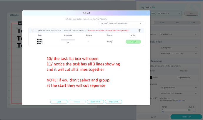

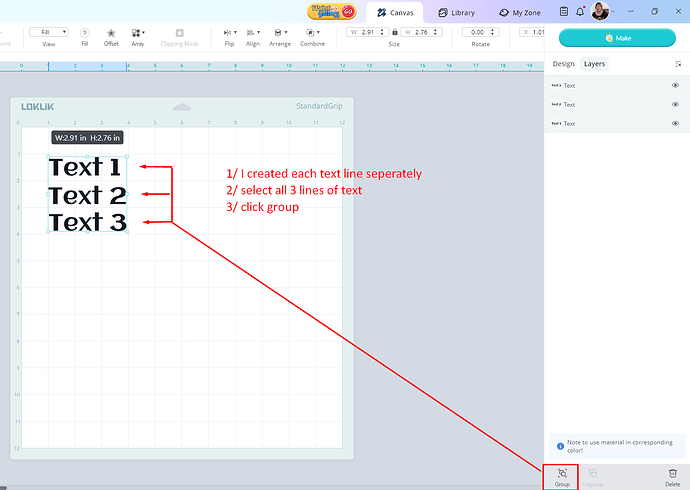

I created this demo to assist…I hope I have understood what you want to do.
Just follow the steps and it will help you get your project done! Do not get discouraged that is what this group is here for to help you out and teach you some short cuts along the way!

I will do a how to for you @Tee_Cee, please hold :grinning:
I have prepared a short video for you @Tee_Cee hopefully this is what you need, I use the iCraft not the crafter, but the LLiS should work the same with your Crafter. take your time you will get a great bulletin board in the end.
