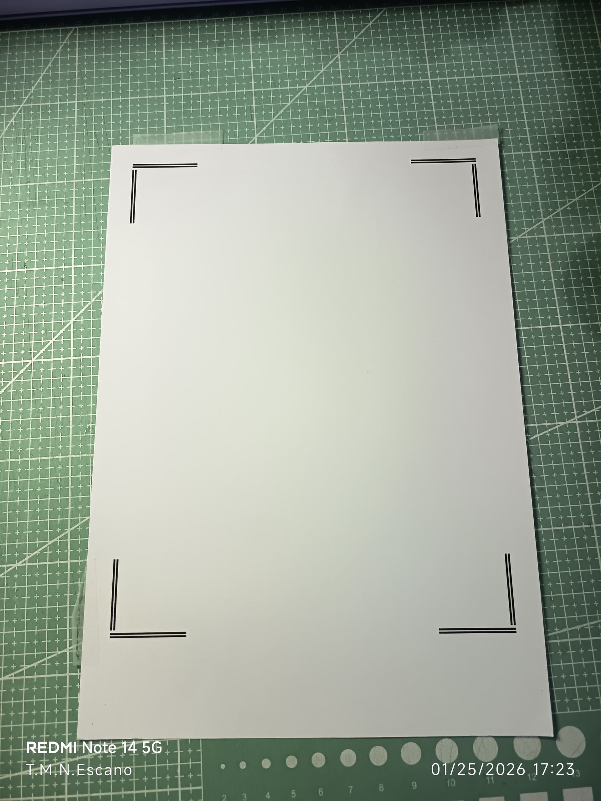

To get a registration marks template, just cut out a square — inside the registration marks — from an old printout that has the registration marks on it. Just leave the registration marks on the sheet, and use it as a cheat to make the machine think you have them on your sticker sheet.
You can print a blank registration marks sheet like this to put on top of your design. To print a sheet with only the registration marks, on a blank canvas just click on the box to view the registration marks then hit Ctrl+P.
My video hack can be seen here
Full page print and cut hack
I’m guessing this will work on a3 but you need to use a program like photoshop or affinity to layout ang print your design since only a4 and letter can be selected as paper size in Idea Studio. Make sure to use the registration marks as guide. The registration marks can be saved by hitting Ctrl+P but instead of printing immediately, you need to choose print as PDF.
I printed this on 220 gsm calling card paper so it’s more sturdy and reusable and more opaque than regular copy or bond paper
