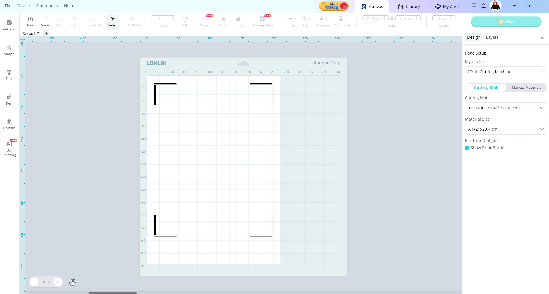

Do you select the right paper setting in Idea Studio?
Yes, I did that, but did someone say something about borderless printing? Am I supposed to change the print settings to borderless?

Did you make sure material size was A4 in Idea studio

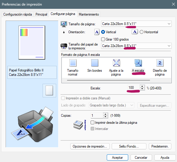

No, don´t print borderless, the printer driver scales it a bit and we’re searching for max accuracy.
That’s why I insisted, print 100% scale, is the only way you’ll be certain the registration marks print exactly as in the canvas. Even if you feed a US letter and select print on A4… doesn´t matter because you’re printing scale 1:1 (100%)

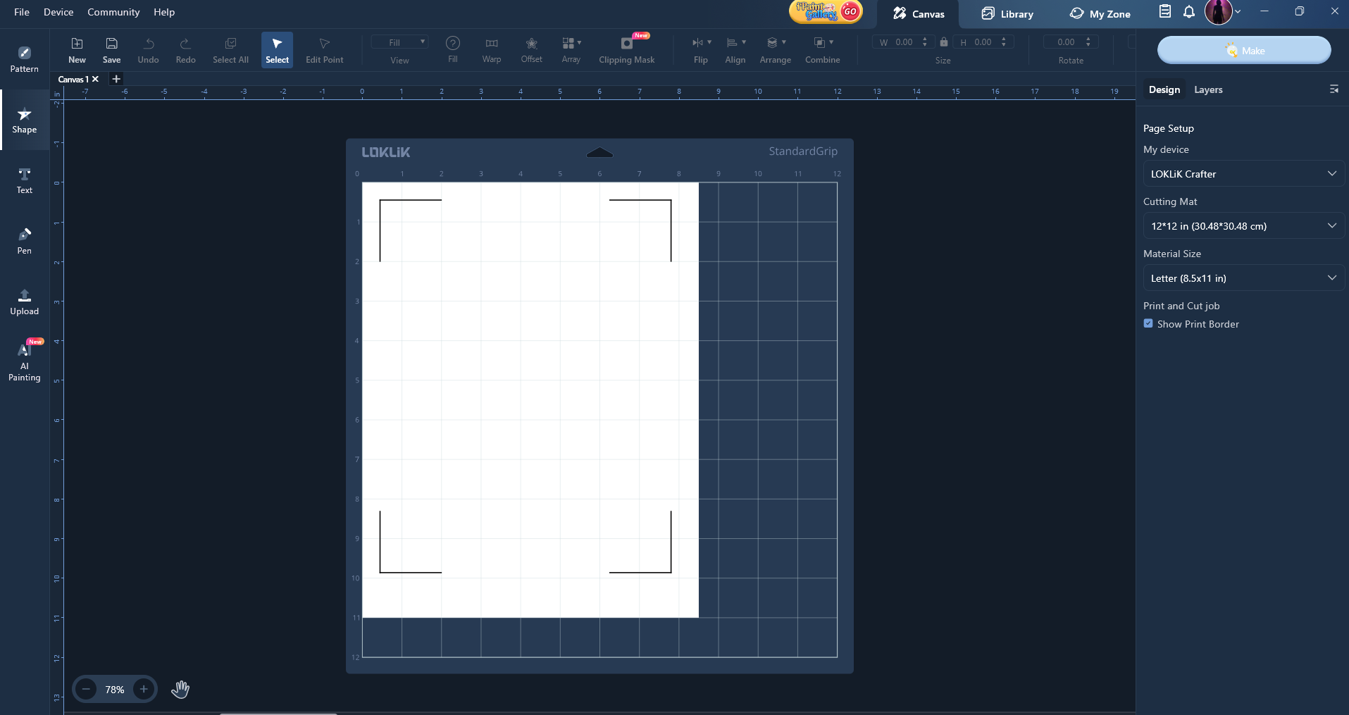

@BellethehowtoGuru she’s using US Letter, remember it can be selected in IS now
No, I had to change from A4 to US letter. My paper is 8.5 x 11. That was my problem, at least I thought. Now, after choosing the correct paper size and calibrating, my alignment is off. The PTC that I did with the mobile app was way better. Here’s the last cut I did on my computer. :point_down:t3:Microsoft OneDrive
Now, it’s not reading the marks again. So, it’s hit or miss with the computer. I’ve tried 3 times, but it fails to read. My scale is at 100%, as well.

Yeah, if it can help someone else, that’s great. As far as the print settings, though,I don’t really have many. My prompt box is way smaller than yours,l. I did try clicking borderless after not getting a reading to see if that did anything, but it didn’t lol. I just have that and print quality. I’ve tried standard and high quality. So, idk what else it could be, as far as the print goes. :woman_shrugging:t3: I was wondering about the calibration being done for each device, as well, so thanks for clearing that up, too. :heart:
