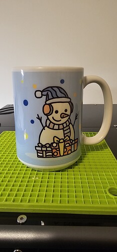

I wanted to make a Christmas Mug but wanted to use colors outside of the normal red and green colors. I felt this would be a fun cup. I found the snowman and duplicated it. I then went to the pattern and drew a rectangle and resized it for my cup and changed the color to blue.

Such a cute snowman
Thank you so much.
Beautiful mug! Very well done! I love the snowman! :heart: I see that you have those connecting lines in the name. They happen in every script font, even if you save an SVG from Canva, and bring it to the IdeaStudio. If you’d like to remove those, next time, you can select the word or phrase and use the Combine tool to Unite at Overlap. If that one doesn’t work, try the Subtract Crossover. It will connect your letters and you won’t have the cut marks in your letters. You can always check to see if the intersecting lines are there by using the Contour mode in the View panel.

Thank you so much. I was wondering what happened there.

You’re very welcome. :heart: I’m happy to help! I know when I first started with my Loklik machine, I had the same issue. I thought you’d probably wondered what that was all about, just as I did. :joy: Now, you can make your projects without those annoying little lines cutting into your letters. Can’t wait to see your future projects! :hugs:
