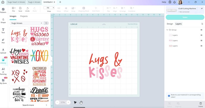

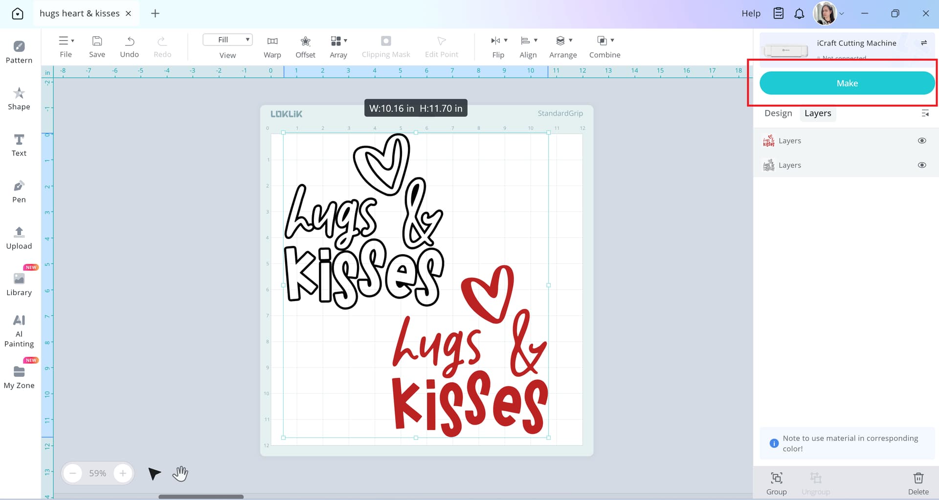

STEP 1 - Prepare and cut your design from IdeaStudio App.
  • Open IdeaStudio and on your canvas, click the Library tab on the left. In the “Images” section, type in any keyword you’d like. For this tutorial, I searched for “hugs & kisses” by Jordyn Griffin—a cute Valentine‑themed design that I thought would be perfect for my daughter’s shirt. Once you find the design you want, add it to your canvas.

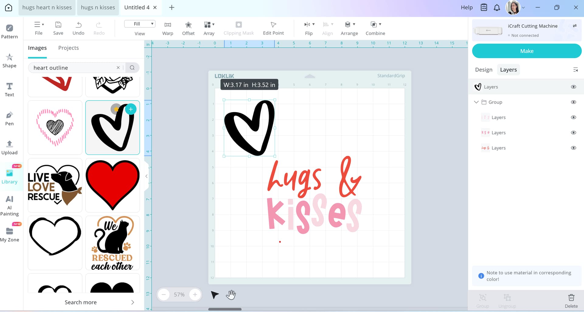

  • Then I felt the design needed a little something extra, so I searched the library for a heart design and added it to the canvas.
  • Resize the heart and place it exactly where you want it on your design. Adjust the color, then select “Unite” under the “Combine” menu, as shown below:
  • With the image still selected, click the Offset button and create your offset layer by clicking the “Apply” button.
  • Then, select the two layers and click the “Slice” feature under the “Combine” menu.
  • Finally, send all the layers to your cutting machine by clicking the “Make” button. For my project, I used black glitter HTV for the offset and red puff HTV for the main design.

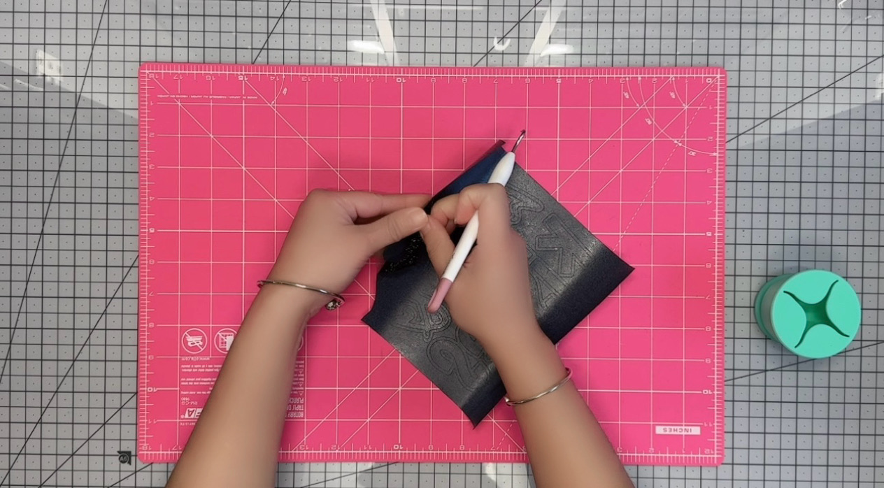

  • After cutting your vinyl, take your time weeding the black glitter HTV. It’s more brittle than other HTV types, so handle it gently—especially when working with intricate designs.

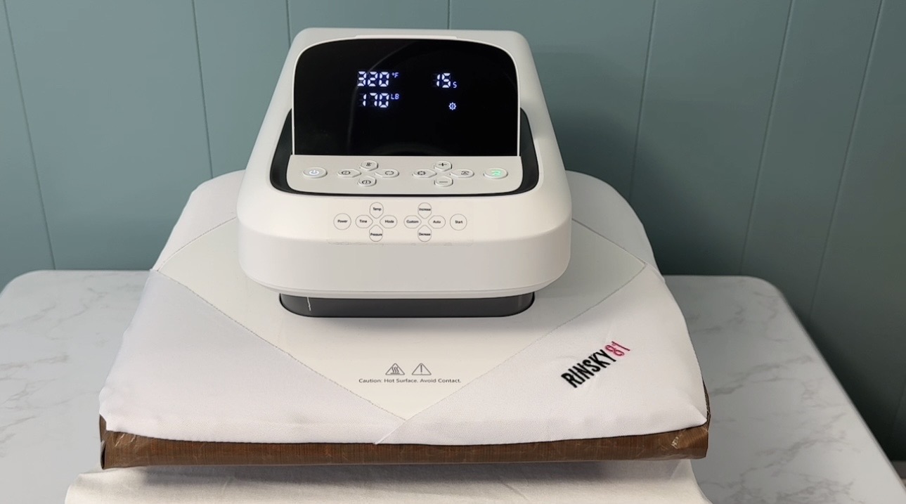

  • After you finish weeding, set the design aside and preheat your HTVRONT Auto Heat Press 2 using the recommended glitter HTV settings at 320 F for 15 seconds with 170 pounds of pressure.

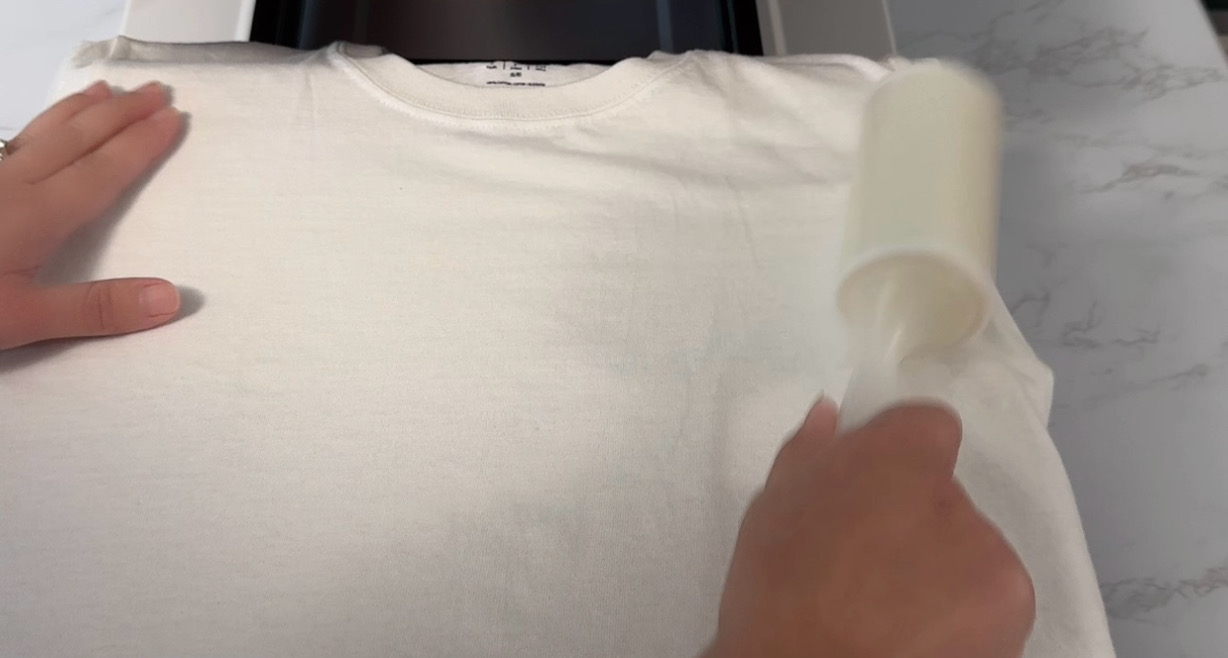

  • While the press is heating up, lay your T‑shirt flat and run a lint roller over it to remove any dust or stray fibers.

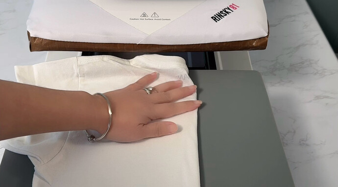

  • Once the heat press reaches the correct temperature, pre‑press the T‑shirt for 10 seconds to remove any moisture trapped in the fabric.
  • Find the middle and fold the shirt lengthwise and run the heat press for 5 seconds.

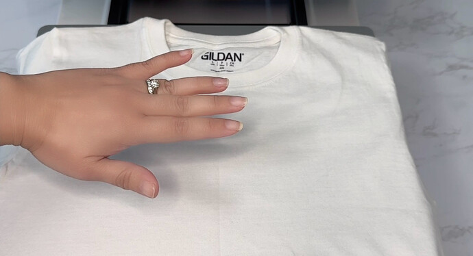

  • Center your design using a T‑shirt guide ruler or place it about three fingers below the neckline for proper positioning. Grab some heat resistant tapes and secure it in place.
  • Once the temperature reached to 320 F, press as directed. NOTES: I skipped adding a Teflon sheet on top of the design because I already have a Teflon cover attached to my heat plate. Glitter HTV is a cold peel.

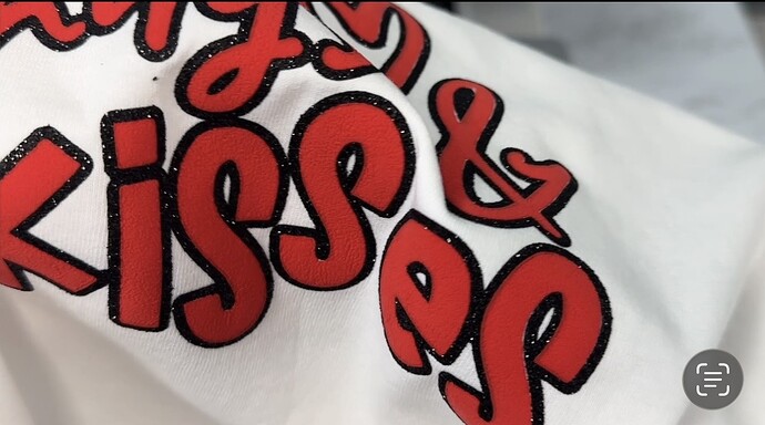

STEP 4. Puff HTV Application.

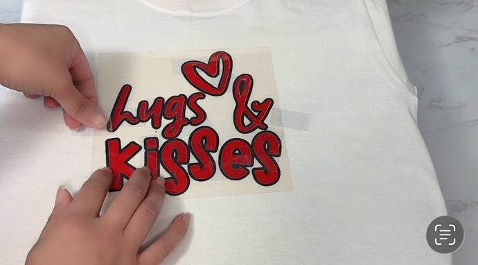

  • Lower the heat setting for the puff HTV to 280°F and press for 10 seconds, keeping the pressure at 170 pounds.

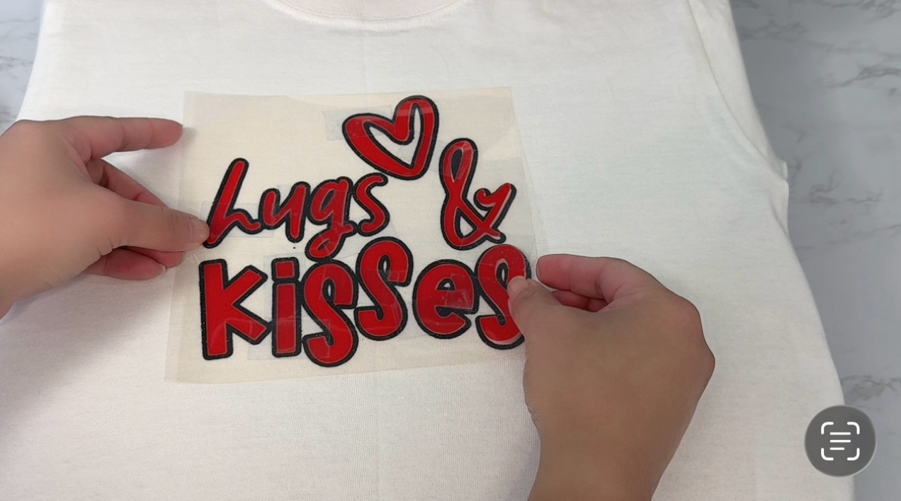

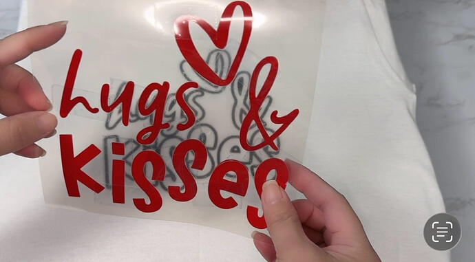

  • Position your puff HTV design inside the glitter HTV outline, making sure everything lines up cleanly. Once aligned, secure it in place with a few pieces of heat-resistant tape.

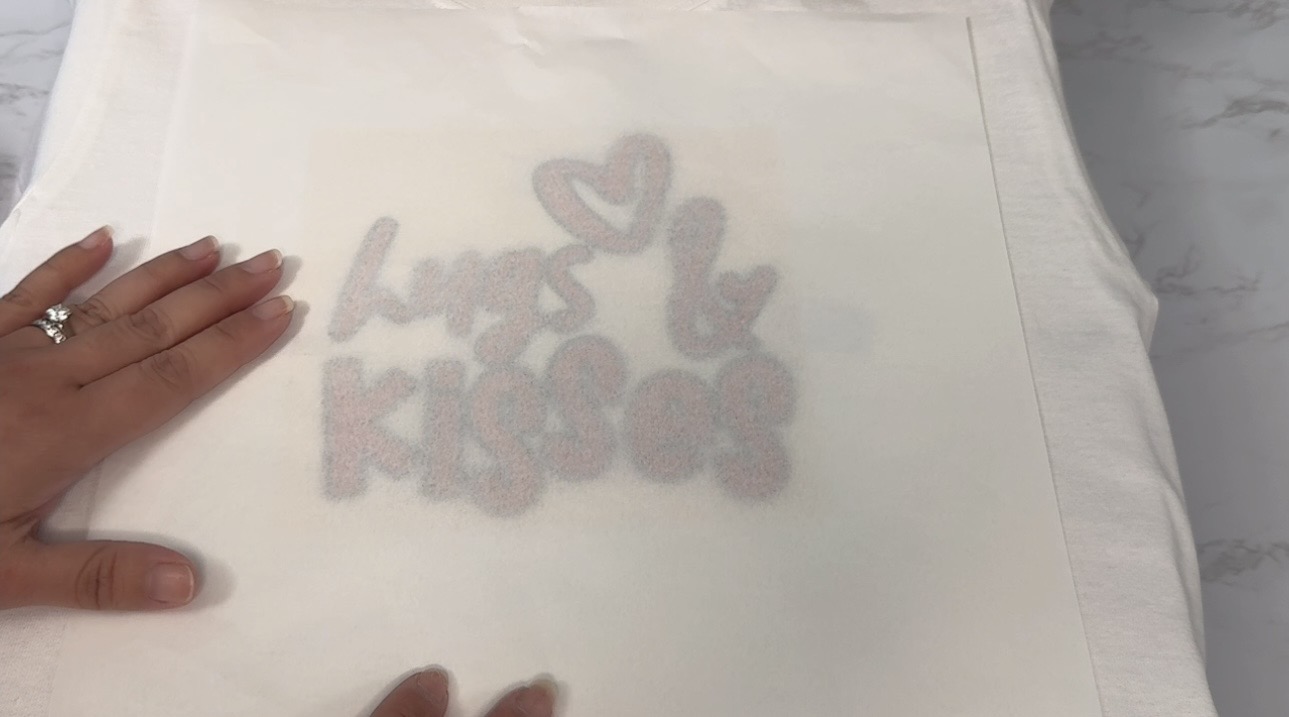

  • Once everything is in place, lay a sheet of butcher paper over the design and press as directed. Puff HTV is a hot peel, so remove the carrier while it’s still warm.

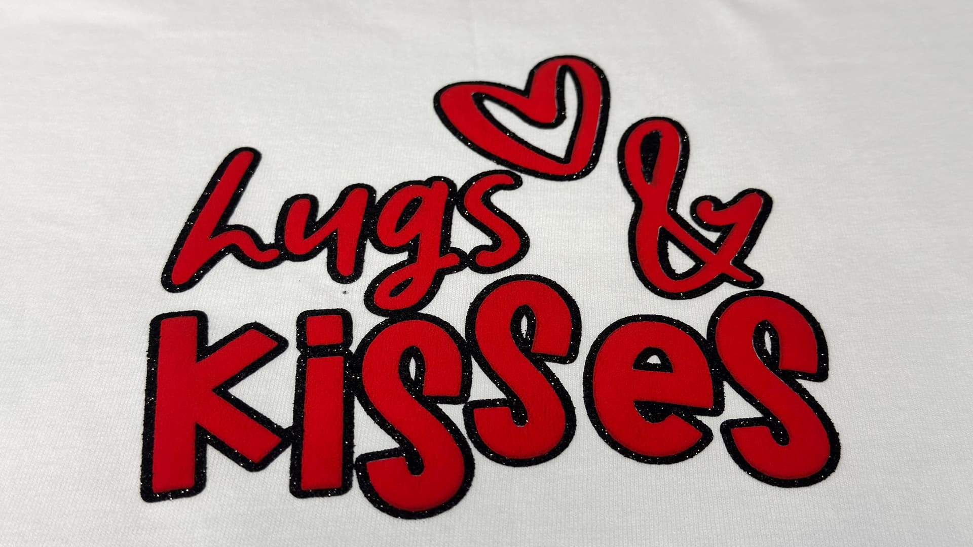

STEP 5. Show it off, enjoy!
Now you’ve got an adorable Valentine’s T‑shirt with the perfect quote for a young teen. I’m so excited to give this to my daughter on Valentine’s Day!
TIPS & TRICKS:

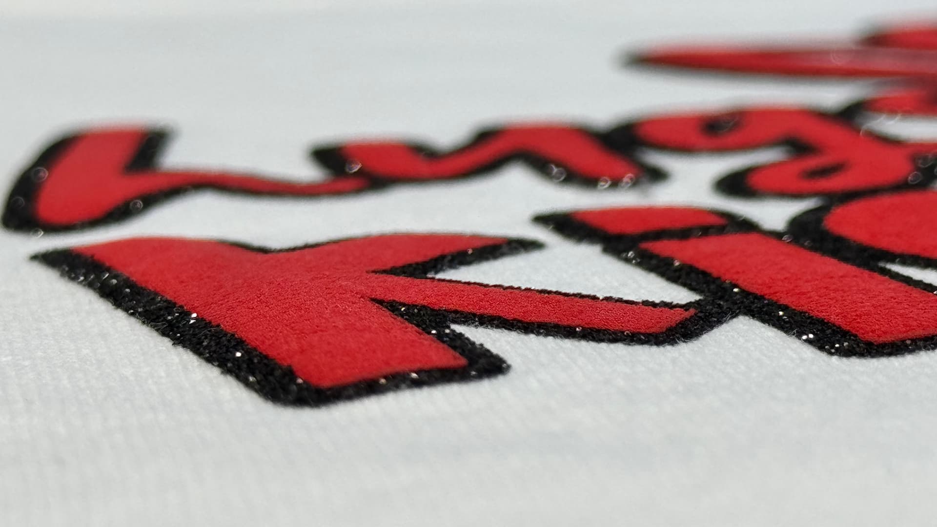

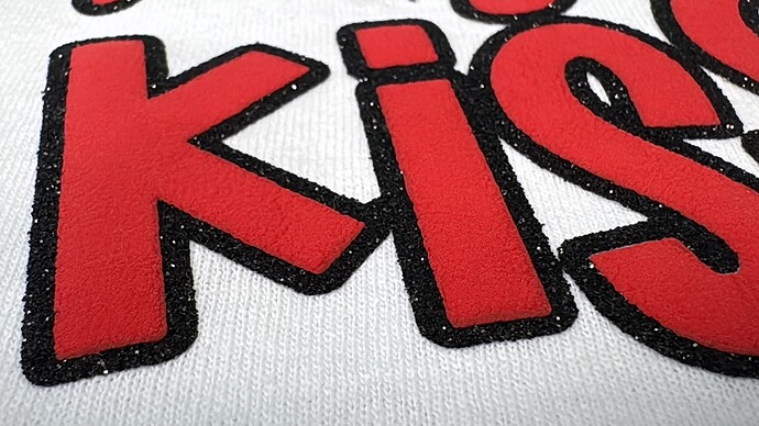

  • Always test your materials and heat settings before committing to the final press so you don’t waste both “good” t-shirt and vinyl. High pressure is essential for getting puff HTV to rise properly, as long as the temperature and time are dialed in.
  • Using a firm—or even firmer—pressing mat also helps you achieve consistent pressure. The goal is a smooth finish with a clean, visible puff. These were my best results after experimenting with different time and temperature combinations.
