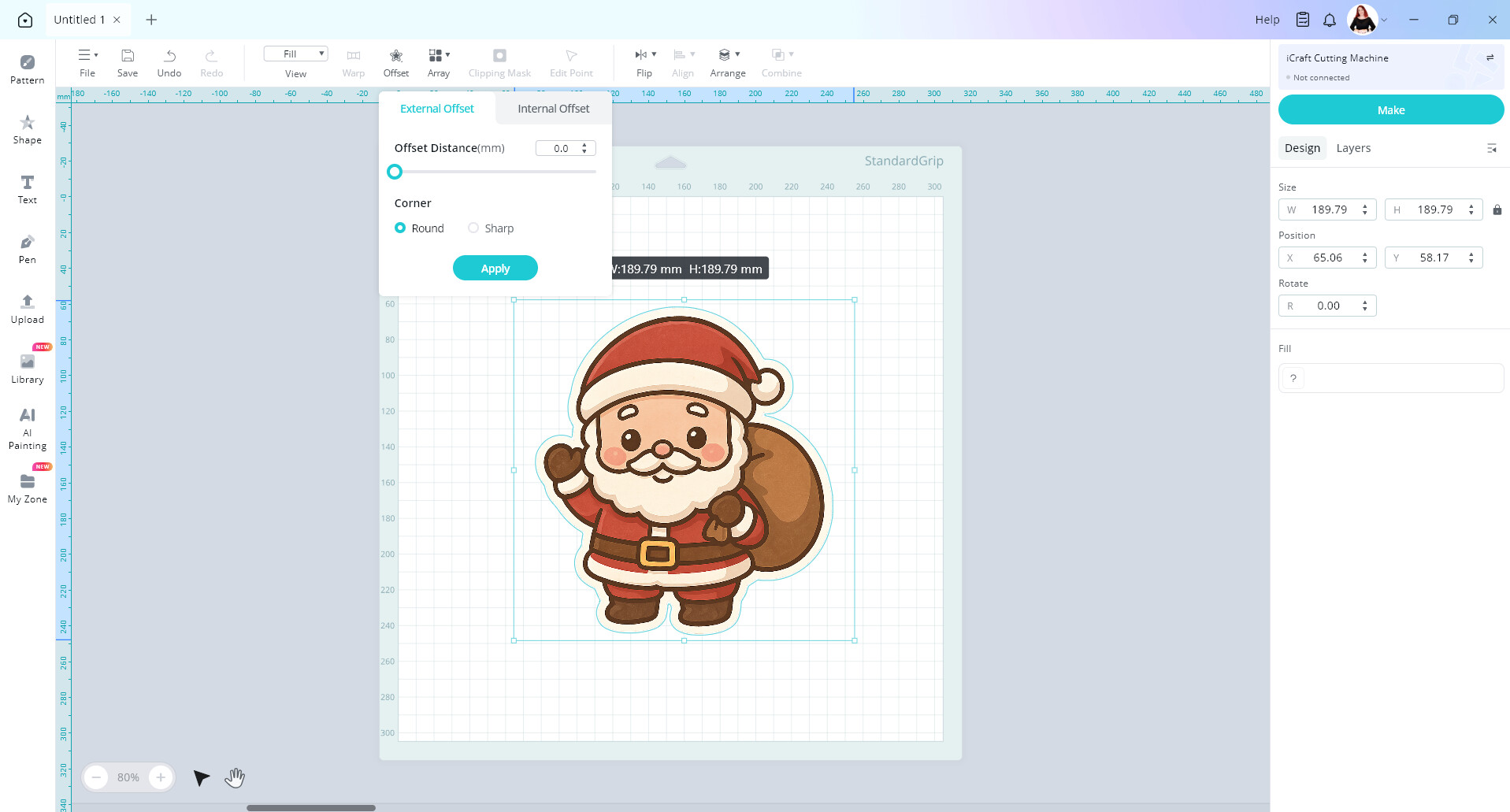

A work around for those that are having trouble with this is creating an offset of your image that you want cut out.

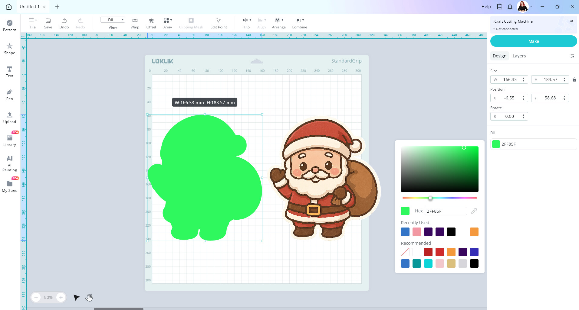

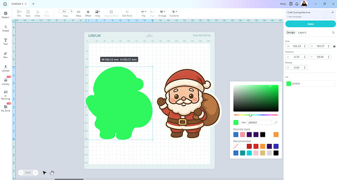

This can be slightly bigger or the same size as your image. Make the offset a colour that doesn’t appear in any of your images. So maybe lime green or something.

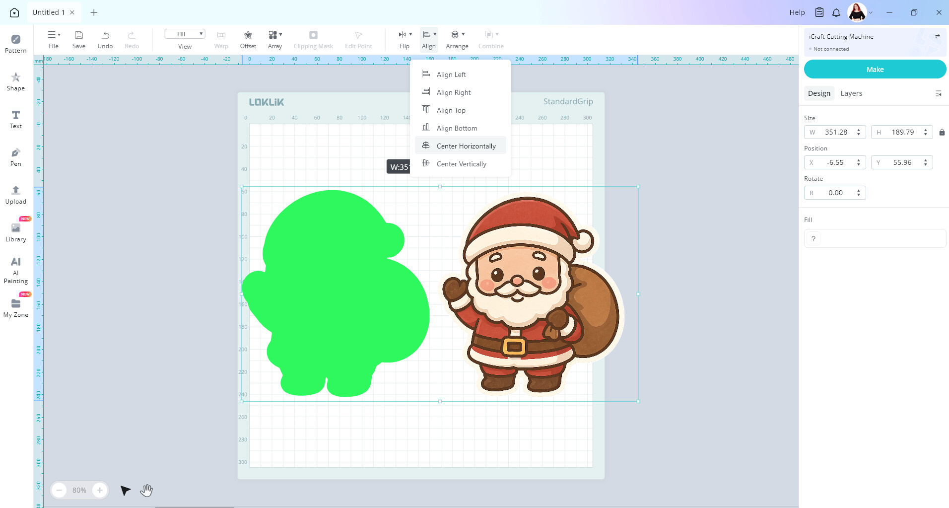

Now make sure to align center horizontally and vertically behind your image.

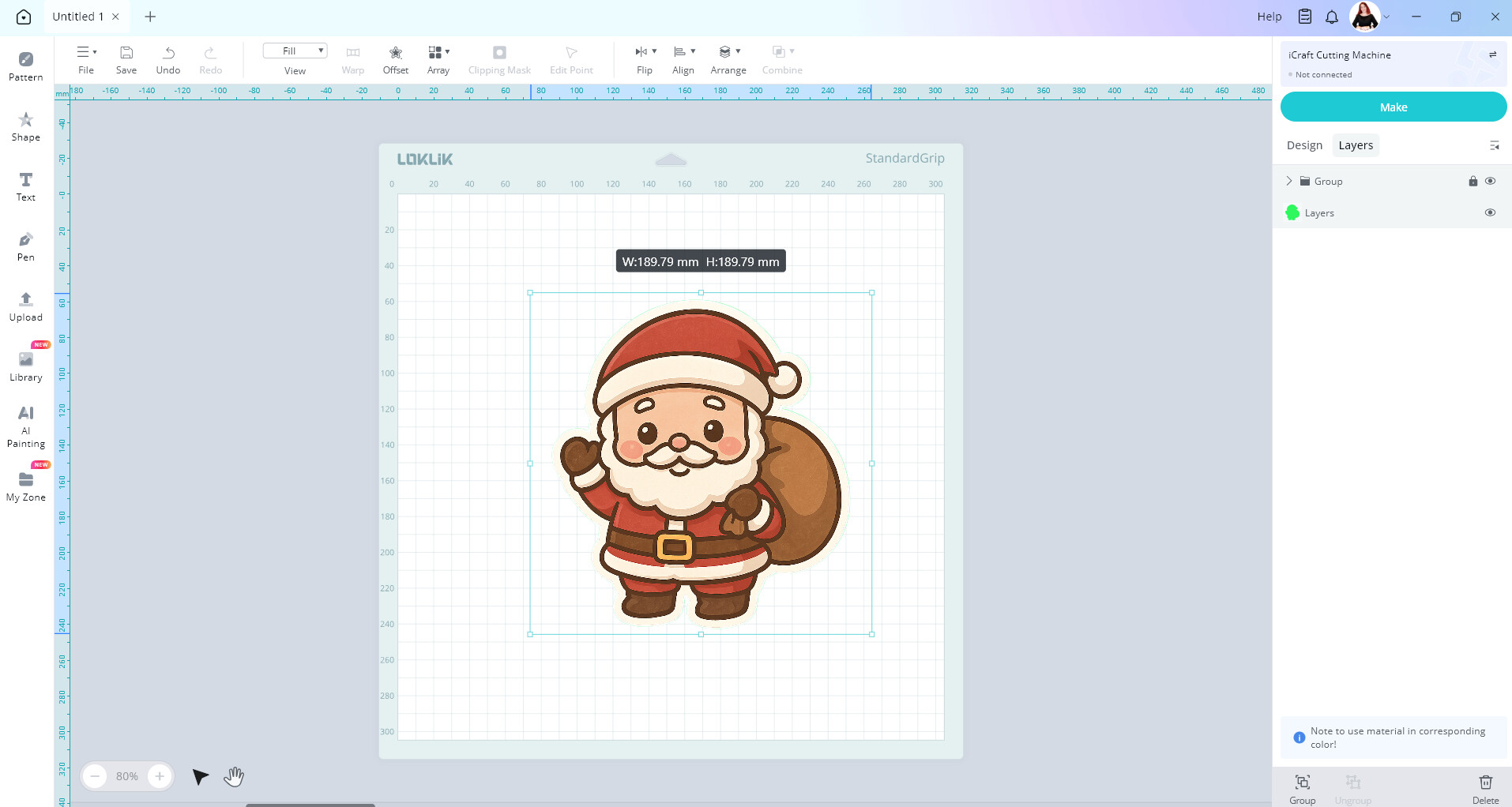

Now you can group these images together using the group tool. This will keep them aligned and move together as one piece.
When you go to print then cut. Print out your sheet as normal. Then select the offset layer, in our case it’s the lime green group. Then your stickers will cut out and won’t have any unwanted cuts anywhere.
