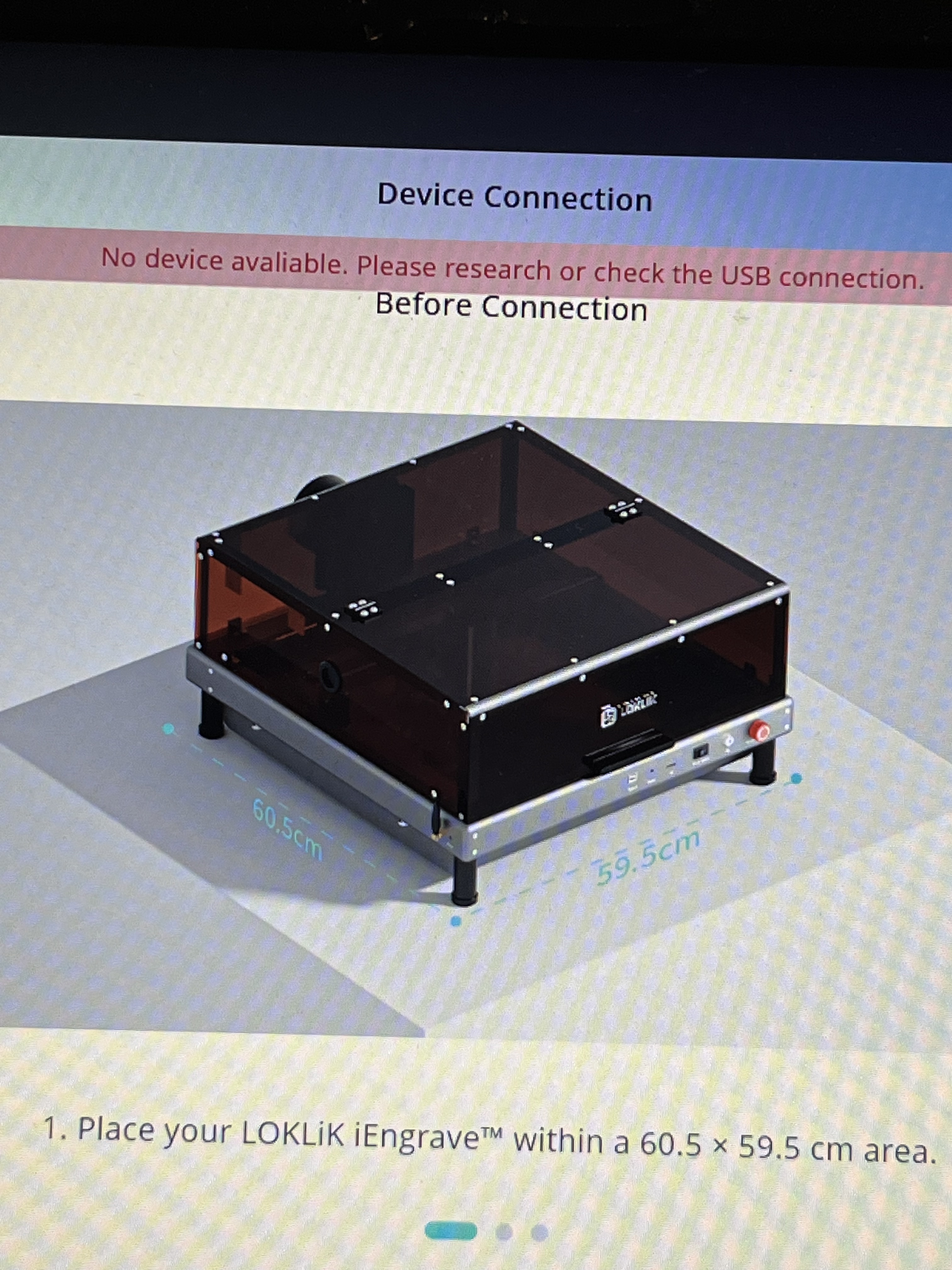

Hi everybody, so I’ve been using my Iengrave before Christmas with no problem. yesterday when I went to use my iron engrave and connect it to my printer to make a dog tag, it’s now telling me that it can’t connect to my USB.
“ No device avaliable. Please research or check the USB connection.”
Can somebody please help me fix this problem?
I have tried uninstalling and reinstalling the software. I have tried turning it off and turning it back on after a minute I have tried taking off the Wi-Fi adapter on the side and re-putting that in. I have rebooted my laptop numerous times. And it still will not connect to my engraver. I have attached a picture of my problem.

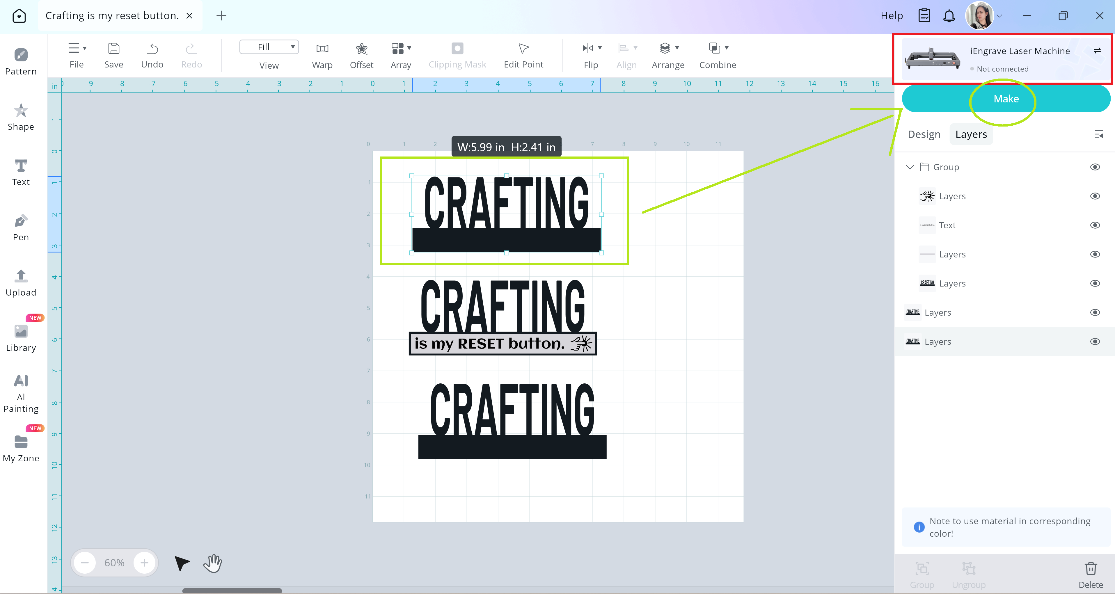

Hi and welcome to the community @handmadebykathy1! I’m sorry you’re running into this issue. From my experience as a user, this is actually pretty common. When the iEngrave isn’t used for a while, it tends to go into a “sleep” state, which can look like a connection problem. In situations like this, you usually don’t need to uninstall or reinstall the driver. You just need to reconnect the machine the same way you did the very first time — this applies to mobile users as well.
I also want to thank @Nat_Wen and @Samantha_Bryant for jumping in with support.
Now, let’s walk through some steps to get your iEngrave talking to your computer again. Since you’ve already reinstalled the driver correctly, here’s the process I personally follow (and I even powered mine on this morning to double‑check these steps for you):
Start fresh: turn on your computer first, but don’t plug in the USB cable yet.

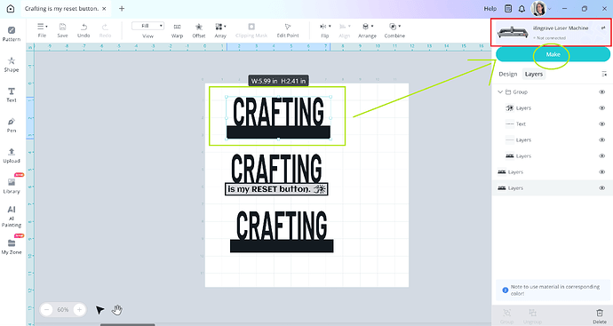

• Open the LOKLiK desktop app and add a text object as shown below. You’ll notice my iEngrave still isn’t connected at this point. Highlight the text and click Make.

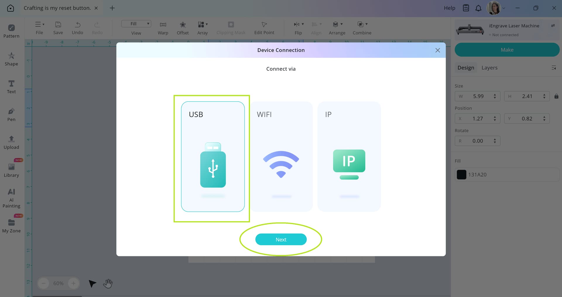

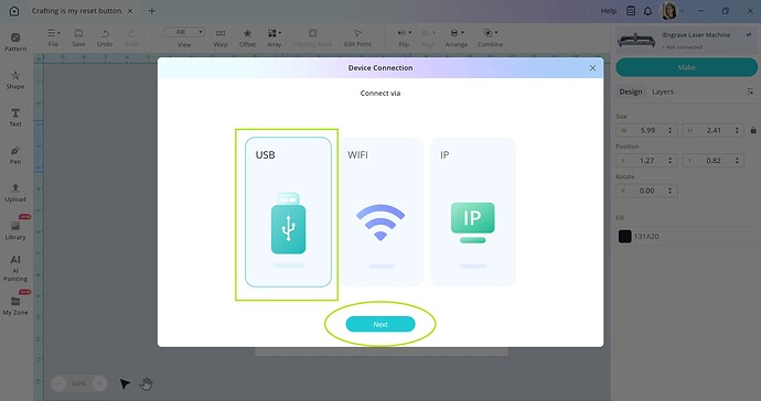

• On the next screen, you’ll see the available connection types. At this point, power ON your laser — make sure the power switch is on, the safety keys & SD card are inserted, and the emergency stop is released.
Once the machine is fully on, connect your USB cable to both the laser and your computer. Select USB from the options, then click Next as shown below:

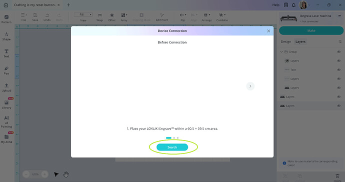

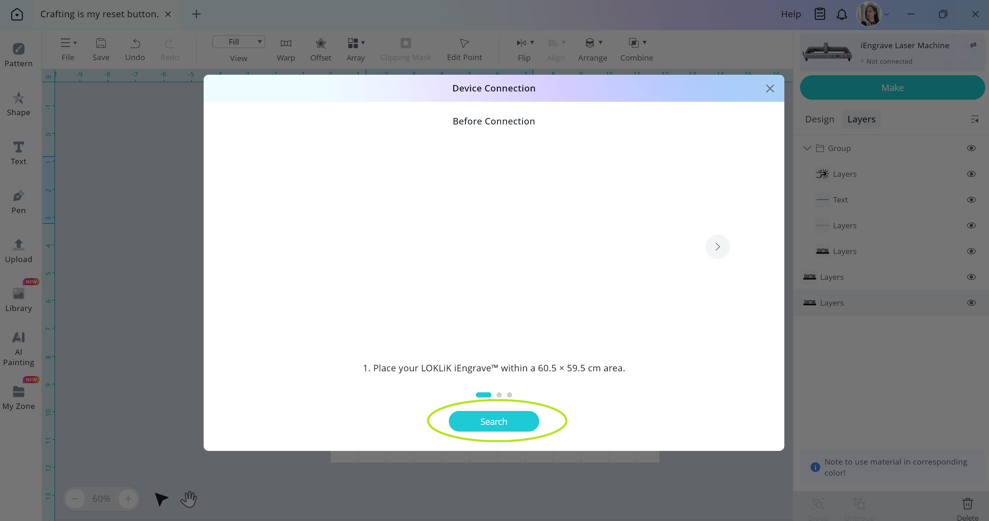

• Do not worry about the screen, take some time to connect through USB cable:

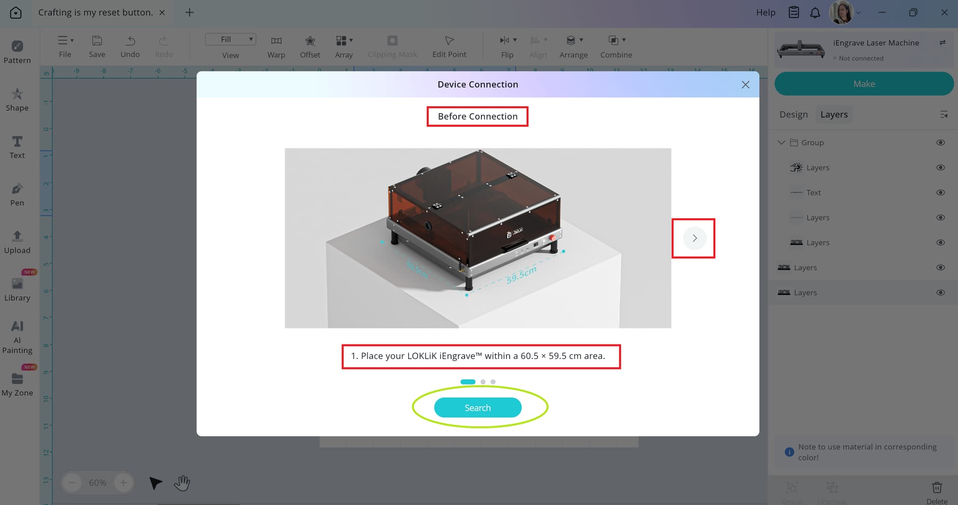

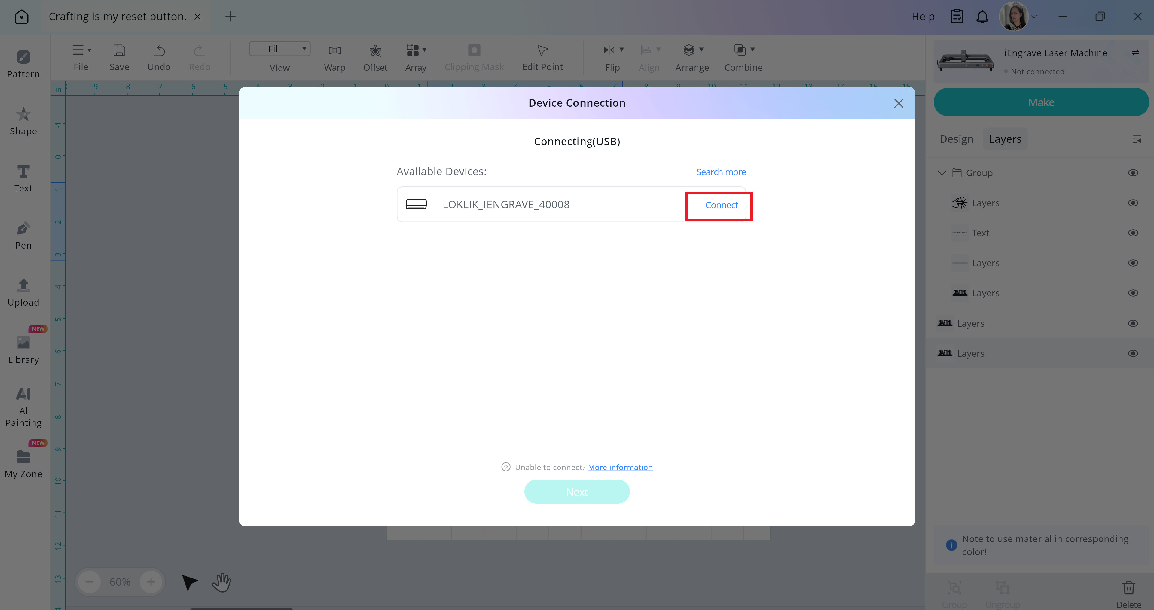

• Before connecting, use the arrows to review each requirement and confirm everything is met. Once all items are checked, click the Search button as shown below:

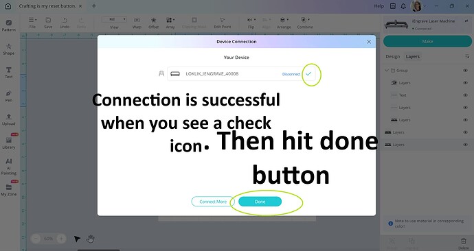

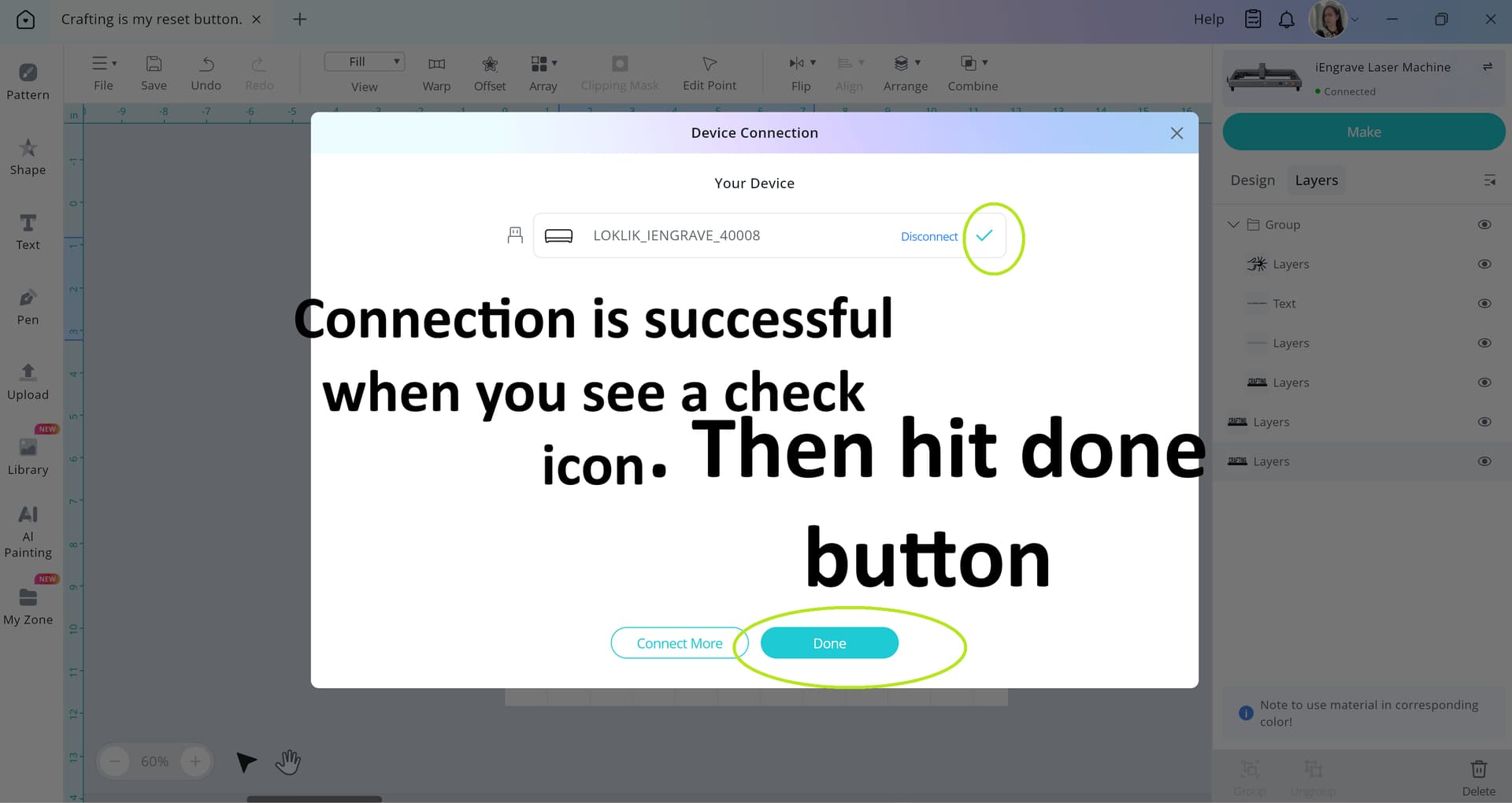

• Then you’ll see it in your screen that your iEngrave is active then hit the connect:

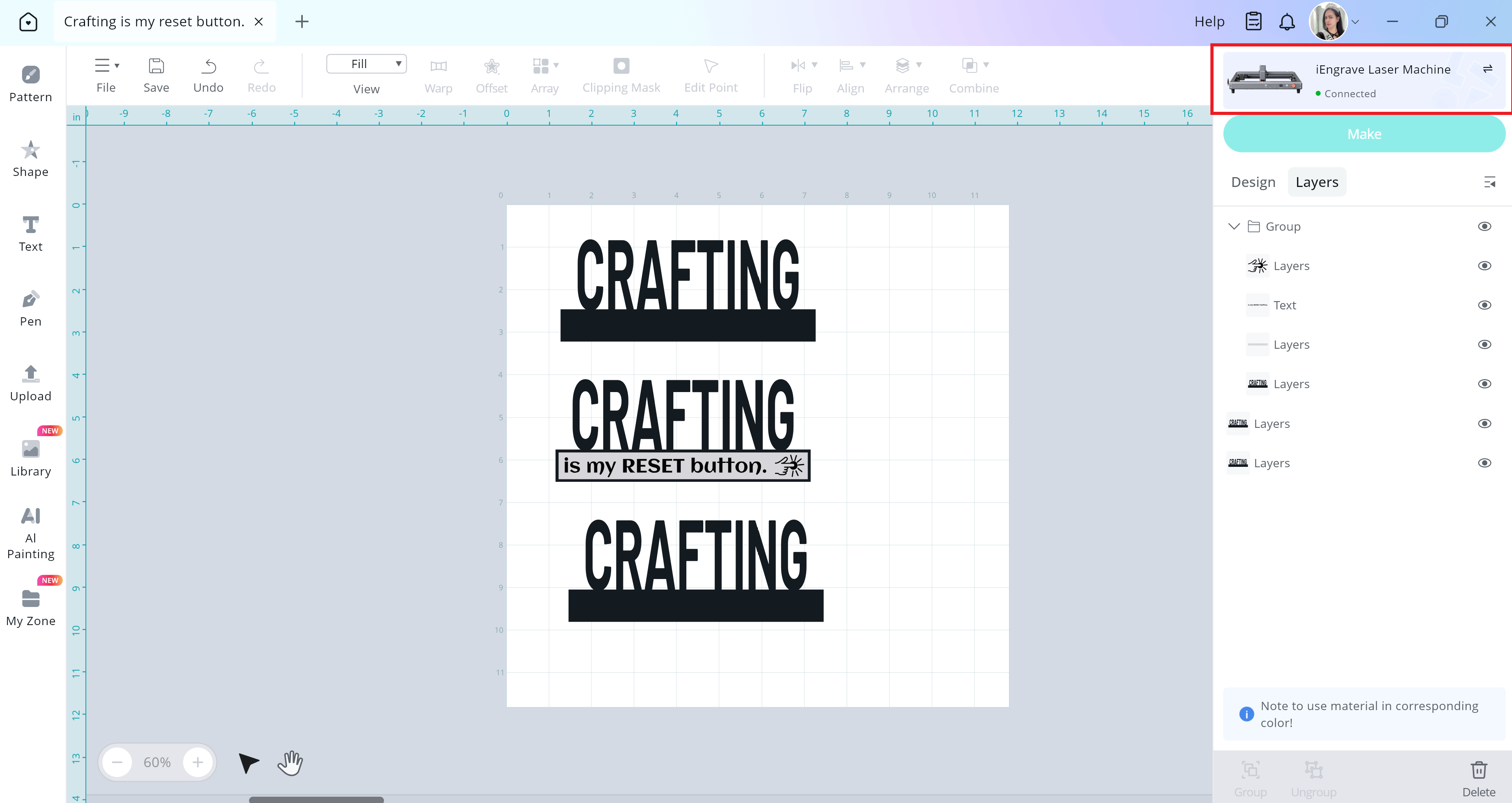

• When you return to your canvas, you should now see that your laser is successfully connected to your computer.
