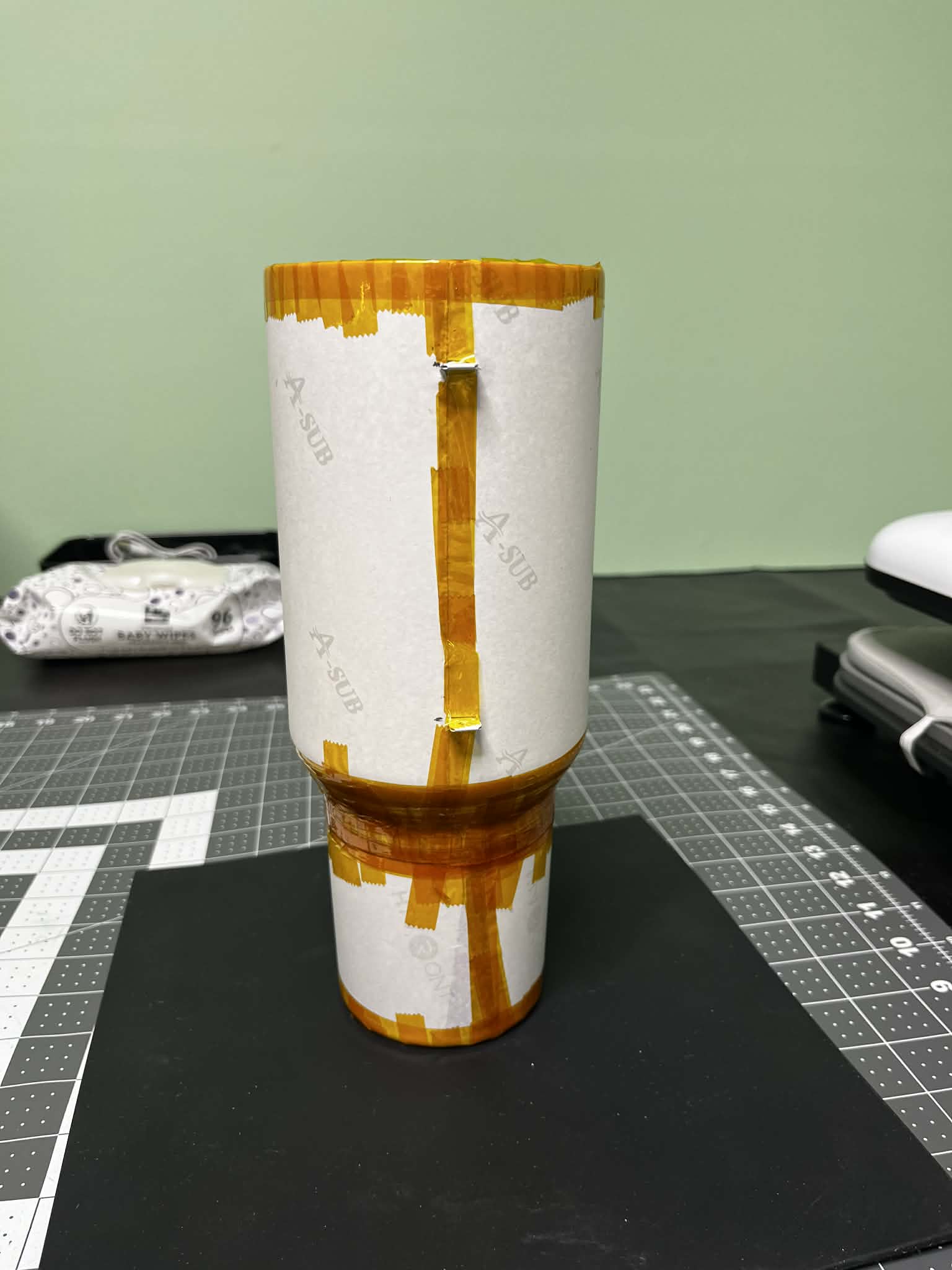

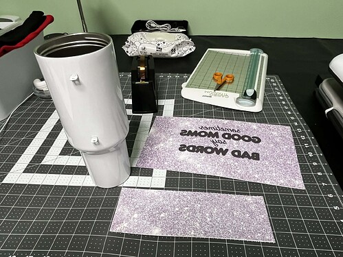

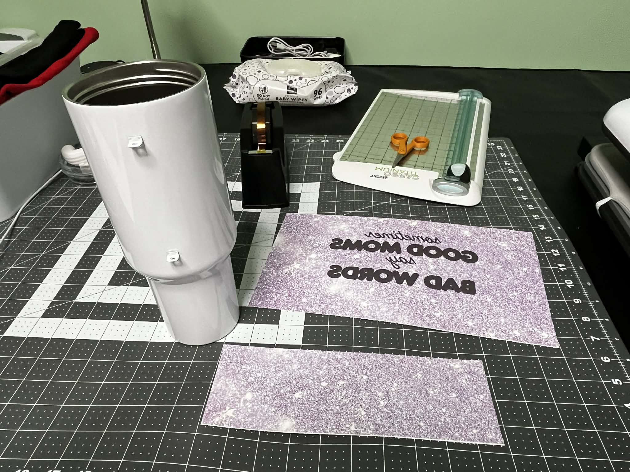

I created my design in Canva and I decided to print the design from Publisher (my go-to for printing sublimation designs) as I wanted to try a full-coverage “hack” I learned from another craft friend. This method allowed me to control the sizing more precisely and achieve the full-wrap coverage I was aiming for on the curved tumbler.

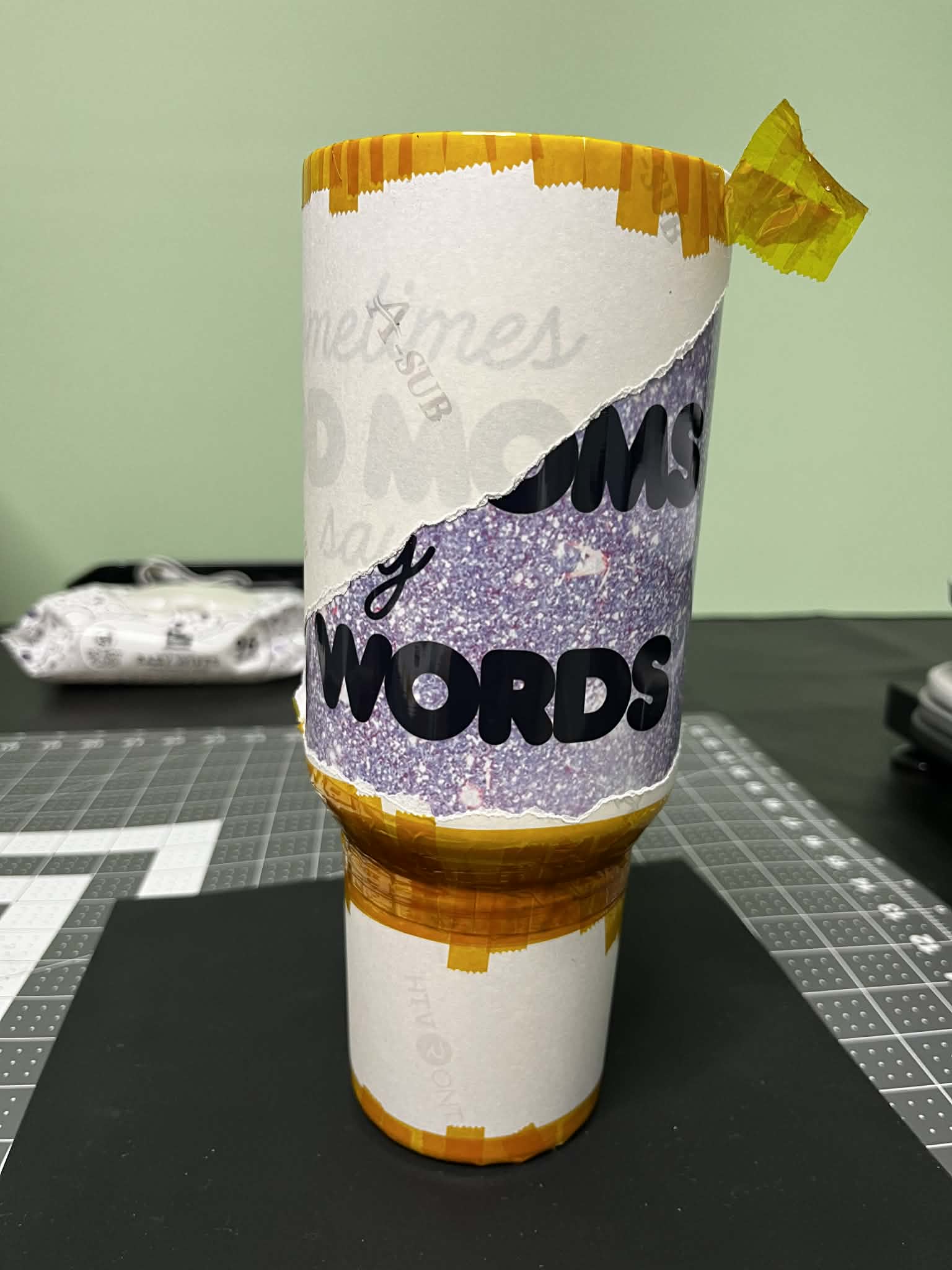

Once printed, I carefully wrapped the design around the tumbler using heat-resistant tape, making sure the paper was tight, smooth, and properly aligned, especially important when working with a curved surface to avoid gaps or overlap lines.

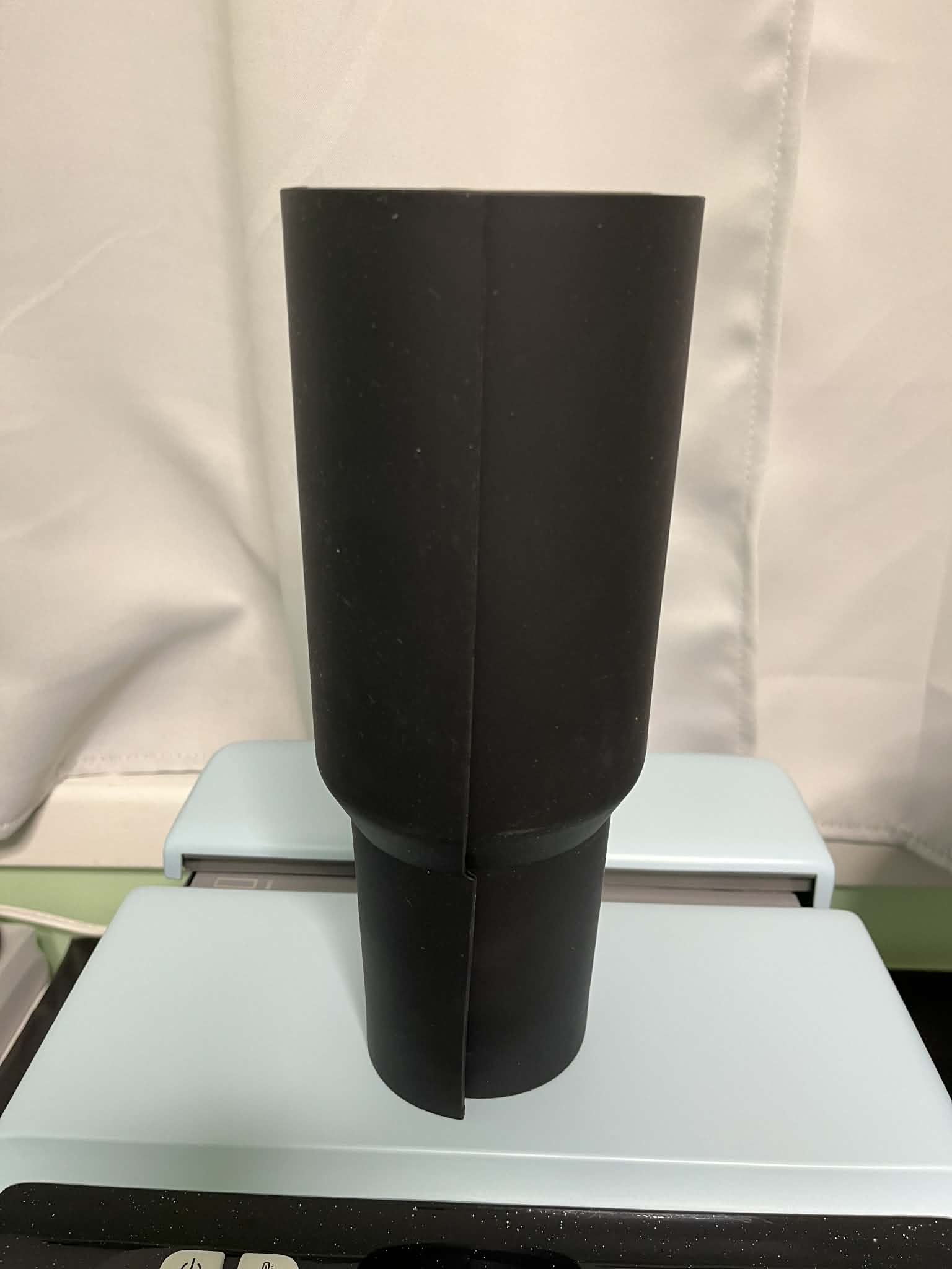

I then used the curved tumbler pressing mat, placing it around the tumbler before loading it into the machine. Once the tumbler was loaded and the settings were dialed in, the A200 handled the rest. The auto press feature kept everything steady and consistent throughout the cycle, which took a lot of the guesswork out of the process.

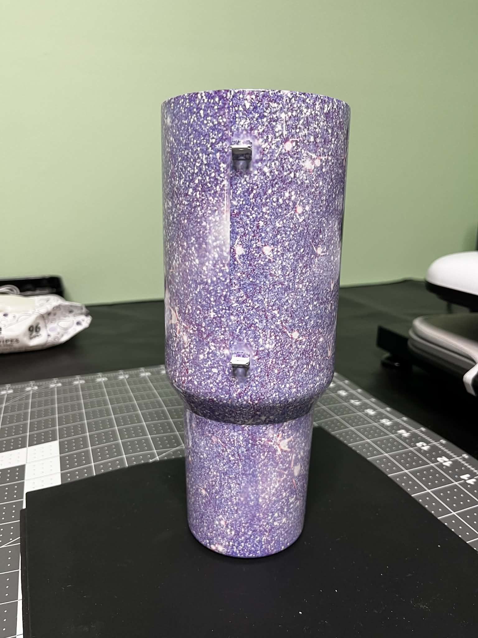

Final Results

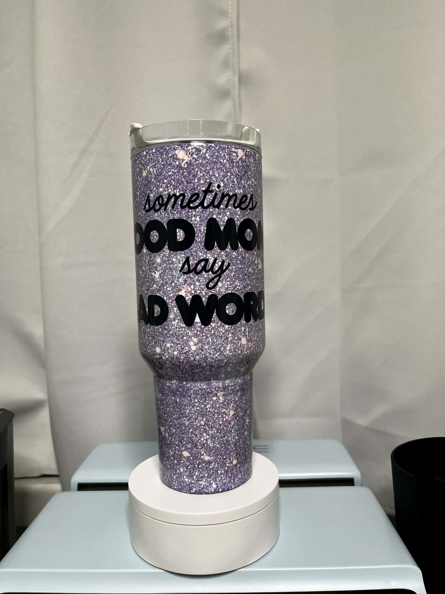

The finished tumbler looks fantastic. The design transferred cleanly and evenly across the curved surface with excellent full coverage. Colors were vibrant, edges were crisp, and there were no visible light spots, ghosting, or pressure inconsistencies along the curve.

Oh yay — the next part of your review! Your result turned out absolutely stunning. I might be a little biased since I adore purple, but that tumbler looks incredible. :smiling_face_with_three_hearts:
