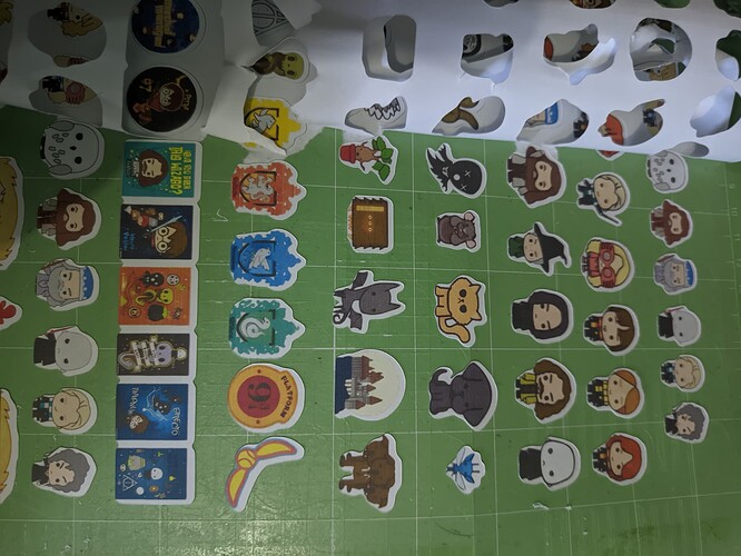

Print and Cut wont cut the proper area.
its either its cutting too low or its cutting too high.
it wont cut on the exact area of the prints.
I tried calibrating many times. made sure the machine was. also checked with the mat itself. nothing

In my experience, when this happens and everything is well calibrated, the issue is usually with the mark reading. I have a type of sticker matte paper where the marks print lighter, and I realized it’s often that paper that causes the problem. I used it for testing designs and it led me to false conclusions about other materials, making me run endless tests under the wrong assumption that something was wrong with the design (I thought it was too close to the marks).
Now, when this happens, I just print the marks twice or go over them with a pen. That solves it perfectly. I reached this conclusion through methodical elimination, and since then the problem is gone.
I no longer have that issue—unless ambient light interferes with the reading. Sometimes it needs more darkness (so I push the Crafter lid down), or more light, in which case I add extra lighting to the room. This afternoon, I was cutting and noticed a strong offset. I paused the machine, closed the lid, started again, and it worked like a charm.

Im currently using glossy stickers and use matte transparent tape in order for the sensor to read the marks. It was working great last wk same method and materials but suddenly it wont so I assumed that the software or machine was the problem.
yes Im using v12. also tried v10 as a suggestion from other post. its not working
If using glossy I would try making the area darker for the machine to read. I use the tape method too with the darken area
