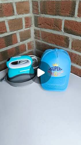

Now I placed my hat on the cover and the special made ironing mat, then started placing the htv with the heat resistant tape to make sure it stays on its place.
I turned my automatic hat press on 155° Celsius for about 15 to 20 seconds.
When the temperature is ready you can start pressing the design on the hat, you can go slowly to the sides or up and down.
P. S to make the timer start press the turn on/off button for 2 to 3 seconds and the machine will beep and start counting.
After the time is finished remove the plastic carrier carefully, if you see some parts didn’t stick you can press again.
P. S some htv is cool peeling
And just like that the lame hat is turned into a cool hat for mommy to wear at the football field while cheering her kid :soccer::heart_eyes::sunglasses:
