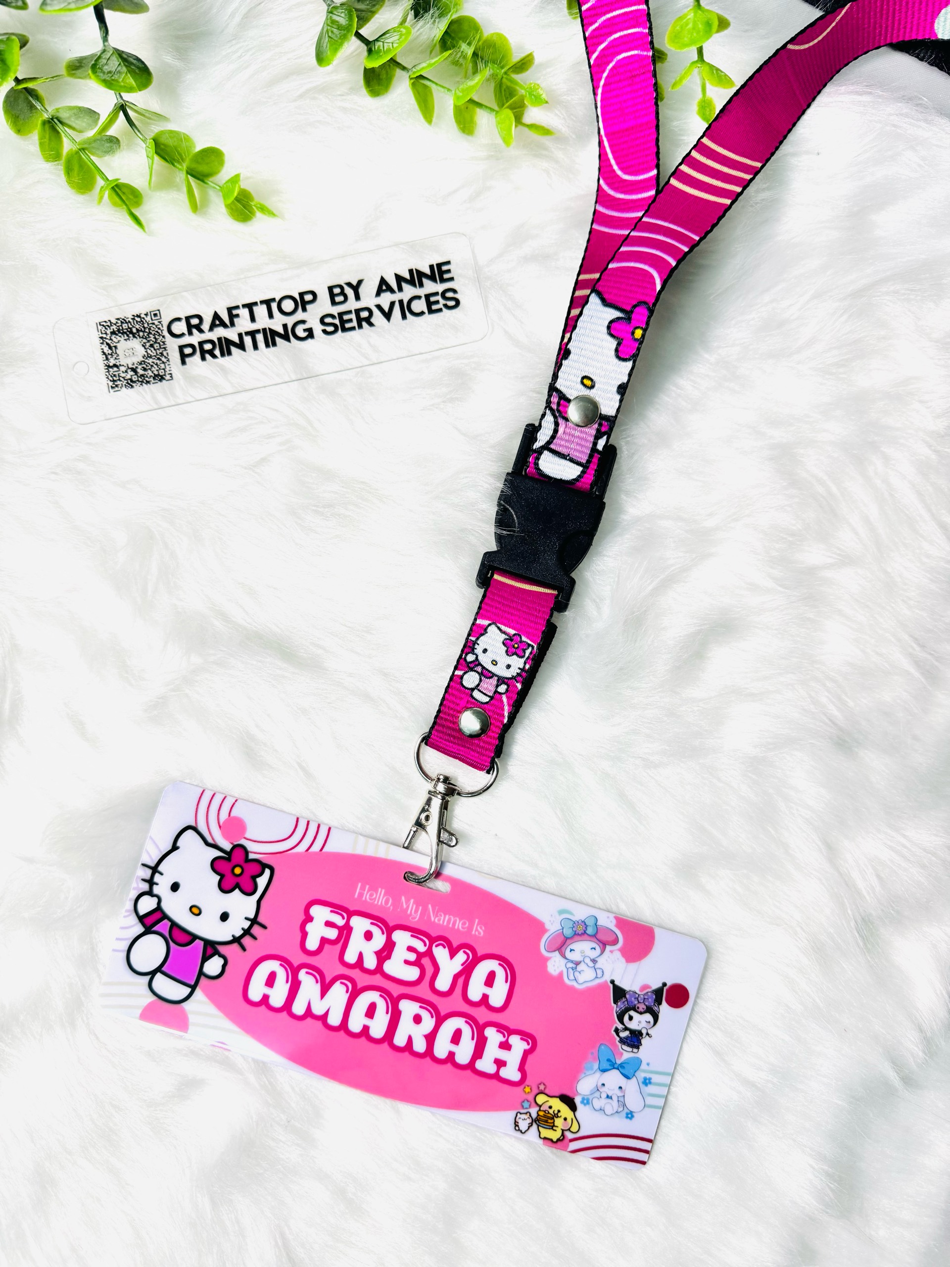

No Lanyard Press? No Problem! Loklik Impress 2 is the answer! Yes, you can make lanyards with loklik impress 2.
How to print Customized Lanyard.
  1. Just print your design (39inches) on sublimation paper using your favorite sublimation printer. Don’t forget to mirror your design.
  2. Cut your Lanyard in 41inches (ideal size for kids) yes, 41 inches because it will shrink once pressed.
  3. Pre-press your lanyard with 200 degress celcius in 10 seconds.
  4. Place your design on the lanyard and press it with 200 degrees celcius in 40 seconds.
  5. Once pressed assemble it with Button Rock and Lanyard holder.
How to make Nametags:
  1. Make your design
  2. Print your design on Pet Sheet using your pigment printer. Don’t forget to mirror your design.
  3. Place your design on PVC sheet
  4. Laminate
Hoping it will help you. :slightly_smiling_face:
