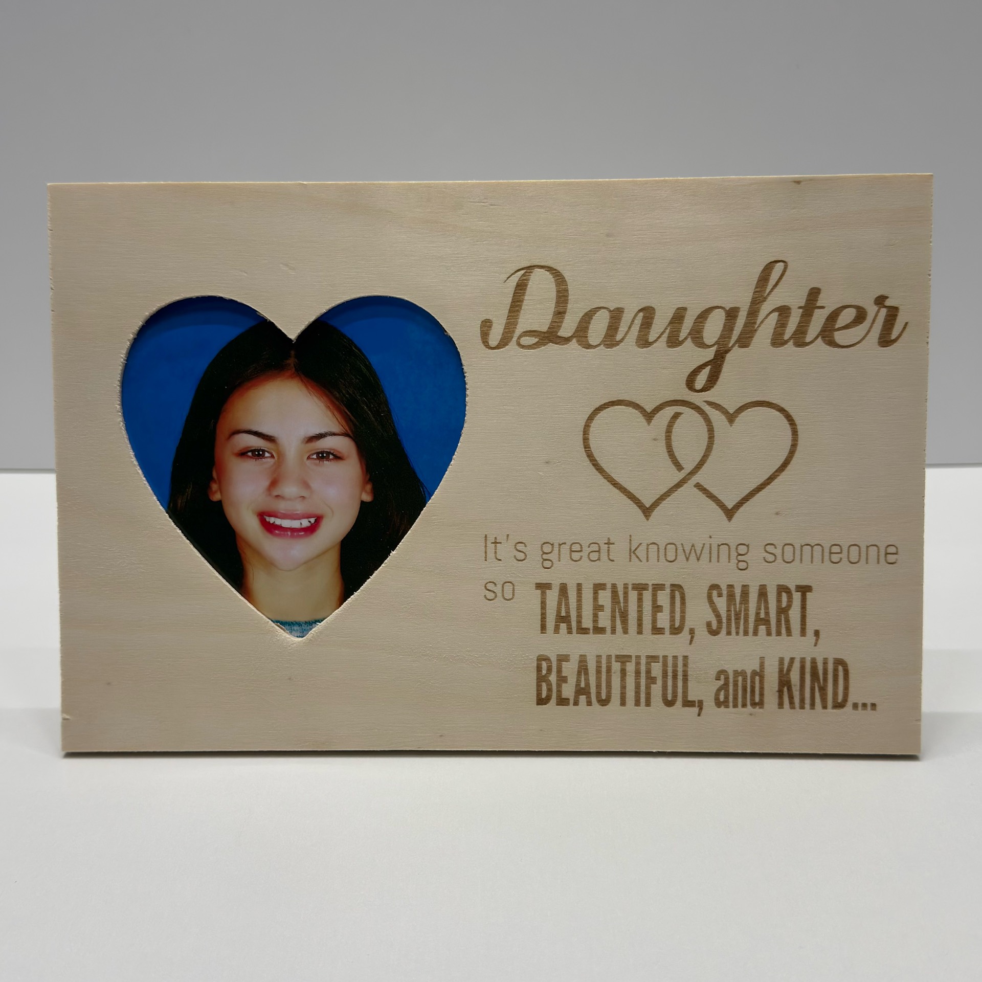

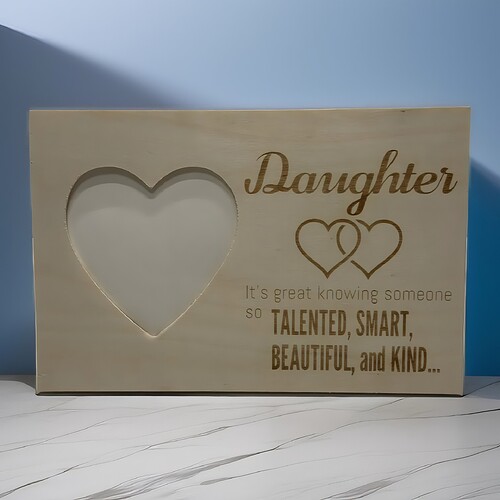

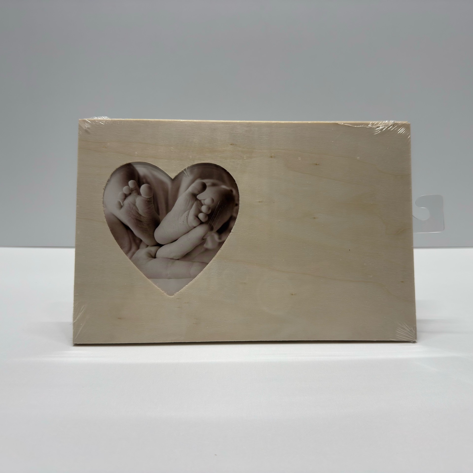

I just unearthed a wooden picture frame from my craft stash—one of those forgotten gems tucked away in the wood pile. Instantly thought: this needs to be engraved and customized for my daughter. A little love, a little laser magic, and it’ll be a keepsake she’ll treasure.
It’s great knowing someone so TALENTED, SMART, BEAUTIFUL, and KIND…
…but it’s EVEN BETTER when she’s your DAUGHTER!
SOFTWARE USED: IS Desktop Version
MACHINE USED: LOKLiK iEngrave Cover Machine
FONTS USED: Poetry Script, Abel-Regular, and League Gothic-Regular.
DESIGN: Heart design was from Ideastudio Library.
MACHINE SETTINGS:
Engraving the Design
Engraving Mode: Flat
Operation Style: Engrave
Mode Style: Fill
Material: 3mm basswood
Power: 90%
Speed: 7500 mm/min
Passes: 1
Time: 12 minutes & 14 seconds
MATERIALS USED:
🩷 9.25" x 6.00" wooden picture frame

It is a as beautiful as meaningful project. I love that you empower her at the same time you make her feel loved.

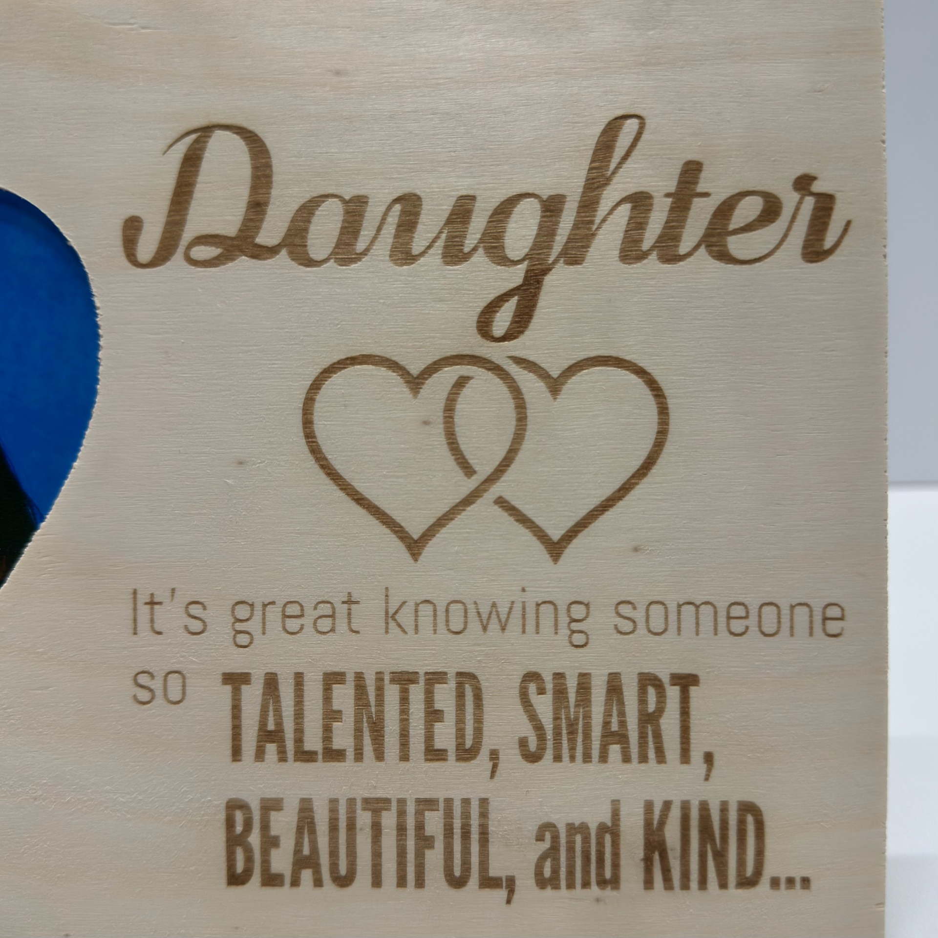

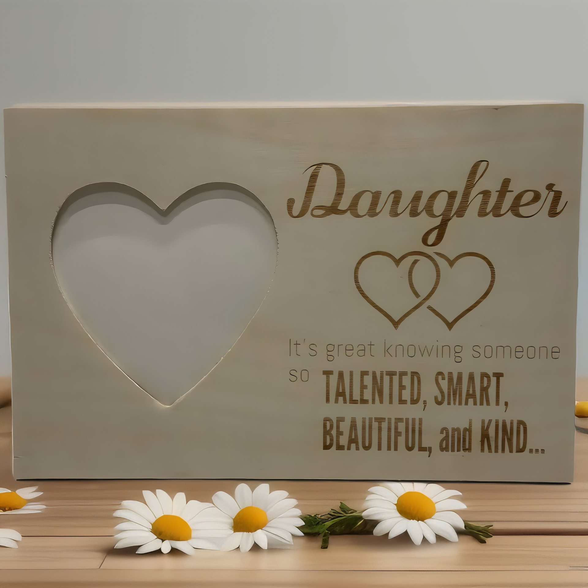

The engraving is awesome. There is a darkeness in the bottom of the g that makes it more authentic. Is it a random effect? I love to learn from your engravings with all the details you share from such different projects. Well done again and thank you so much for sharing!
Love this extra touched of your creativity! You always make a simple thing turned to a wonderful creation!
@redhada, Thank you so much for your kind words! That truly means a lot to me . 🩷 I always try to pour both intention and emotion into each piece, so knowing it resonated with you makes my day.
The engraving detail you noticed—especially that subtle darkness at the bottom of the “g”—was actually the wood grains being exposed on that part. You’ll notice unique variations in the engraving—those cool effects often come from the natural texture of each material and how the wood grain is positioned. Every piece tells its own story, shaped by the surface it’s carved into.
I’m so glad you enjoy the behind-the-scenes details! Sharing the process is one of my favorite parts, especially when it sparks curiosity and connection like this. I’ve got a few more projects coming up that play with contrast and layering—can’t wait to share those too.
Thanks again for your thoughtful message and for being part of this creative journey with me :star2:
@kat, Aww, thank you so much! That truly means a lot :smiling_face_with_three_hearts:. I love finding little ways to add heart and personality into each piece—it’s like giving even the simplest things their own little spotlight. Your words just made my day! :sparkles: :kissing_heart:
That’s awesome, I can´t stop learning from your comments. I truly enjoy it all :hand_with_index_finger_and_thumb_crossed:
