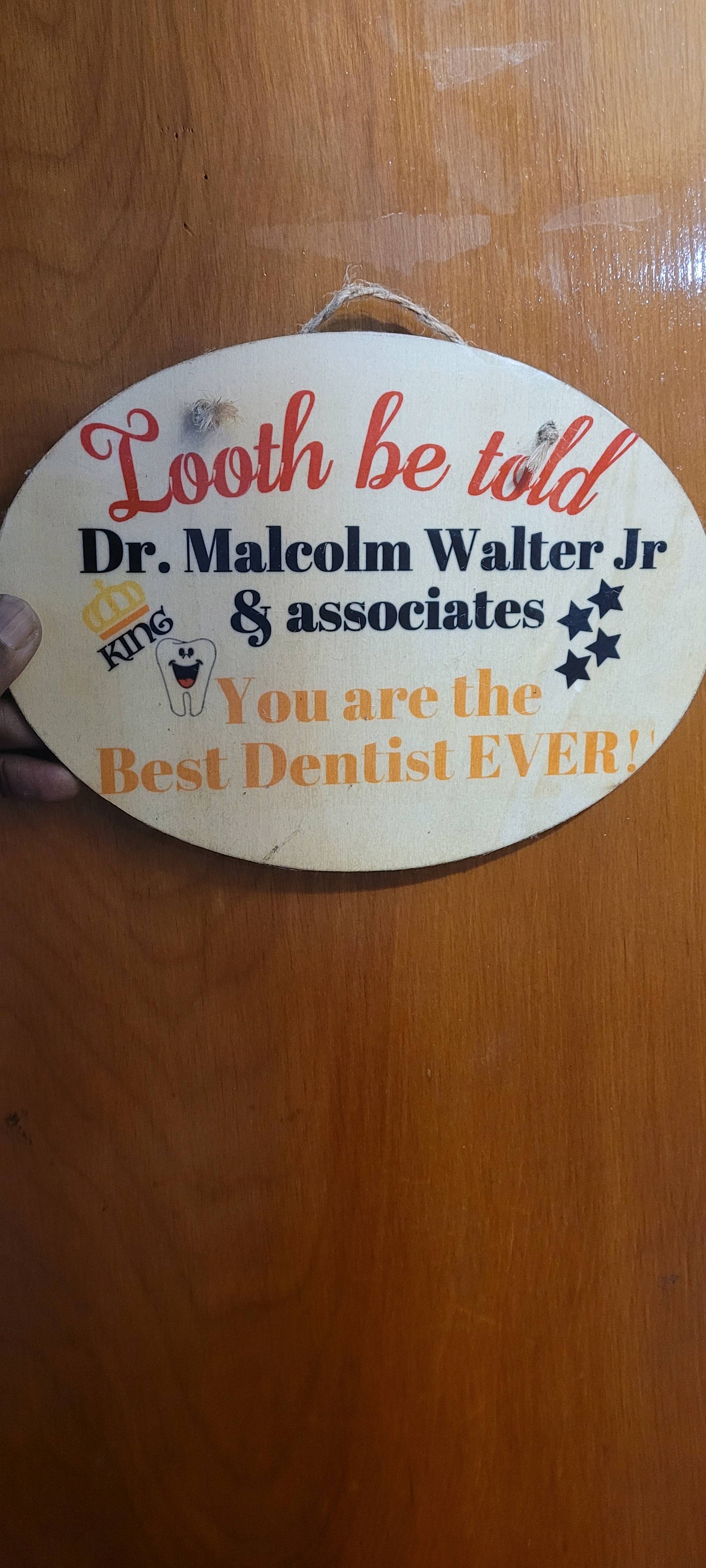

That kind of care deserved more than a thank-you. So I designed this door decal as a tribute.

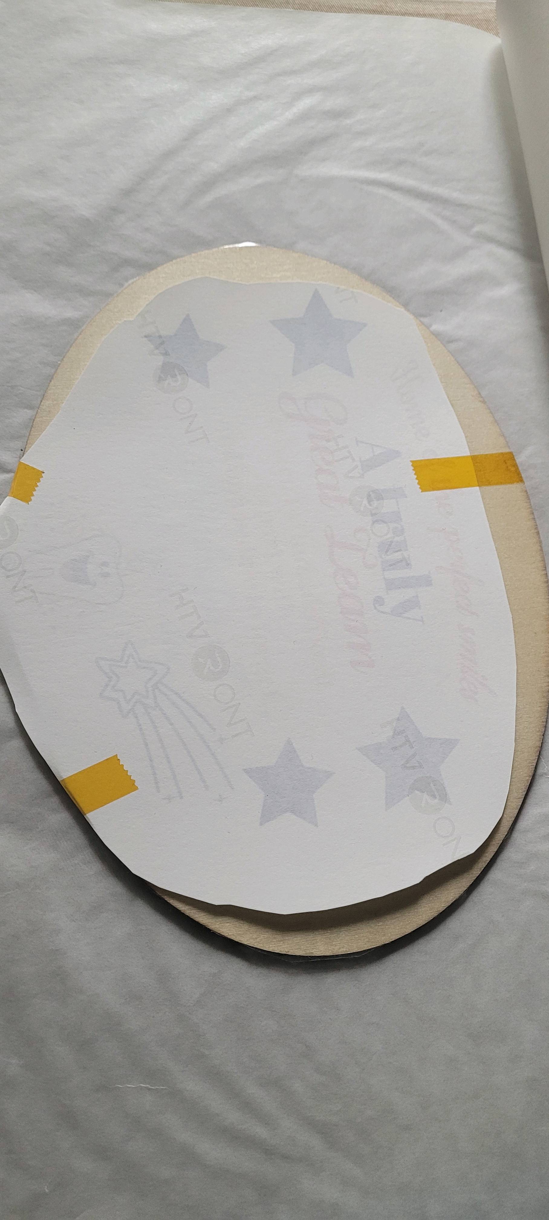

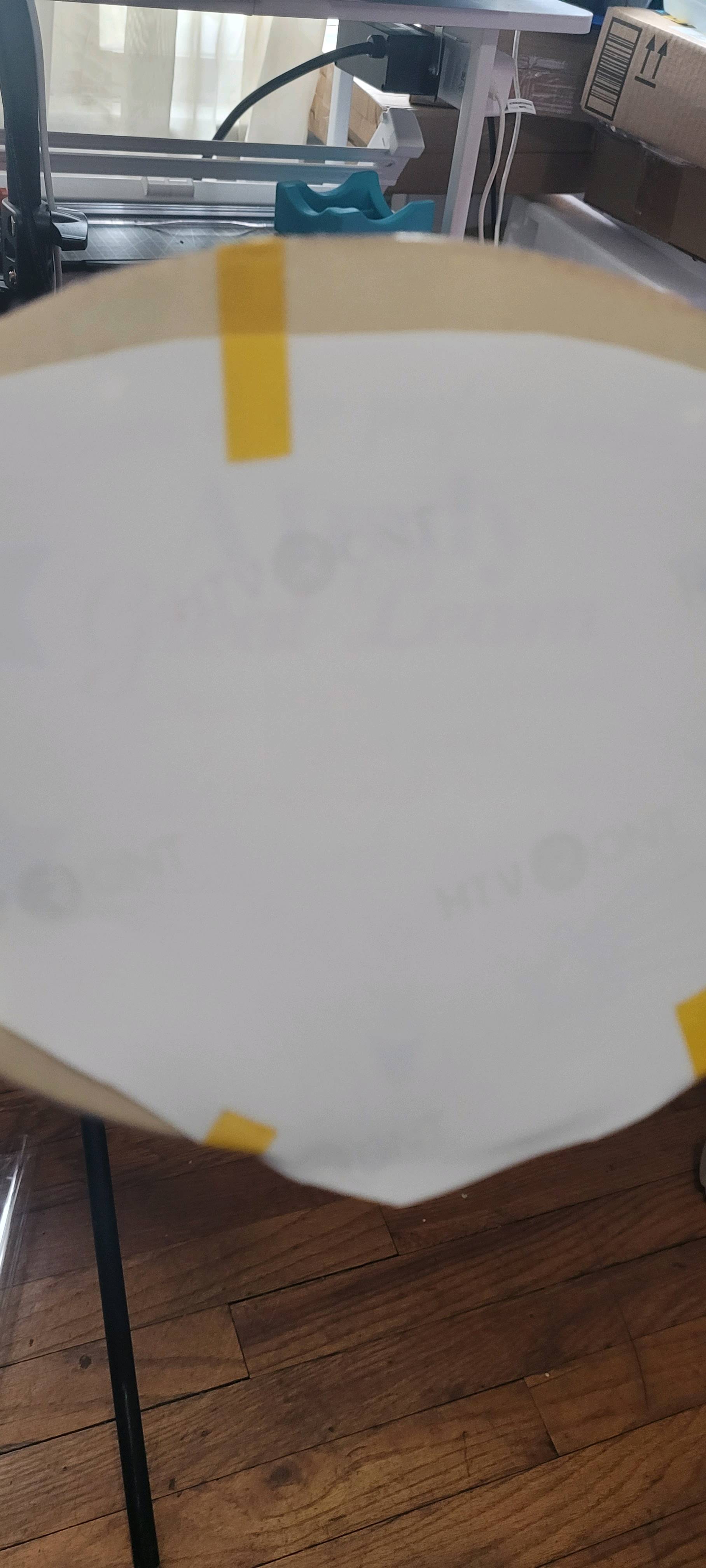

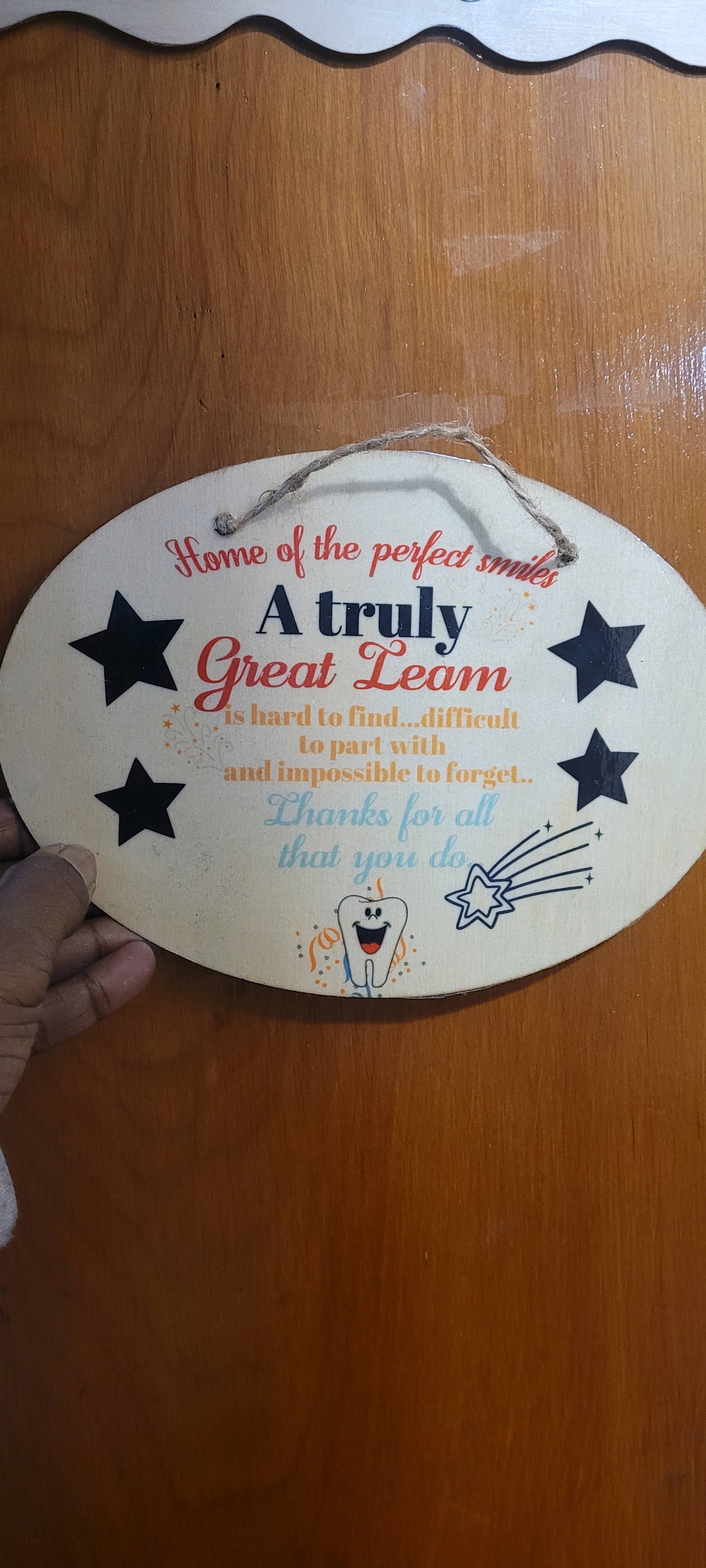

I created the layout in Ideastudio, printed it using my Brother sublimation printer, and prepped the wooden plaque with an adhesive lamination sheet. After cleaning the surface, I pressed it at 390°F for 40 seconds, taped down the sublimation paper, and pressed again at the same temp and time. The result? A bright, bold, joyful piece that radiates appreciation. The hiccup that I had was that I had to press it twice when I pressed the other side. I also tried to print my logo on a tissue paper however there were all kind if streak marks going through them…
Seeing Mr. Walter smile and hearing him say I made him smile made my day. This isn’t just decor — it’s a moment of gratitude, captured in color and craftsmanship.
