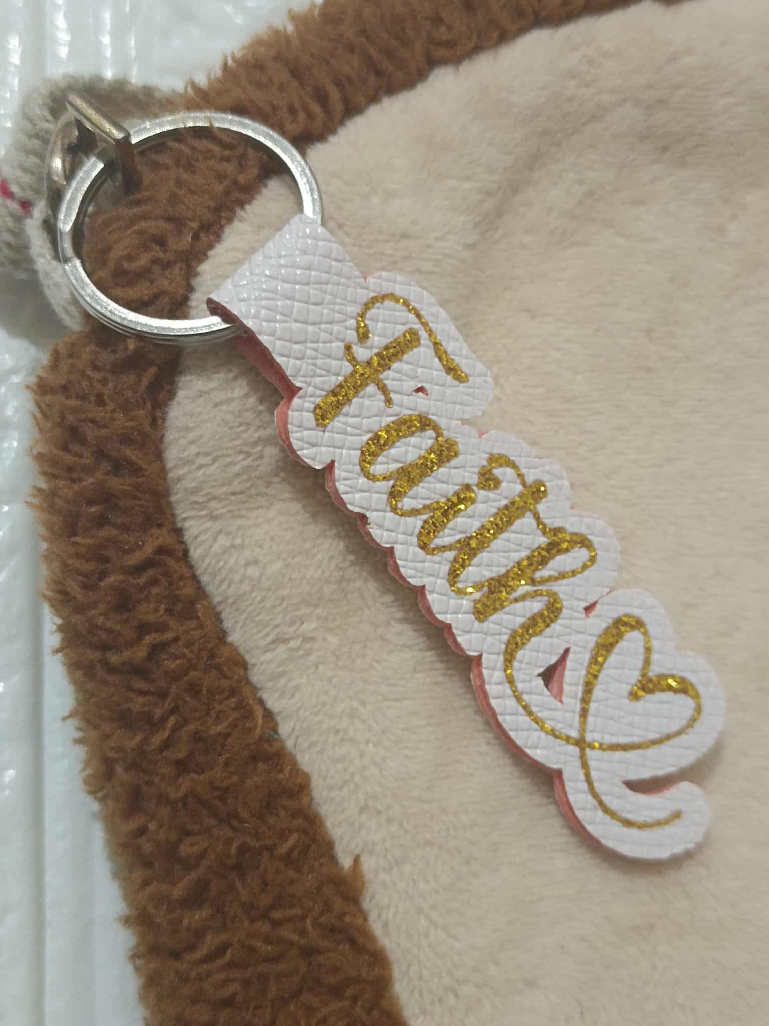

A personalized name leather keychain with Gold Glitter HTV.
It looks pretty ![]()
Thatâs so beautifulđWhat blade did you use?And how thick is the leather?
That looks awesome! Very pretty glitter htv too!
@ZannX thank you⊠the leather is 1mm and I used fine point blade. ![]()
@DianeB thank you⊠Thatâs why I chose the glitter HTV as my freebie when I purchased the machine, I just love the glittery finish!
Beautiful!!!
thank you @Eileen_Stafford
Hola! QuĂ© chulo, ÂżquĂ© tipografĂa has usado? Gracias ![]()
Thank you! I used the Joseph Sophia font for this one. BTW, the letter âhâ with the heart and glyphs is actually just one character⊠![]()
Thank you! It looks so pretty. And what about the faux leather? Is it a specific material only for cutting machines or you can just buy any?
The faux leather I used isnât a special type made specifically for cutting machines. I bought it online, and it was described by the seller as Prada Thick Faux Leather (though itâs only 1mm thick). Since mine was soft and flexible, I was able to use my fine-point blade without any issue. But if youâre working with thicker or stiffer faux leather, Iâd recommend switching to a deep-point blade for a cleaner, more precise cut. And donât forget to use the right mat, some types of leather really need a strong grip to stay in place during cutting. ![]()
Thank you so Much! I will try that ![]()
Sure thing, dear! Youâre very welcome⊠![]()

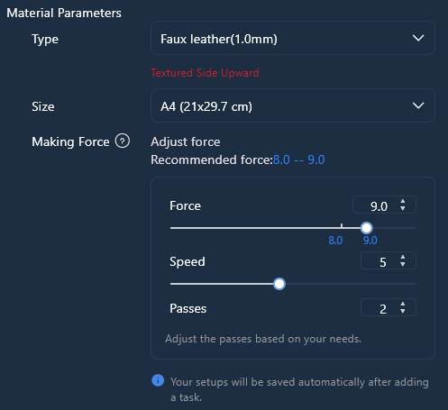

Hi, which cutting parameters did you use? Thank you!
Hi @Andrea_G⊠I used the maximum force preset in the LLIS for 1mm faux leather⊠But Iâd recommend doing a quick test cut first, a small shape in the corner should be perfect⊠![]()
