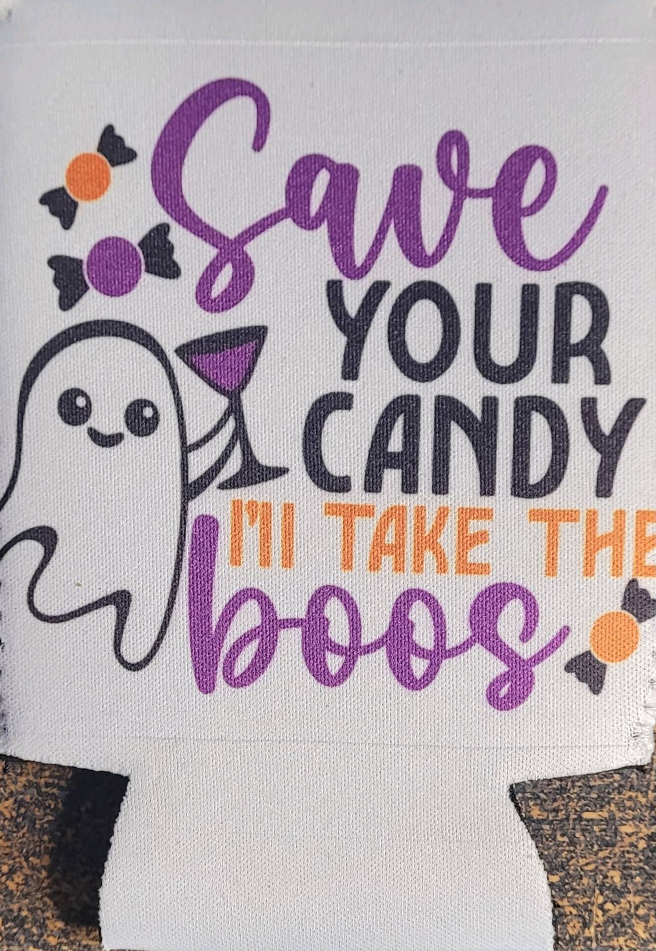

Short, sweet, and exactly what I did: I used a Loklik design that says “Save your candy, I’ll take the boo’s.” I used can coolers from Hobby Lobby, printed on HTVronts sublimation paper, pre-pressed the cooler for 10 seconds on my HTVRonts Heat Press 2, then sublimated at 390°F for 40 seconds — both sides. I loved how it turned out and I had no hiccups.

My final thoughts are pressed at 390° for 40 seconds on both sides & honestly I love how we came out.
No hiccups
