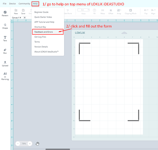

Thanks Sue @MadeByYaBoi after a week unused, white ink settles quickly and clogs easily it sounds like your white is blocked. it might be best to reach out to HTVRONT tech support.
also I found this on HTVRONT website “why is my DTF printer not printing white”
Find Support here in LLiS ↓
