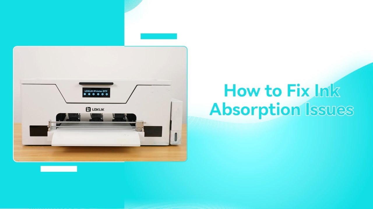

Not sure but these videos might help you too

If you’re still stuck, I recommend checking out LOKLiK’s full troubleshooting guide and this ink absorption video for visual steps like @BellethehowtoGuru mentioned above. You can also reach their support team at support@loklik.com or call +1 855-908-0870
