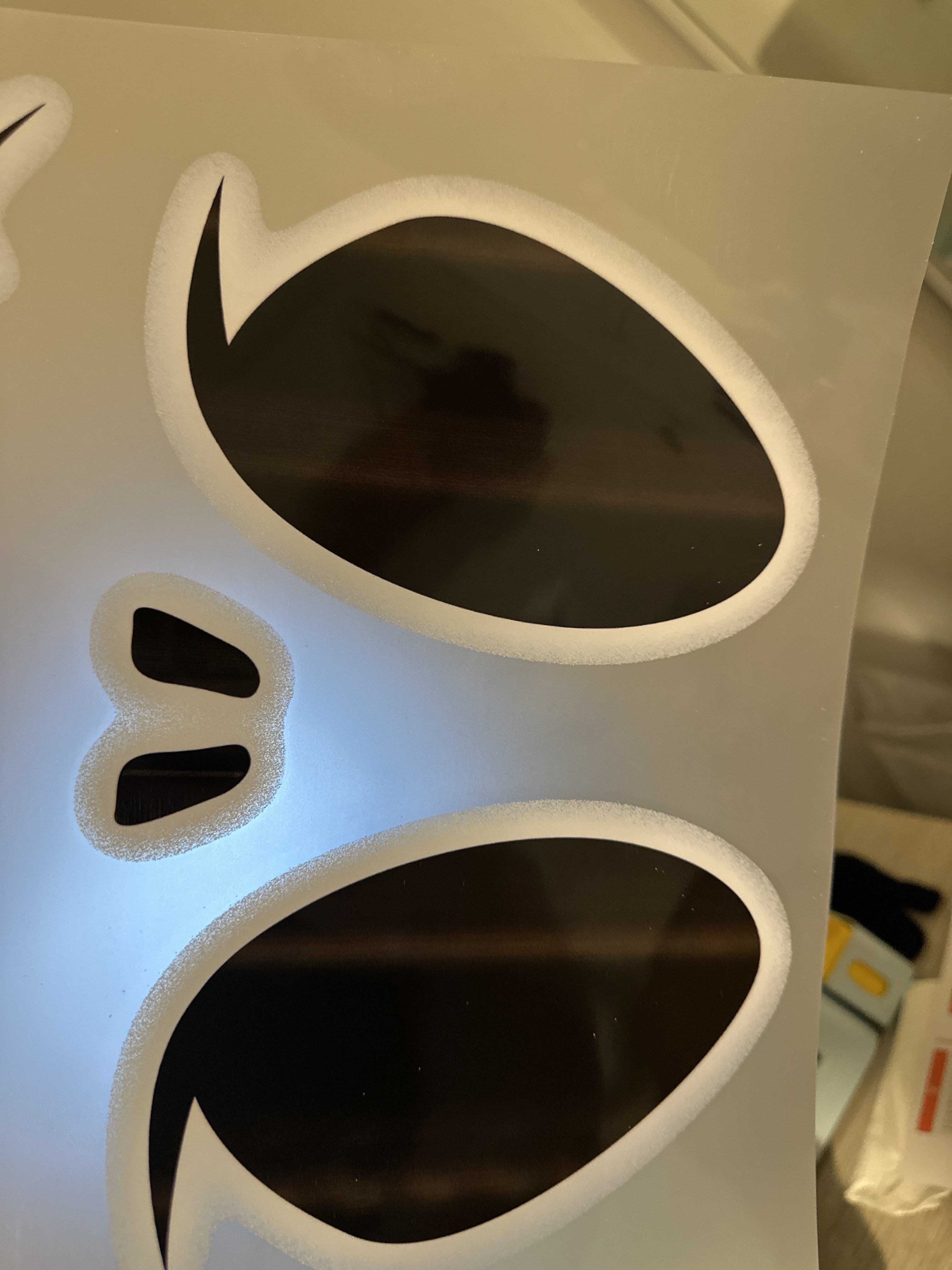

Fades streaks
Does anyone know how to fix this lines printing
Hi and welcome to the community @Comfortpro.tanya! White lines in black DTF prints can be super frustrating—I’ve been there. A few things to check:
:soap: Printhead Nozzles – Run a nozzle check to see if any nozzles are clogged. A quick cleaning cycle might help.
:printer: Print Settings – Make sure your resolution is set high enough and that you’re using the correct ICC profile for your film and ink combo.
:page_facing_up: Film Feed – If the film isn’t feeding smoothly, it can cause banding. Try cleaning the rollers and checking for any tension issues.
:fountain_pen: Ink Levels & Flow – Low or uneven ink flow (especially black) can cause streaks. Gently agitate your ink tanks and check for air bubbles in the lines.
Moreover, you can check this link for further guidance and for your reference only LOKLiK iPrinter™ DTF-A3-XP600 Guide
If you can share a photo or more details (like software settings or when it started happening), I’d be happy to help troubleshoot further!
