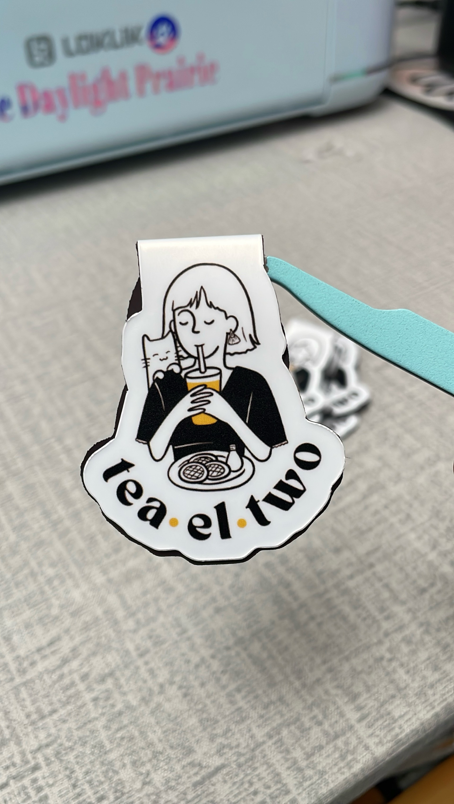

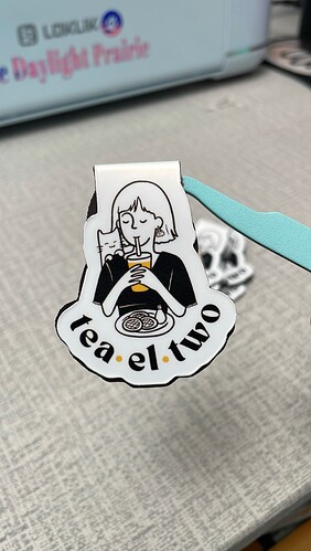

Hello fellow crafters! I’d love to share a fun and functional inspiration project that I recently made using my Loklik machine — a full magnetic bookmark featuring a custom logo design.

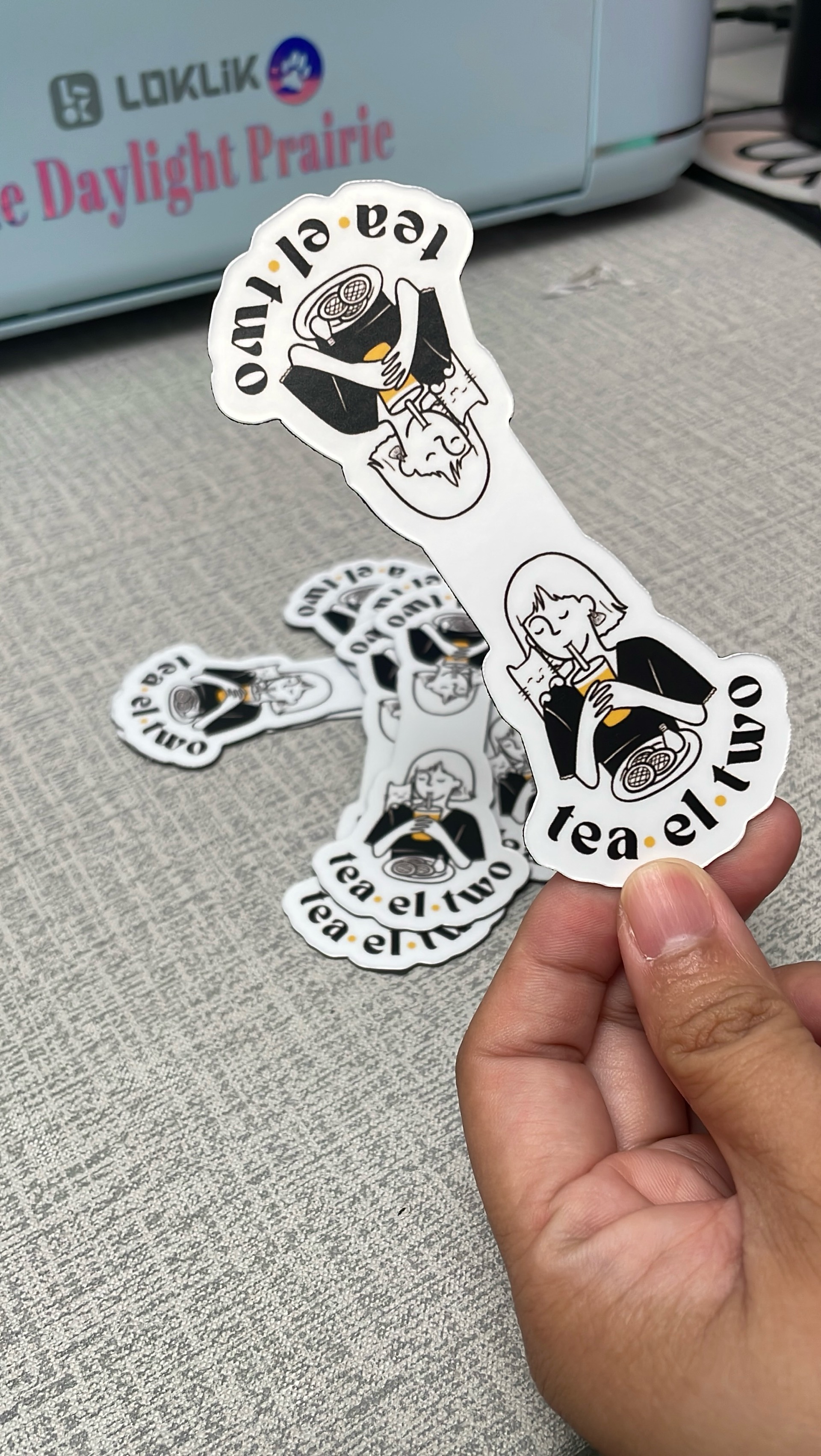

:open_book: This bookmark is made from .5mm magnetic sheet, making it strong enough to clasp onto your page securely without slipping. I used a logo design and duplicated it, flipping the second one vertically so it aligns perfectly once folded.
:art: Materials used:
• .5mm Magnetic Sheet
• Vinyl Sticker (for the design)
• Satin Laminating Film (for a smooth, protective finish)

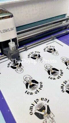

:hammer_and_wrench: Cutting Settings (Loklik iCraft):
• Force: 11
• Speed: 8
• Passes: 15
Once cut and folded, it snaps beautifully onto book pages or planners — making it both cute and functional! :yellow_heart: I absolutely enjoyed the process and the result turned out so satisfying. You can customize this with your own brand, favorite quote, or a cute character design — the possibilities are endless!
:books: Perfect for gifts, branding merch, or simply for your own reading joy. Hope this inspires you to try something similar! :star2: Would love to see your versions if you give it a go.

this looks fab! did you use the deep blade and 15 passes? :heart_hands:
I used a 3rd party blade 60 degree Roland Blade since i don’t have a deep point blade yet :sweat_smile:
ooooh, I wasnt sure if there were any generic blades usable :+1:
