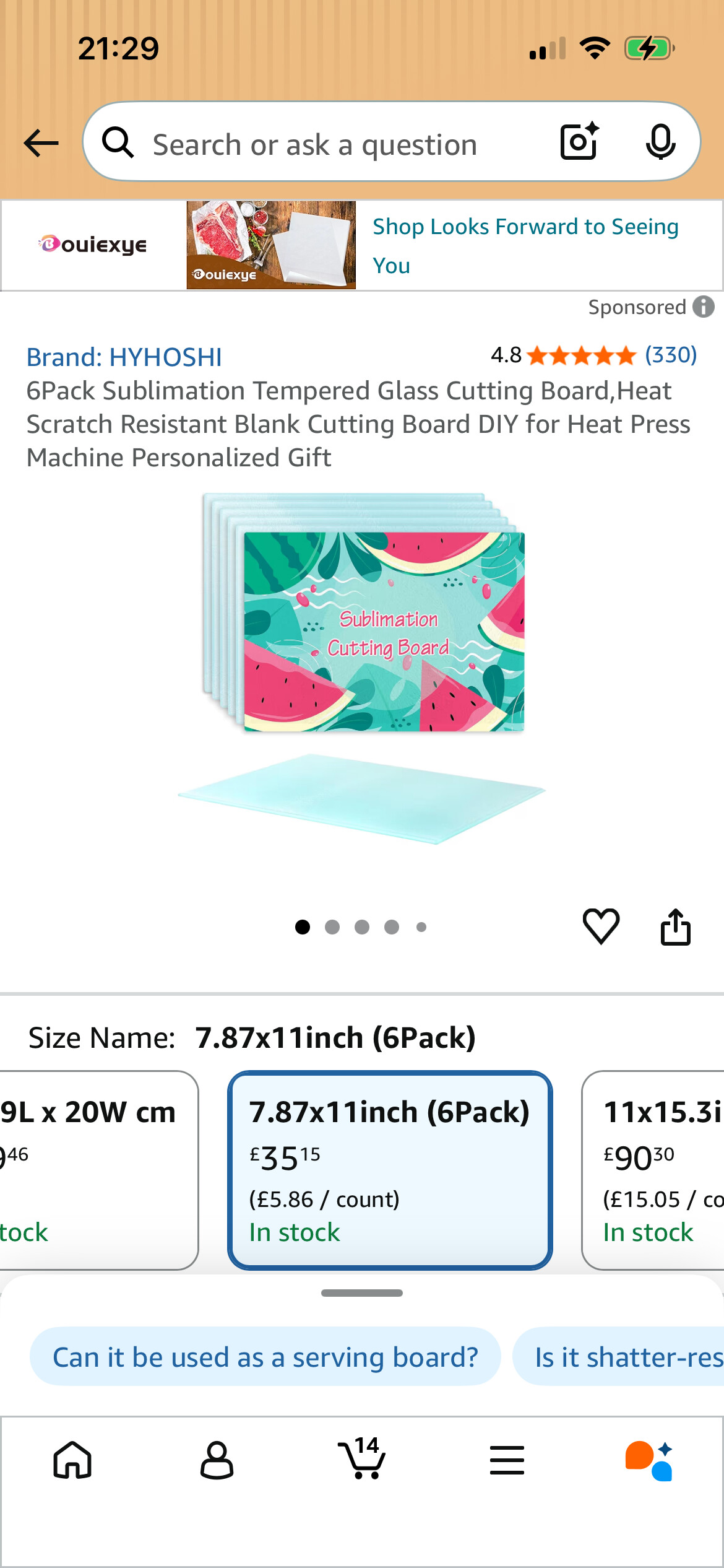

Here’s a link to sublimation glass cutting boards:

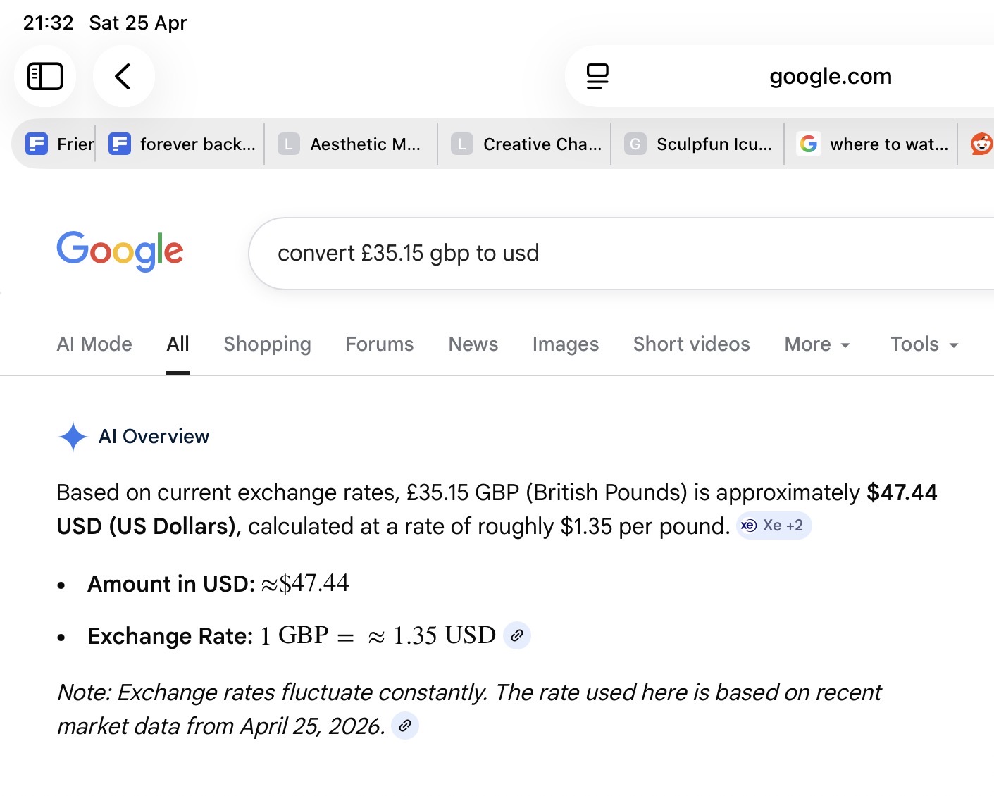

They look great Sam. That’s a much better price than Amazon UK too.
Yeah, that was the cheapest one that popped up. I always try to link to the lowest price, but with great quality. This set says “Customers usually keep this item,” so I figured they were good lol. The others were like $5-$10 more. :grimacing:
