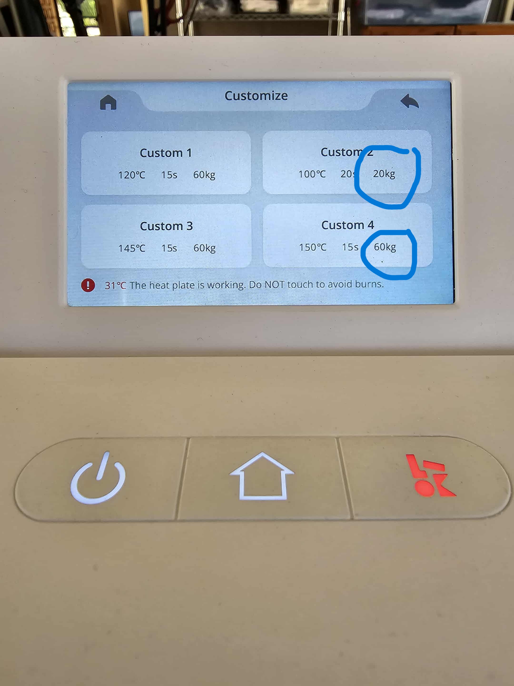

Hello @nornirontees welcome to the community, have you checked the pressure? you are able to adjust the pressure yourself in the settings

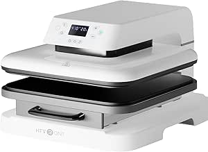

To help you better, we need a bit more information. You said the HTVRont automatic machine. Do you mean 1 or 2 ? As @InkiteeWorkshop mentioned on the 2 you can adjust the pressure yourself in the settings. If your machine is the HTVRont auto 2, your’s may look a little different. More like this

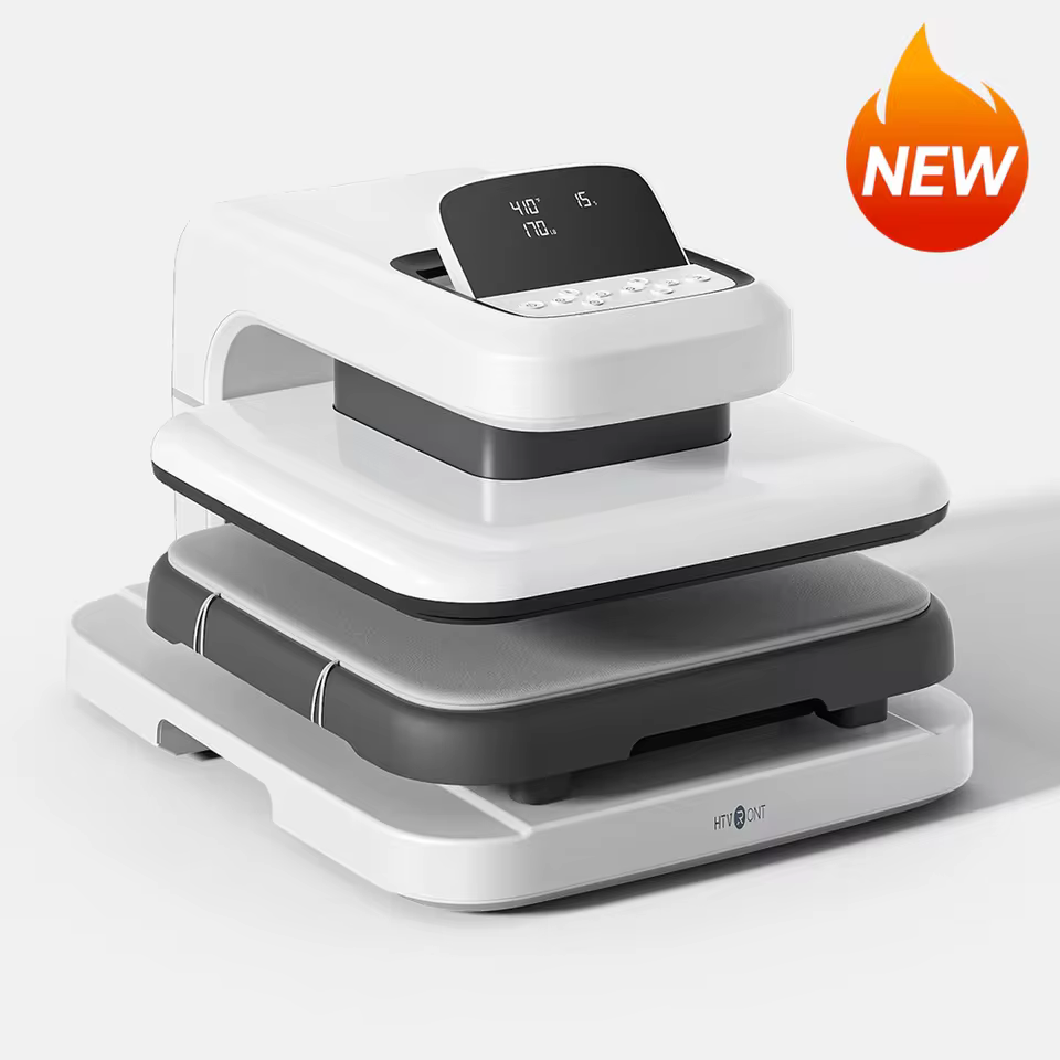

If you have the HTVRont Auto 1 machine it will look like this.
If you have the Auto 1, you can’t actually adjust it’s pressure. But there are a few things you can do.

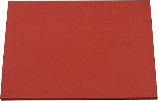

I actually bought a firm heat press mat for it. Looks like this, I took the heat mat that came with it off and use this now with the machine. I got mine from amazon, just make sure you look at the correct size you need.
