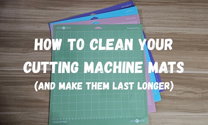

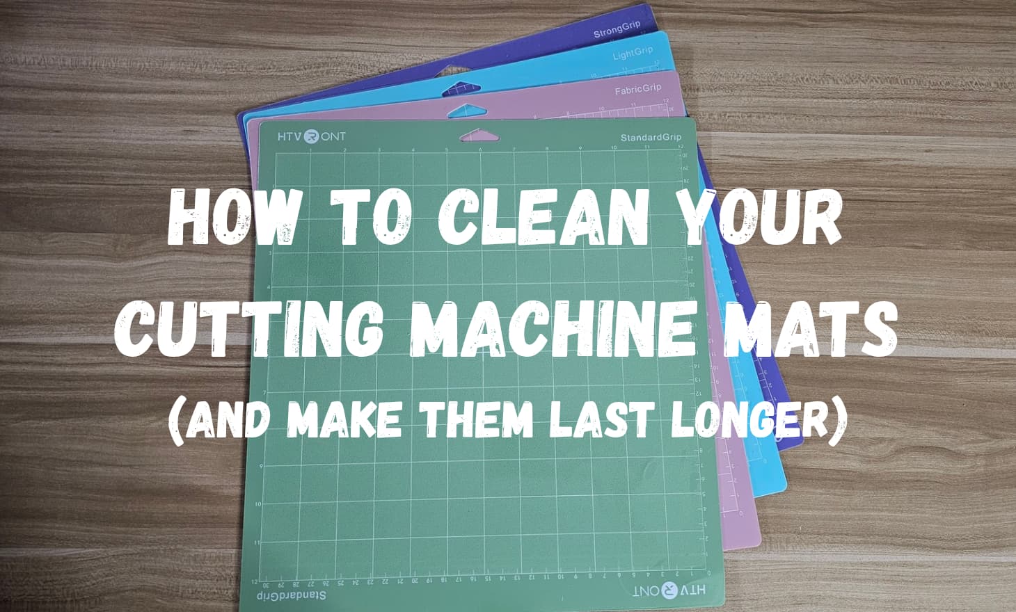

Cutting machine mats are the quiet workhorses of every craft room. Your mat is the foundation that keeps materials steady and cuts precise. But over time, dust, fibers, glitter, and oils from your hands build up — and suddenly your mat isn’t sticky, your materials slide, and your cuts get messy.
The good news: with the right cleaning method, you can revive your mats and extend their life far beyond what most crafters think is possible.
This guide walks you through what to use, what to avoid, and how to clean each type of mat safely.

Cleaning by Mat Type
Different mats = different stickiness levels = different cleaning rules. Here’s how to treat each one.
LightGrip (Blue) Mats
Perfect for: copy paper, vinyl, HTV, thin cardstock
How to clean:
- Use a scraper to remove leftover paper bits.
- Roll a lint roller across the surface to lift dust and fibers.
- If it still feels dirty, wash with warm water and a drop of dish soap.
- Gently rub in circular motions with your fingers or a soft sponge.
- Rinse and air‑dry completely.
Avoid: harsh scrubbing — it removes the adhesive.
StandardGrip (Green) Mats
Perfect for: cardstock, vinyl, iron‑on, patterned paper
How to clean:
- Scrape off debris.
- Use a lint roller to lift fuzz.
- Wash with warm water + mild soap if needed.
- Let it air‑dry flat.
Pro tip: If your mat feels too sticky after cleaning, press a clean T‑shirt onto it once or twice to soften the grip.
StrongGrip (Purple) Mats
Perfect for: chipboard, basswood, balsa, leather
These mats get dirty fast because heavy materials shed a lot.
How to clean:
- Scrape gently — don’t gouge the adhesive.
- Use a lint roller to remove fibers.
- Spot‑clean with baby wipes (alcohol‑free).
- Only wash with water if absolutely necessary — StrongGrip adhesive breaks down faster.
Important: Never soak a StrongGrip mat. It weakens the glue.
🩷 FabricGrip (Pink) Mats
Perfect for: fabric, felt, interfacing
FabricGrip mats are the most delicate.
How to clean:
- Use ONLY a lint roller.
- No water.
- No soap.
- No baby wipes.
- No scraping.
Water removes the adhesive instantly — and these mats aren’t cheap.
