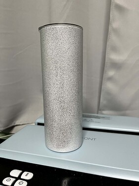

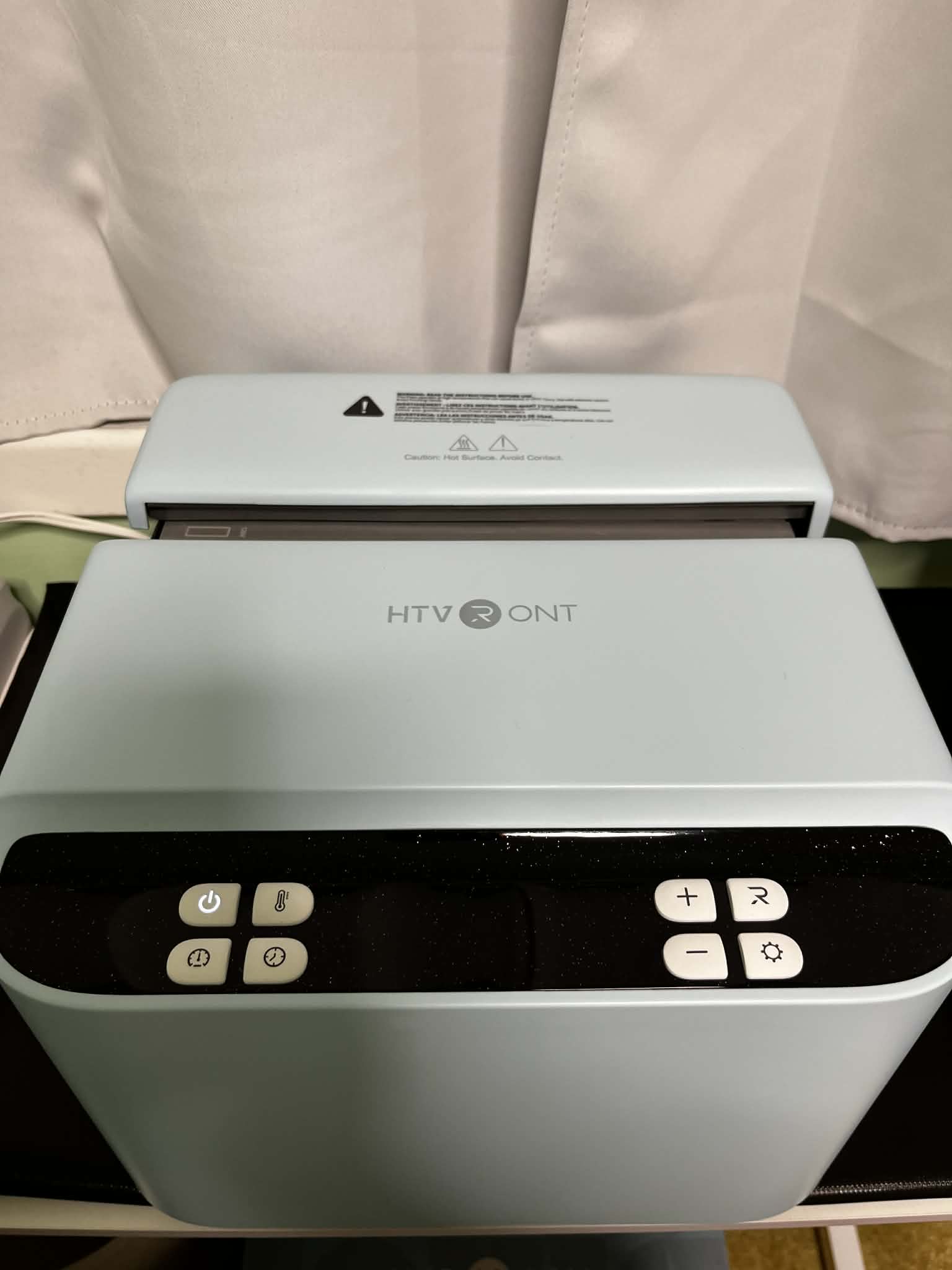

Swapping out the heat plate on the A200 is very straightforward. The skinny attachment fit securely, and the press powered on quickly. I set my time and temperature directly on the digital display, which is clear, responsive, and easy to read.

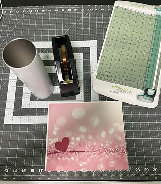

  • Tumbler: 20 oz skinny glitter tumbler
  • Design: Valentine-themed sublimation print
  • Wrap: Sublimation paper secured with heat-resistant tape
  • Press: HTVRONT A200 with skinny heat plate attachment
I appreciate that the A200 automatically applies even pressure once the tumbler is inserted. The HTVRONT website has a great guide for time, temperature, and pressure based on the material you are pressing.

For this project, I set the HTVRONT A200 to 390°F with a pressure of 120 lbs and a press time of 120 seconds. After the first press cycle was completed, I carefully removed the tumbler, rotated it halfway, and pressed it again for an additional 120 seconds. This two-step rotation helped ensure even heat distribution around the entire tumbler. Now I am not sure this step was necessary. As this was my very first press with this machine, I would love feedback about successful settings and pressing times.
Once the tumbler was taped and placed into the press, the machine did exactly what it’s designed to do, press with consistent heat and pressure from top to bottom. The auto-closing feature worked smoothly, and I didn’t notice any shifting during the press cycle.
The press ran quietly and evenly, and the countdown timer made it easy to stay on track. From a usability standpoint, this machine is very beginner-friendly while still being efficient enough for experienced crafters.
