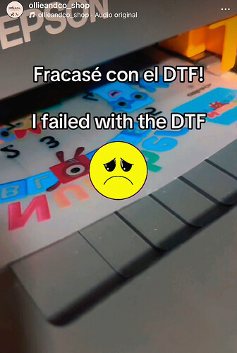

I failed with DTF
:sob: A really need the HTVRONT D1 DTF PRINTER! My 20 times trying was so bad! :smiling_face_with_tear::sweat_smile::sweat_smile::sweat_smile:
Can I ask a question and offer some advice? It looks like you didn’t put the adhesive powder on it and bake it before you actually put it on your garment? Also, if you did all of those things, did you let it cool before you tried to peel it off?
It “looks” like you forgot to apply the adhesive while the ink was wet (even if it is inkjet or sublimation ink) and then bake it before you heat pressed it to your garment.
If you didn’t do those things, do a test on one item and see how it goes following those steps.
I agree with what @Carla_Lawson suggested. It doesn’t look like you used the DTF powder, you still need to use this even if you are doing a sublimation DTF hack.

Thank you so much for your advice! My problem, One of them, I burned my film :sweat_smile: but I still trying so hard.
Because this I wish the HTVRONT D1 DTF PRINTER! :sob::joy:
I used the Powder but the film was burned. LOKLiK and HTVRONT will bring us pretty good things I’ m sure! :wink::upside_down_face:
Ok….so you don’t burn your film, after you dust it with the adhesion, just hover your heat press on it so the powder can cure. Don’t push it down, just let the heat melt the powder (adhere the glue to the film ) and then press to your garment. :smiling_face_with_three_hearts:
