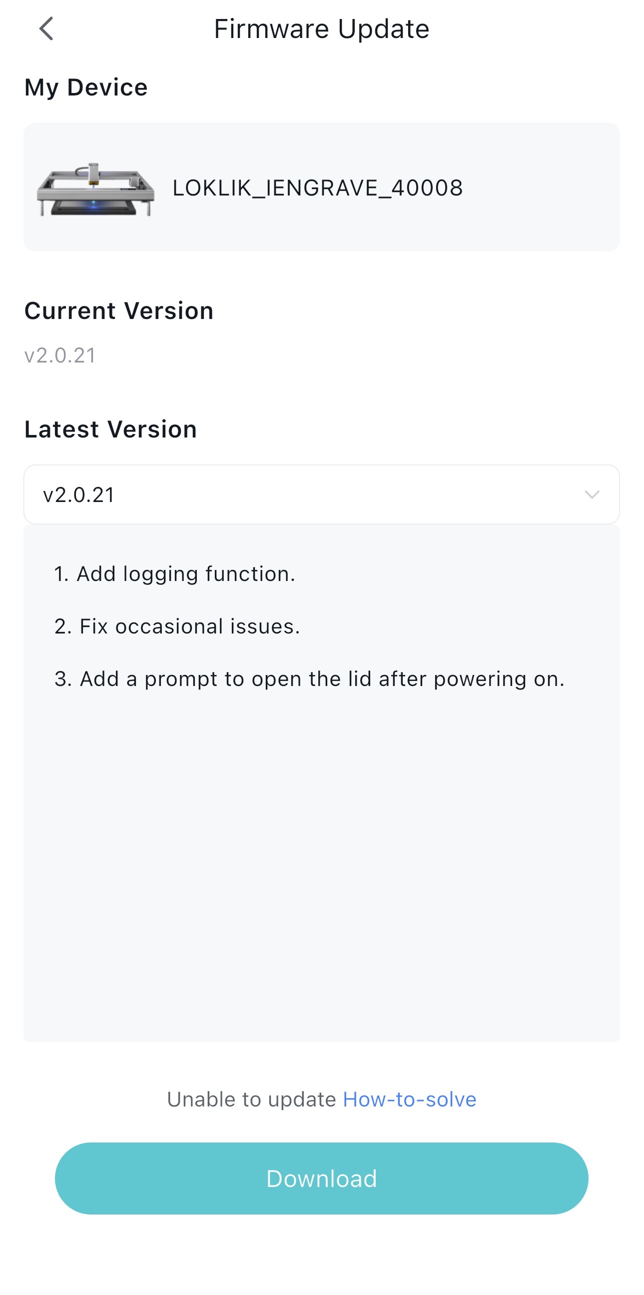

Hi and welcome to the community, @Rick_Goodman! I’m so sorry you’re running into this issue — I actually experienced the same thing. There’s a little trick to reconnecting your laser through the mobile app. For me, simply turning off my mobile data did the job. I’m sharing the link below for reference in case it helps you too. Please keep us updated! ![]()
