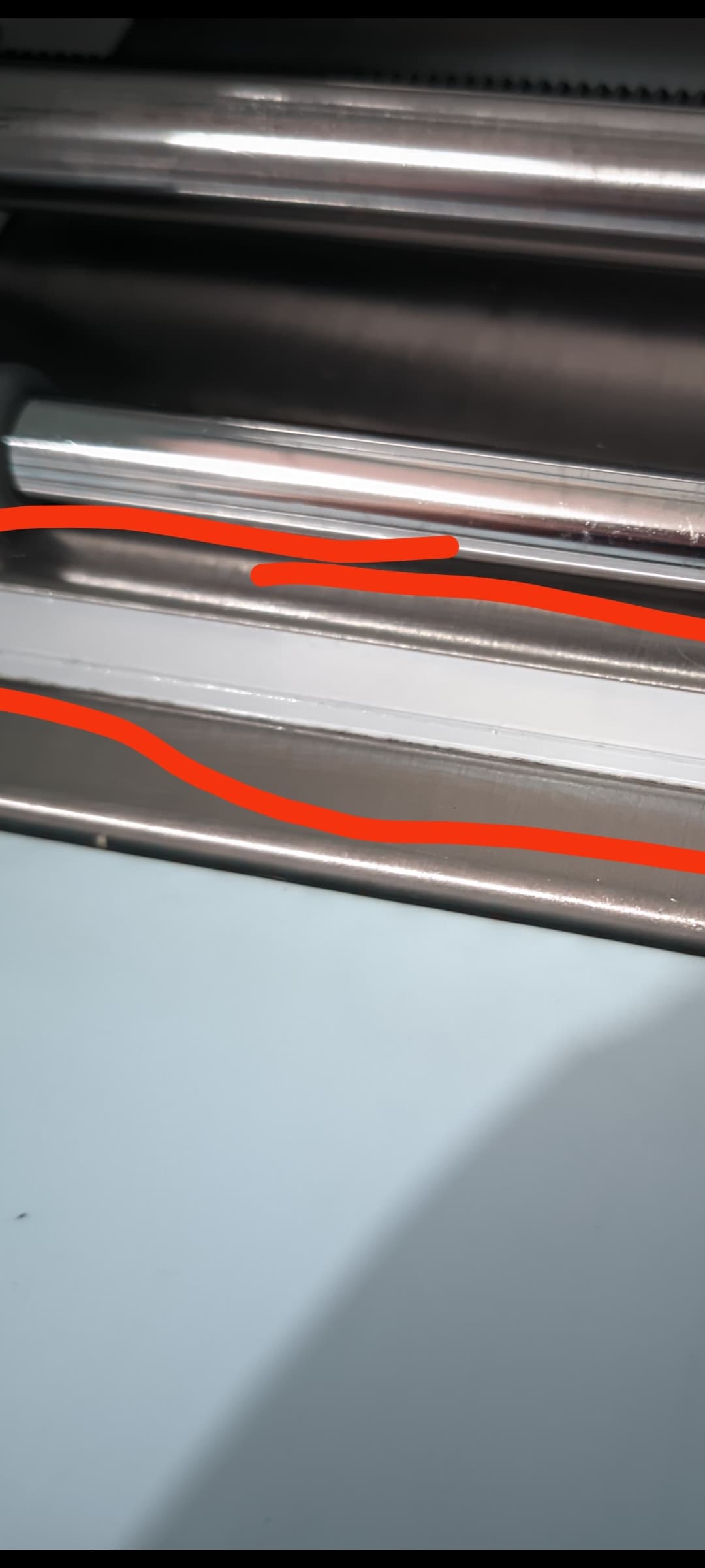

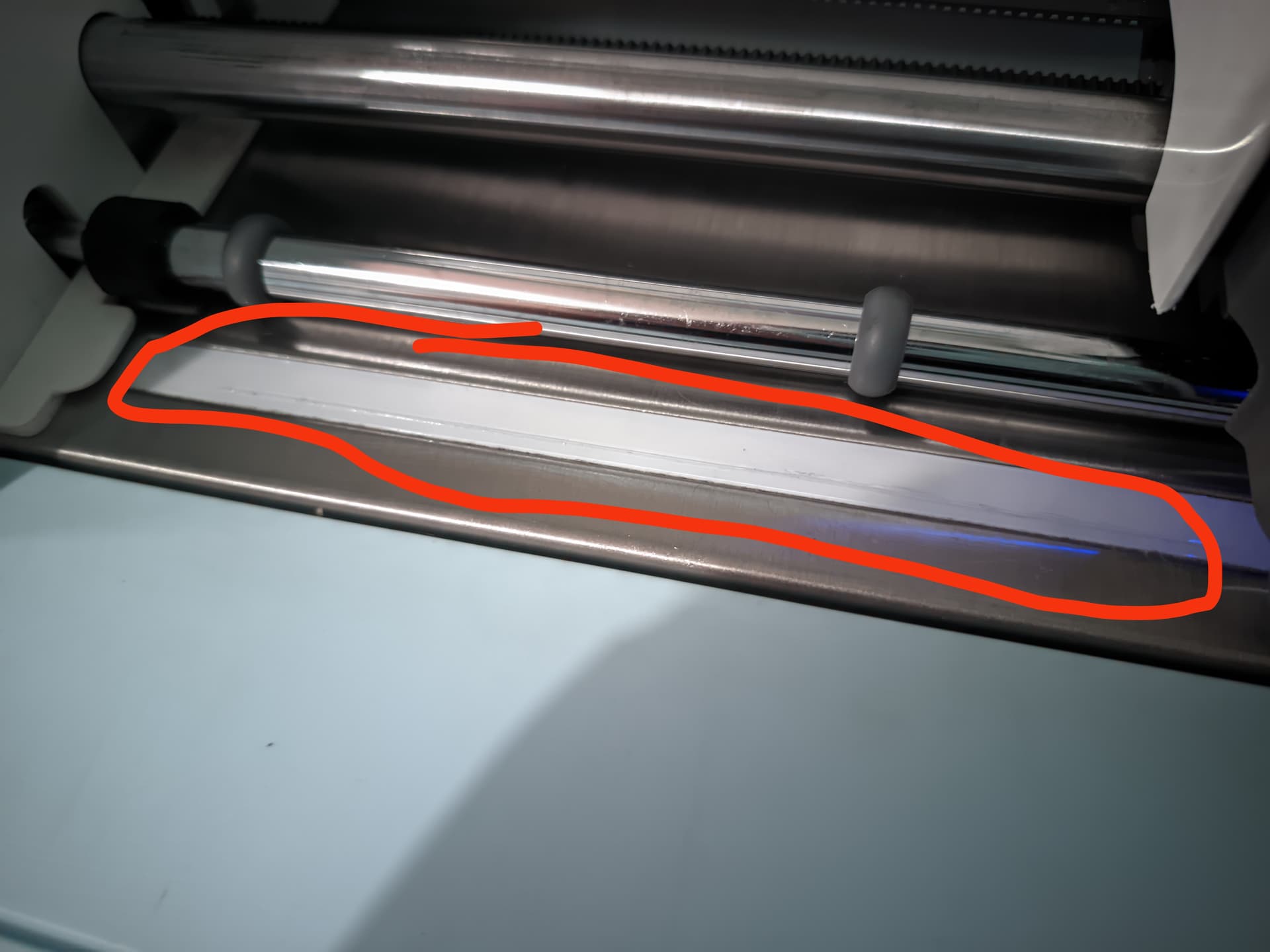

Hello @admin @admins , I’d like to ask if there are replacement parts for the iCraft? I noticed that this part shows wear and tear and I think it’s the culprit for my uneven cuts.
The left side isn’t being cut as deep as the right side.
I hope this can be fixed please :pray: send help @OliviaZzz @Elena @Jodie

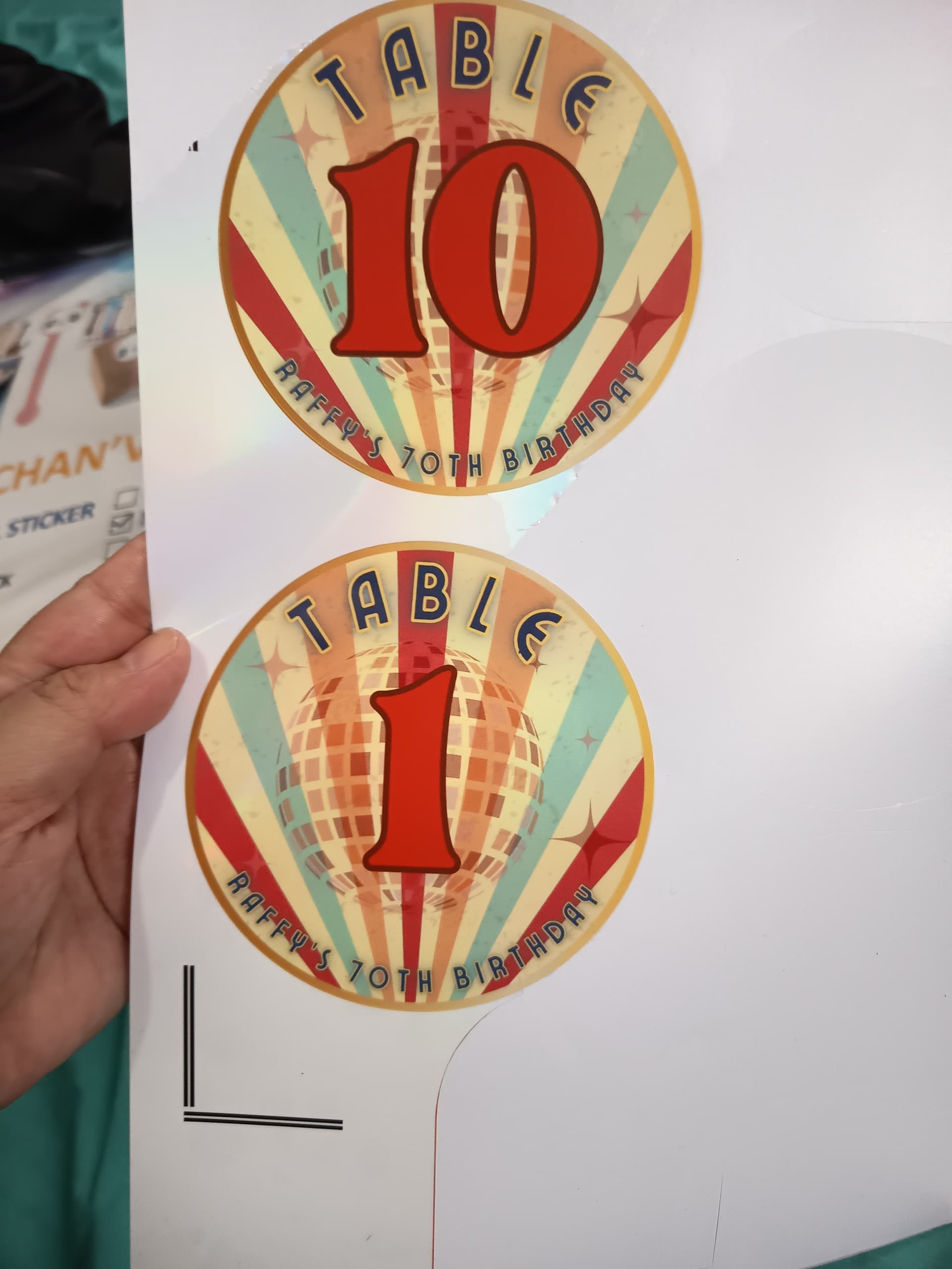

I do hope so. I am only able to cut well on the right side of the printing sheet huhu… had to manually cut the parts that were not fully cut buly the machine

@timmytation, that part looks a bit odd. How old is your iCraft for the wear and tear to be that visible? I haven’t seen anything like that—especially if you’re using a mat under the rolling pin. Hopefully there’s a quick resolution for it. :wink:
is it damaged, or lifts up i can’t quiet see what’s wrong, also I have recorded a video to send to support about the cuts not being even across from left to midle to right. so it may not be your part circled above, it might be the way the machine is currently cutting. Mine cuts best right down the centre at the 6" mark

In the white part that should be the cushion underneath the mat, there’s like a gouged out part.

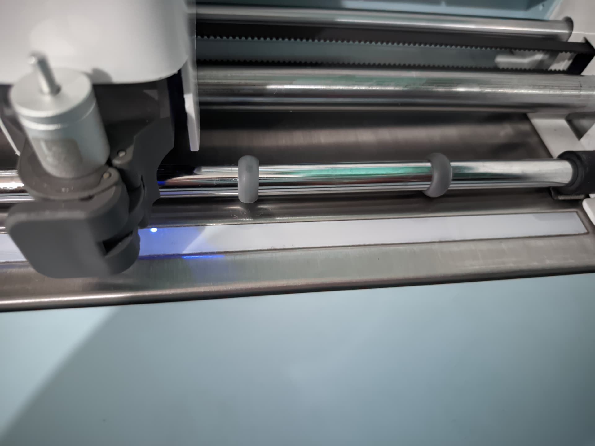

It’s not smooth like the right side of the cutting machine
oh I see now, thanks for the comparison, thats a mystery?
