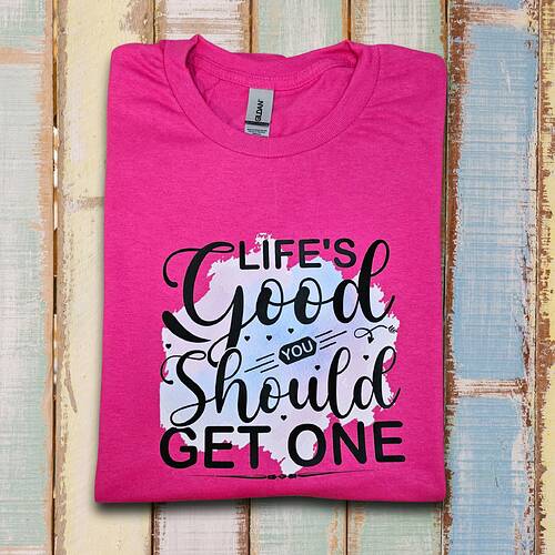

"Life's Good You Should Get You One" DTF Transfer Tee
This design was applied using a DTF transfer and pressed with the H10 Heat Press. I used a two-step application method: first, a 10-second press at 300°F followed by a cold peel. To seal the design and enhance durability, I placed a blank T-shirt over the transfer and pressed again for 10 seconds at the same temperature. This final step ensured a smooth finish without direct contact, preserving the vibrancy and texture of the print. The transfer adhered cleanly with no bubbling or lifting, resulting in a crisp, high-impact graphic ideal for casual wear or gifting.
This is not only beautiful and funky, it is also very funny :joy:
Thanks so much! :heart: I’m happy it made you smile. I thought it was funny, too.:laughing:
