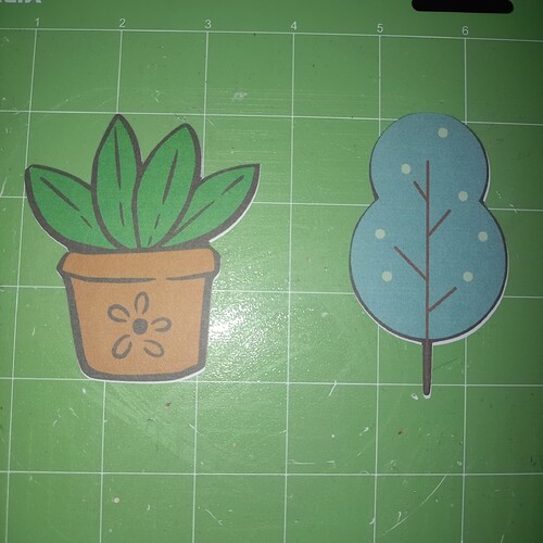

Is it me? Do you encounter like this when using print and cut on icraft? Cuts are not perfect. Do you have any suggestions on how to fix it??
Me too, I have that shadow at the bottom
I’ll try calibrating again tomorrow
Try collaborating with the machine again—sometimes it takes a few attempts to get that perfect cut. Be sure you’re in a well-lit area, as proper lighting plays a crucial role in the process. The sensors can have trouble detecting the marks in dim environments, so good lighting ensures a smoother collaboration. Keep at it, and you’ll nail it!
Yes, I’ll try that tomorrow. Right now I should sleep, it’s 1am in our side of the world :sweat_smile::sleeping::sleeping:
oh yeah let me know how you get on, and defo get some sleep and come back on here :slight_smile:
Ohh I’ll try to do it on well-lit area. Thank you
Your welcome, if you need any more help let me know x
So I tried your suggestions and there you go almost perfect cut! I have v3 firmware because I can’t firm ware update🥲 but anyways, thank you 🩷
Oh wow it looks perfect x well done
