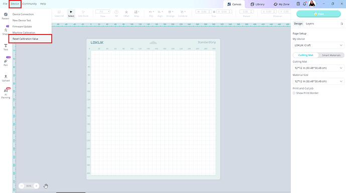

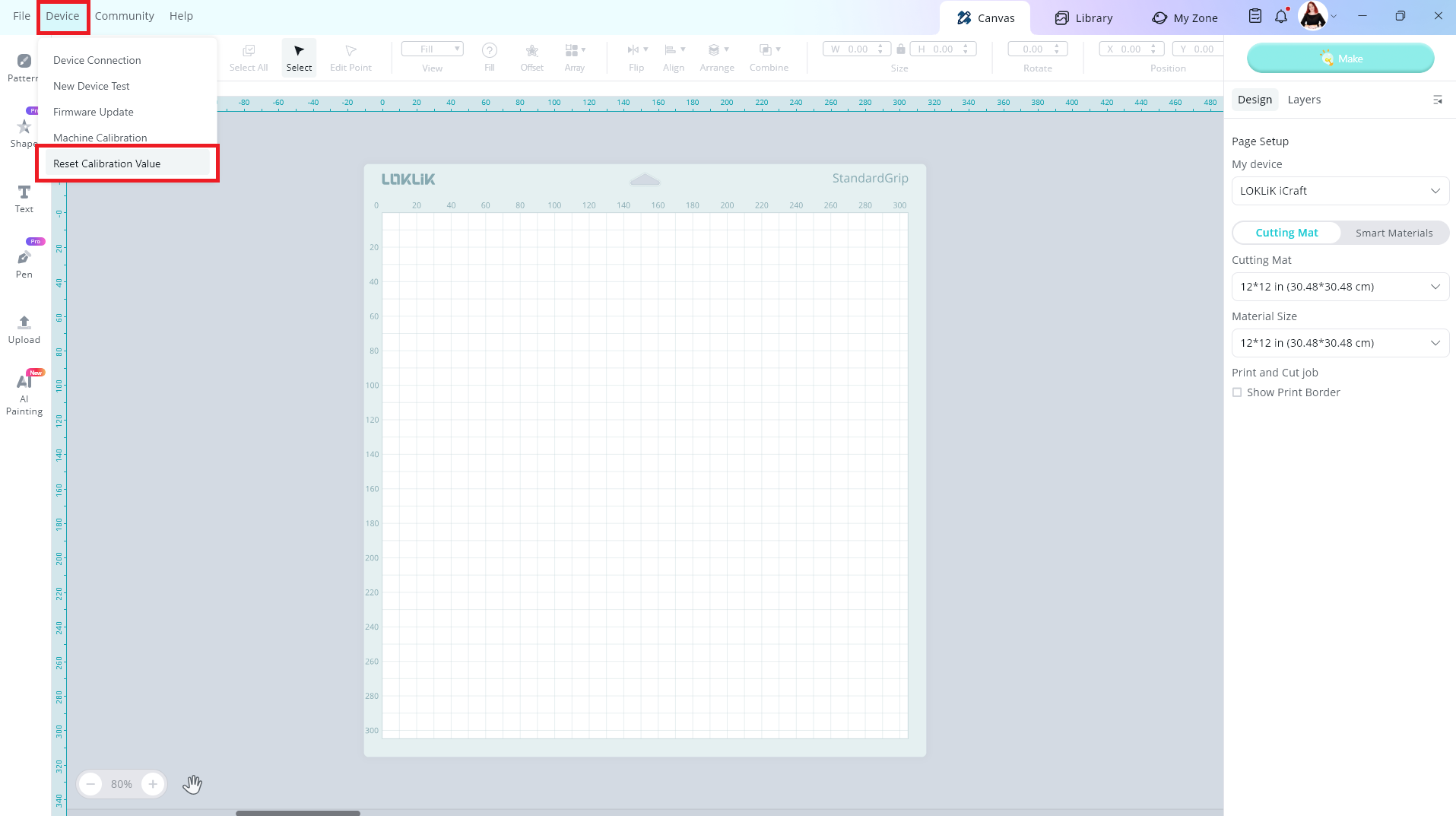

@InkiteeWorkshop has you covered how. But just wanted to also add that if you have done 5 or more calibrations in a row and it keeps cutting off you may want to reset your calibration. This will let your machine start calibrating from scratch again and you will get better results.
To do this go here
perfect add thanks @Bellethehowtoguru
