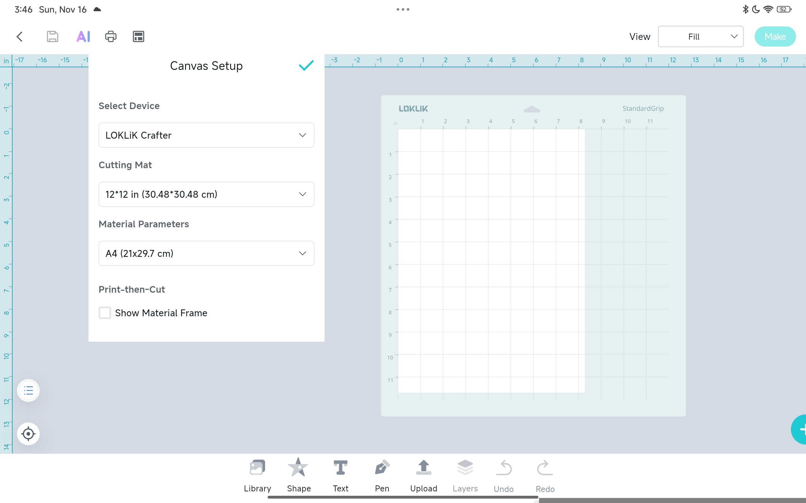

Hi guys, maybe someone can help me with this issue, I updated my Loklik studio in my Tablet and then i started getting an issue with material parameter.

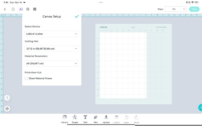

I have an icraft but when i choose the A4 parameter, it doesn’t dim the part of the canvas.

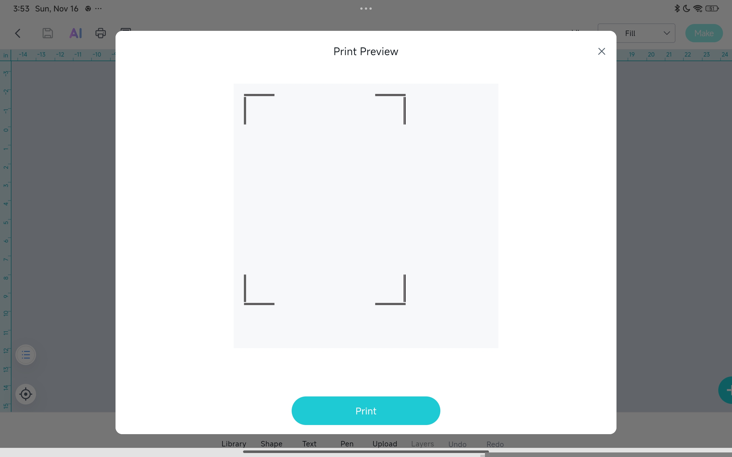

when i tried printingit, it captures the whole Matt. I tried all possible troubleshooting steps i can think of such us restarting my device and clear cache/data.

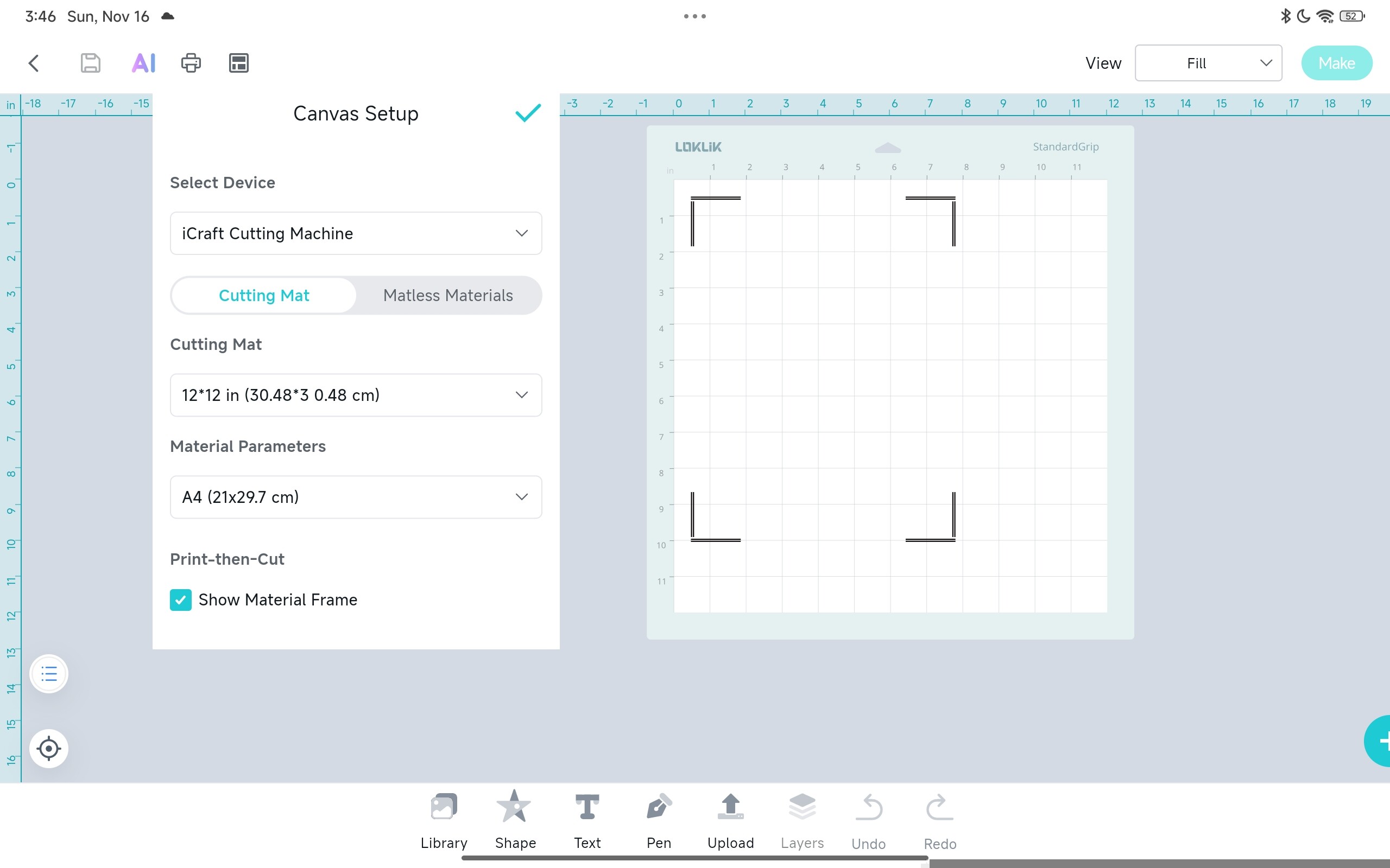

However, what i notice is that, it shows if i choose the crafter as device. Is this a bug or something?
By the way, I don’t want the material frame to be printed as well so I’m planning to print it before actually proceeding with “MAKE” button.

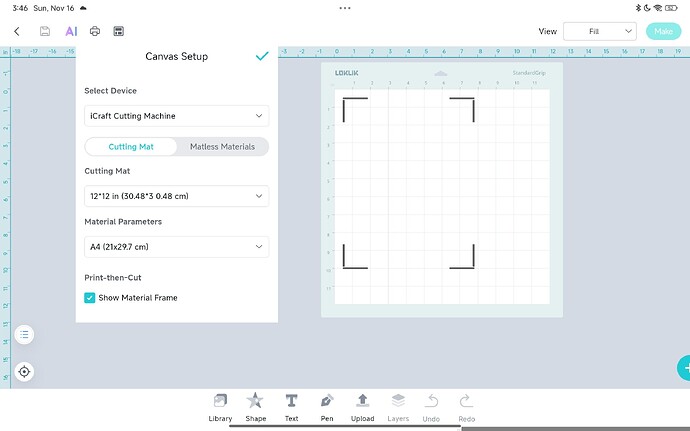

I’ve been able to reproduce the problem, so I guess it is a version bug. You can report it. While they fix it, you can just place a white rectangle 210x297mm.
Are you making a Print then Cut without registration marks?
Hi thank you! Then i guess that’s the best alternative at this point.
