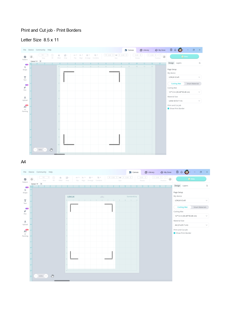

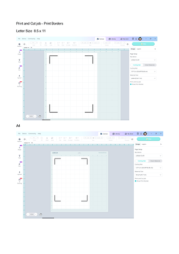

I was a little puzzled by the position of the print borders. It seems a lot of the page is wasted.
I had some HTVRONT vinyl print sheets come and noticed the size was different to the A4 I normally use. it is Letter size.
In the studio you can select the paper size and when you compare the print borders for the two sizes it make more sense.
The right side and bottom borders are set for the smallest dimensions of the two paper sizes. The narrower A4 and the shorter Letter.
Which ever size paper you use then there will be a margin that is too wide.

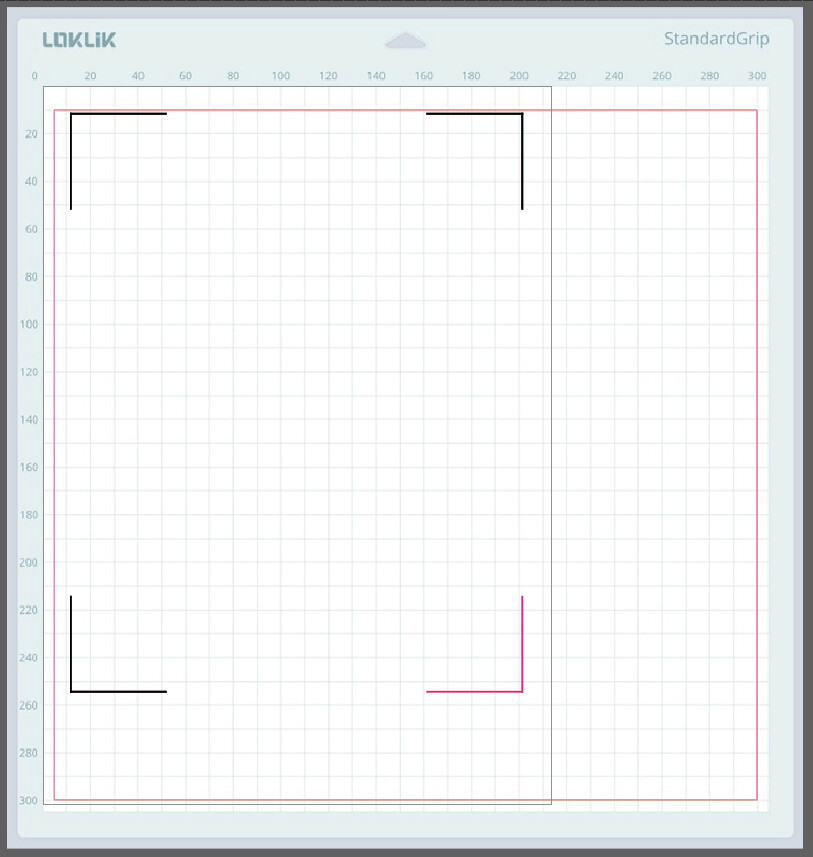

I think it’s just the bottom right that doesn’t get scanned.
I think you can print outside the registration marks.
Yes, the right bottom mark does nothing there, that’s why I print outside IS without that mark and use all that space without any problem.
And yes, tou can print outside the marks as long as the design is within the cutting limits, that you can see with the cut function red mark and inside the A4.

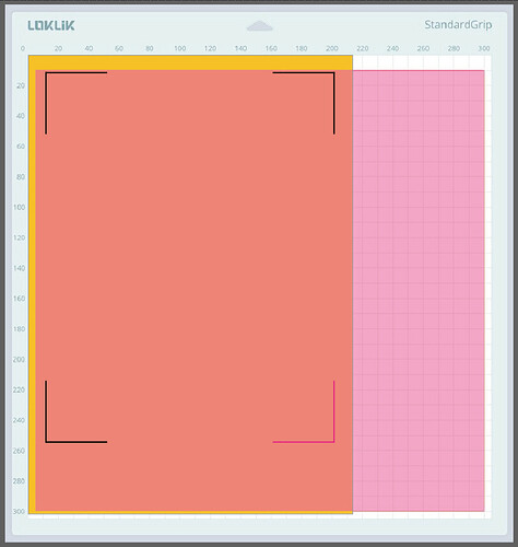

You can print in the orange area:

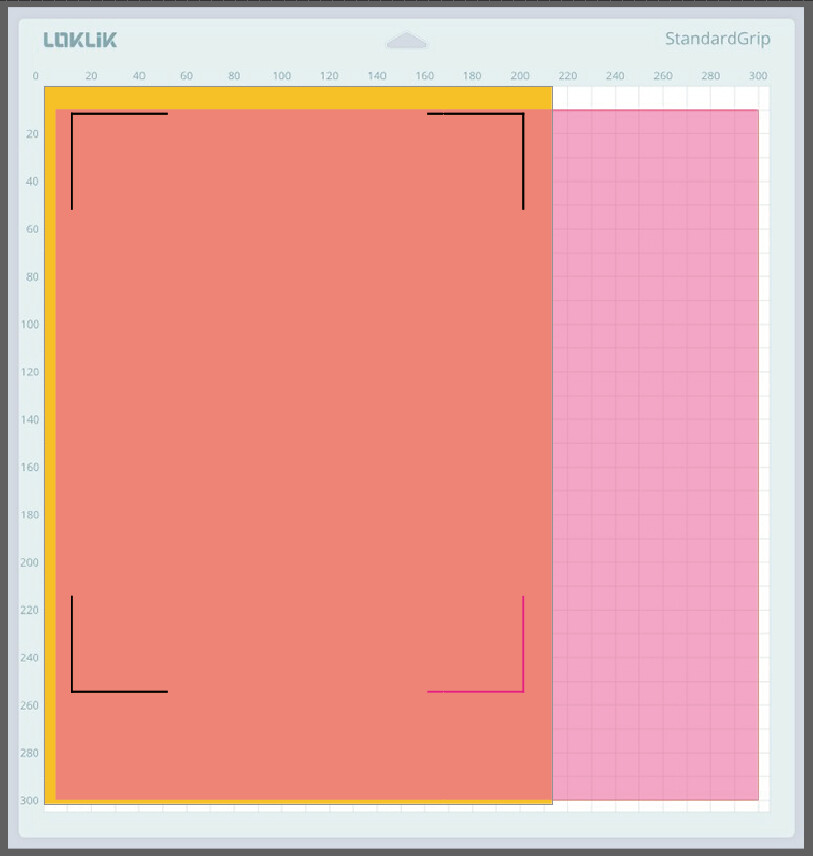

Ok, I decided to ignore the registration marks and tried this. It cut every single one of those without a problem.
