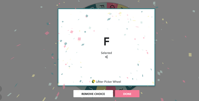

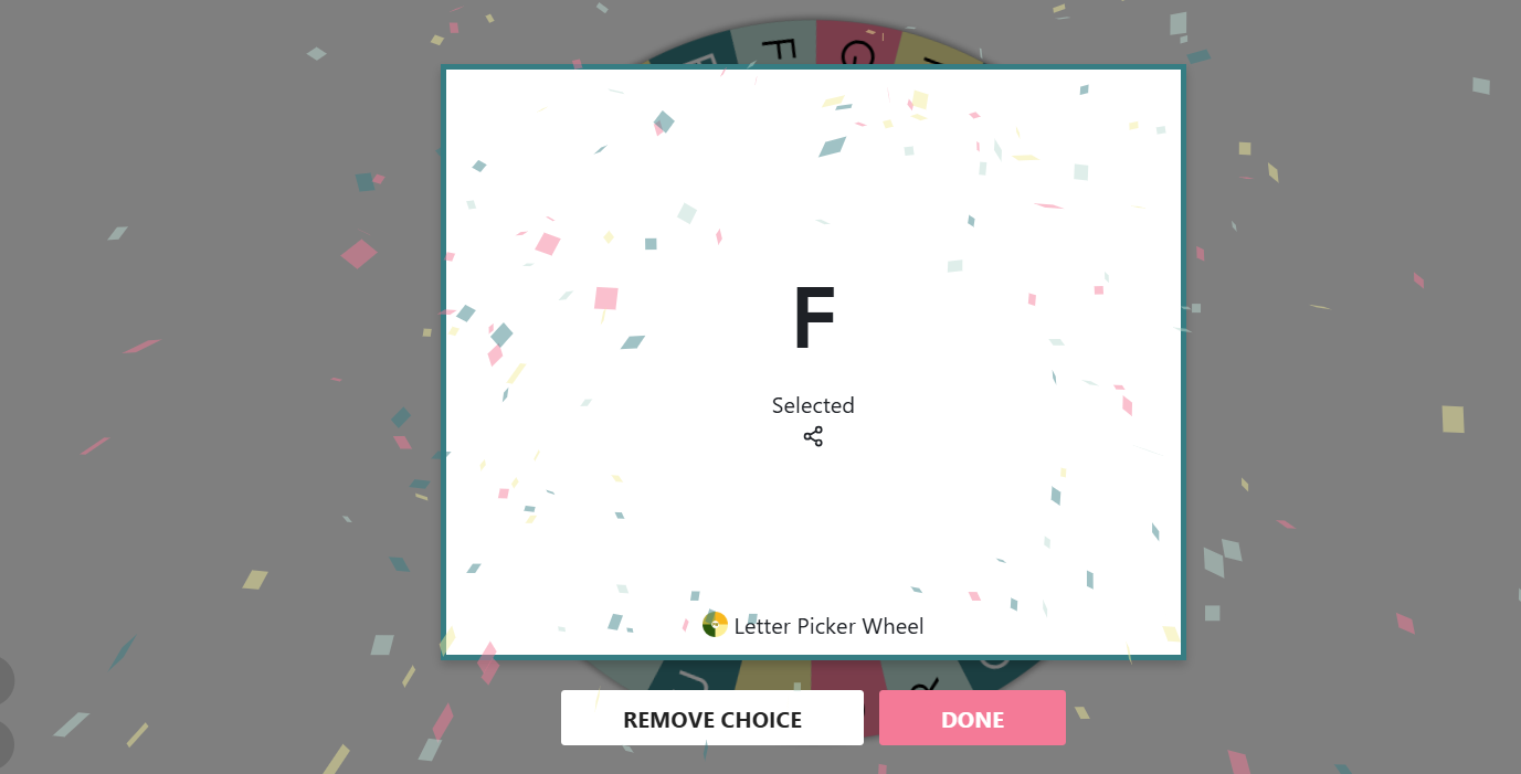

Congratulations, Summoner! You’ve summoned Rune [F]!
