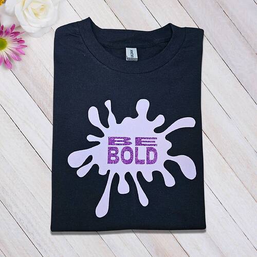

This design was built in IdeaStudio using Loklik fonts and a splatter element from the library. I duplicated the BE BOLD text, and placed one of them on top of the splatter, then, used the “Subtract” function to cut the phrase out of the splatter element. The phrase “BE BOLD” is layered with HTVRont glitter HTV (bottom layer) and puff HTV (top layer). I pressed both layers with the H10 Heat Press, which worked fabulously. Both materials weeded cleanly with minimal resistance. I applied a 5-second tack press to the glitter layer at standard glitter HTV temperature, followed by a full press on the puff layer to activate its expansion and texture. The puff adhered smoothly over the glitter without distortion, resulting in a raised, dimensional finish with crisp edges and vibrant contrast. The final effect combines sparkle and texture for high visual impact and tactile interest.
Love it.
Thanks! :heart: I’m glad you like! :smile:
