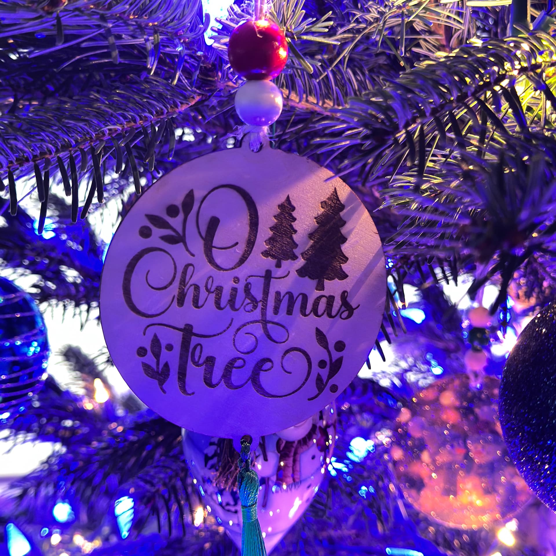

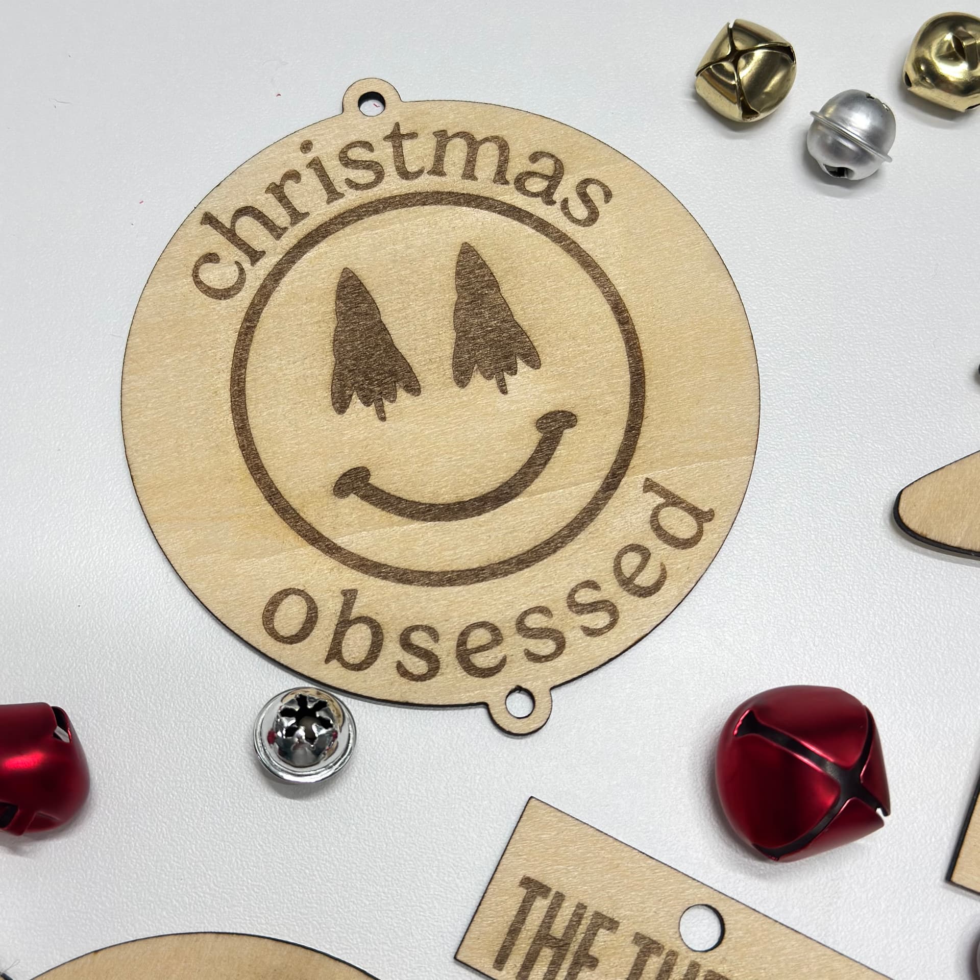

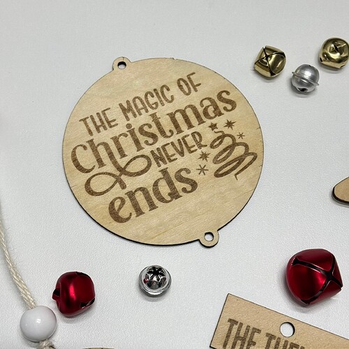

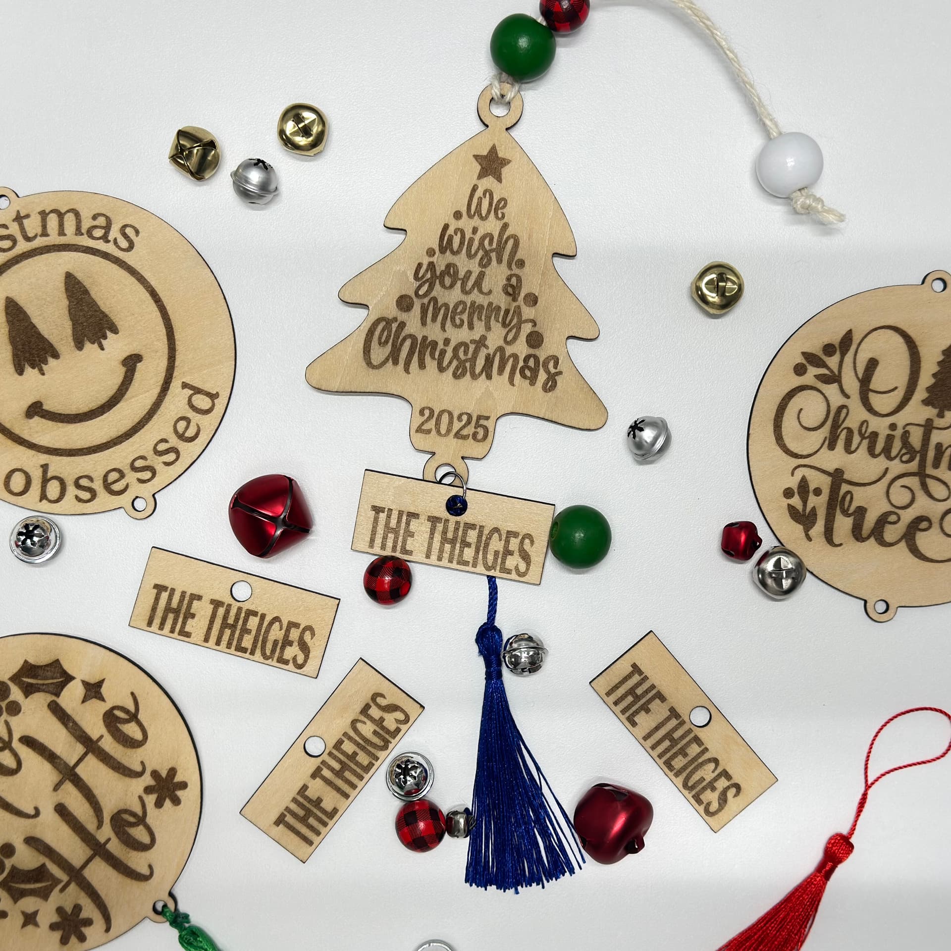

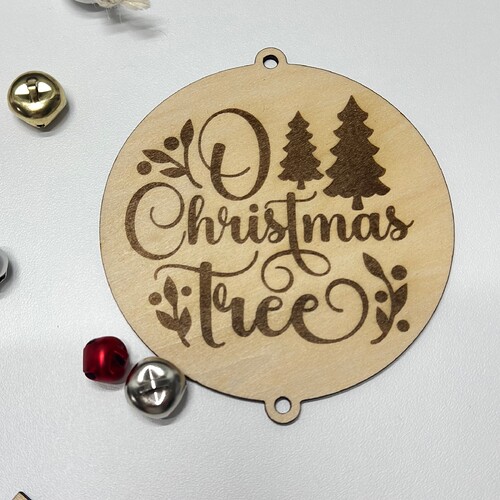

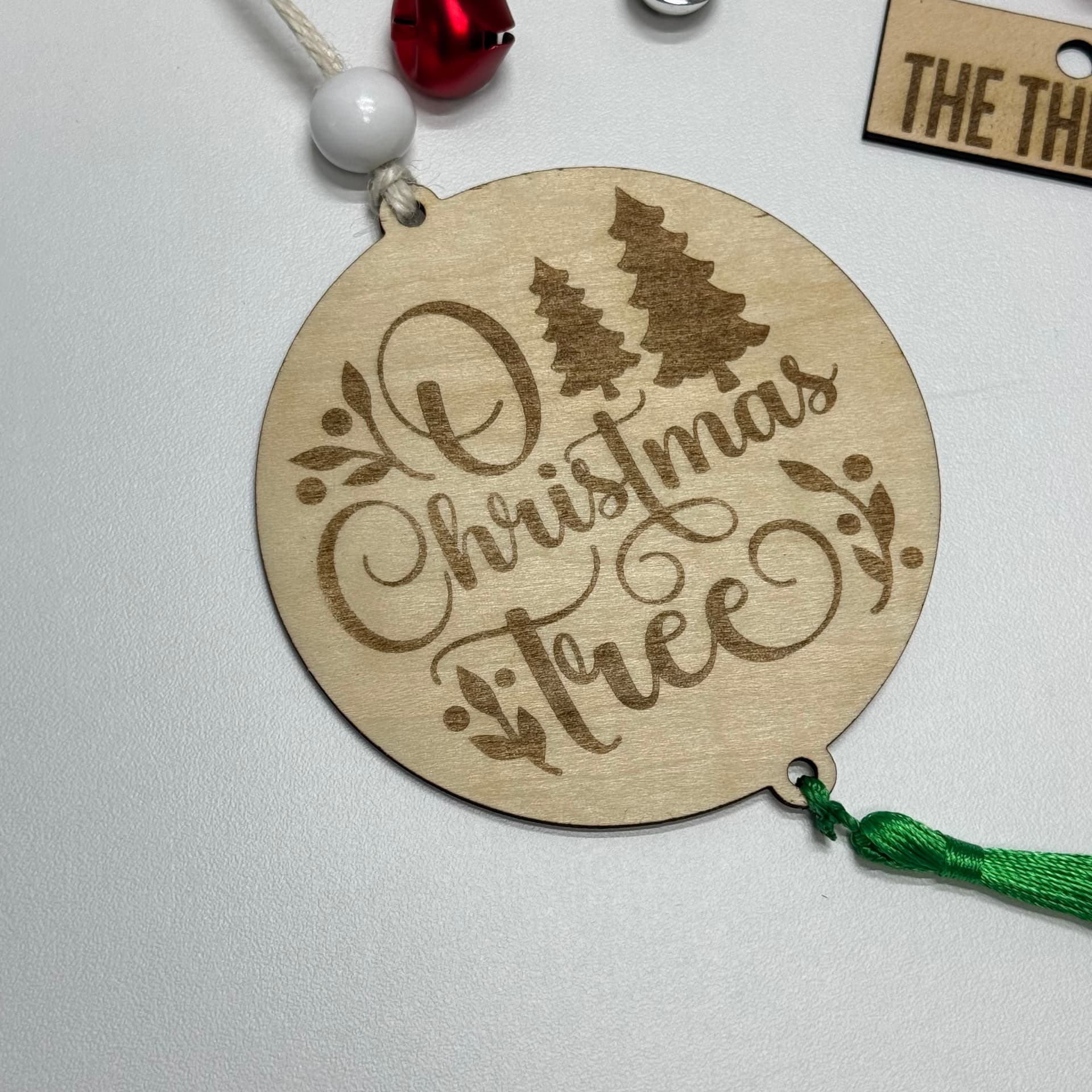

Here’s another set of wood ornaments I made with my iEngrave Machine—reversible round Christmas designs! :christmas_tree: I engraved patterns from the IS Library and added our last name using the Aclonica font inside a small rectangle for that personalized touch. You can dress them up even more with wooden beads, tassels, or bells to make each ornament uniquely festive.
Wishing you all a very Merry Christmas!
SOFTWARE USED: IS Desktop Version
MACHINE USED: LOKLiK iEngrave Cover Machine
MACHINE SETTINGS:
A - Engraving the Designs
Engraving Mode: Flat
Operation Style: Engrave
Mode Style: Line; Fill
Material: 3mm basswood
Power: 85%
Speed: 7500 mm/min
Passes: 1
Time: 1 hour and 7 minutes
B - Cutting the Ornaments
Operation Style: Cut
Mode Style: Line
Power: 100%
Speed: 230 mm/min
Passes: 1
Time: 13 minutes and 45 seconds
MATERIALS USED:
🩷1 pc. 12" x 12" basswood boards
🩷100% jute cord
🩷Wooden Beads (optional)
🩷Tassels
FINISHED SIZE: circle 4" x 4", 5.16" x 3.82" and 4" x 4.44"
NOTE: All my designs were came from the IdeaStudio Library.
