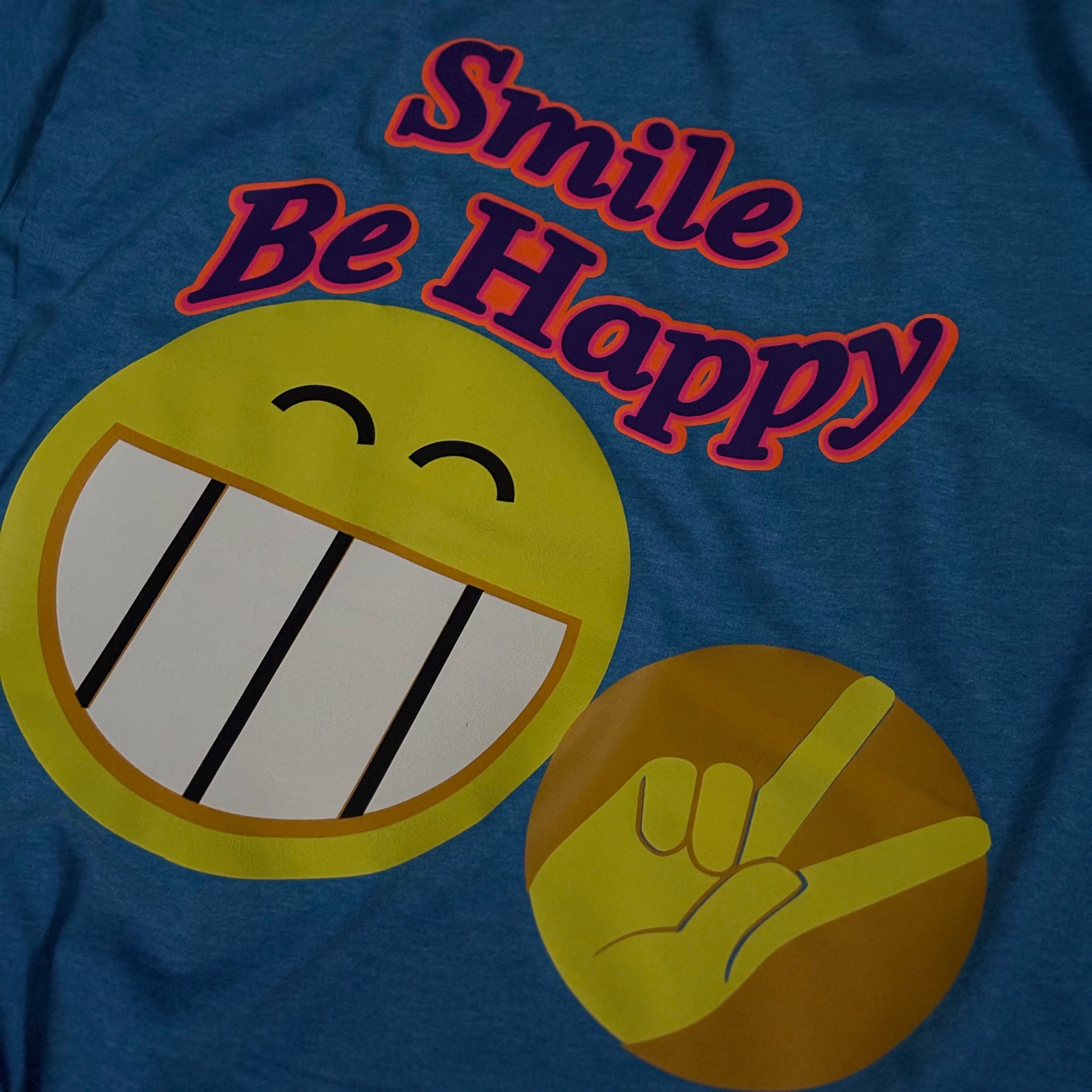

This playful design pops like a burst of sunshine on water . Set on a Gildan Softstyle aquamarine blue tee, the look features a bold, oversized grin emoji paired with a hand gesture emoji, radiating pure good vibes. Above it, the phrase “Smile Be Happy” arches in a chunky, layered font with vibrant contrast, giving it that clean, sticker-like finish. It’s cheerful, eye-catching, and perfect for everyday positivity wear.

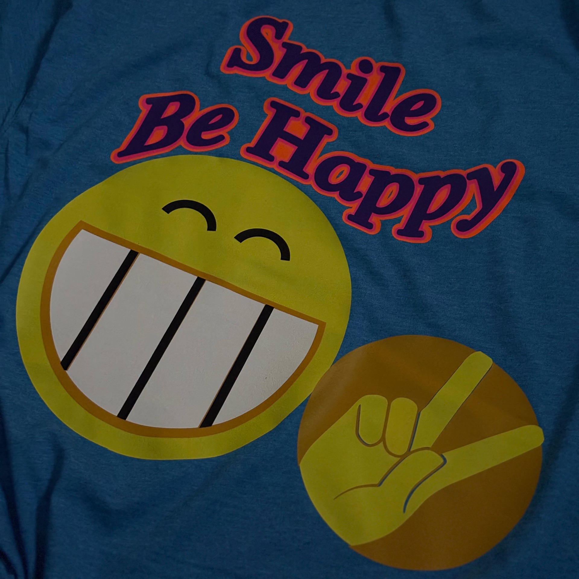

Design Setup (Ideal Studio):
  1. Upload or recreate the smiley + hand icons and text.
  2. Use the layer/block feature to stack colors (outline, base, details).
  3. Size design approx. 10–11 inches wide for adult tee.
  4. Mirror all layers before cutting.
Cutting (iCrafter):
  1. Load HTV shiny side down.
  2. Select correct material setting for HTVRont vinyl.
  3. Cut each color layer separately.

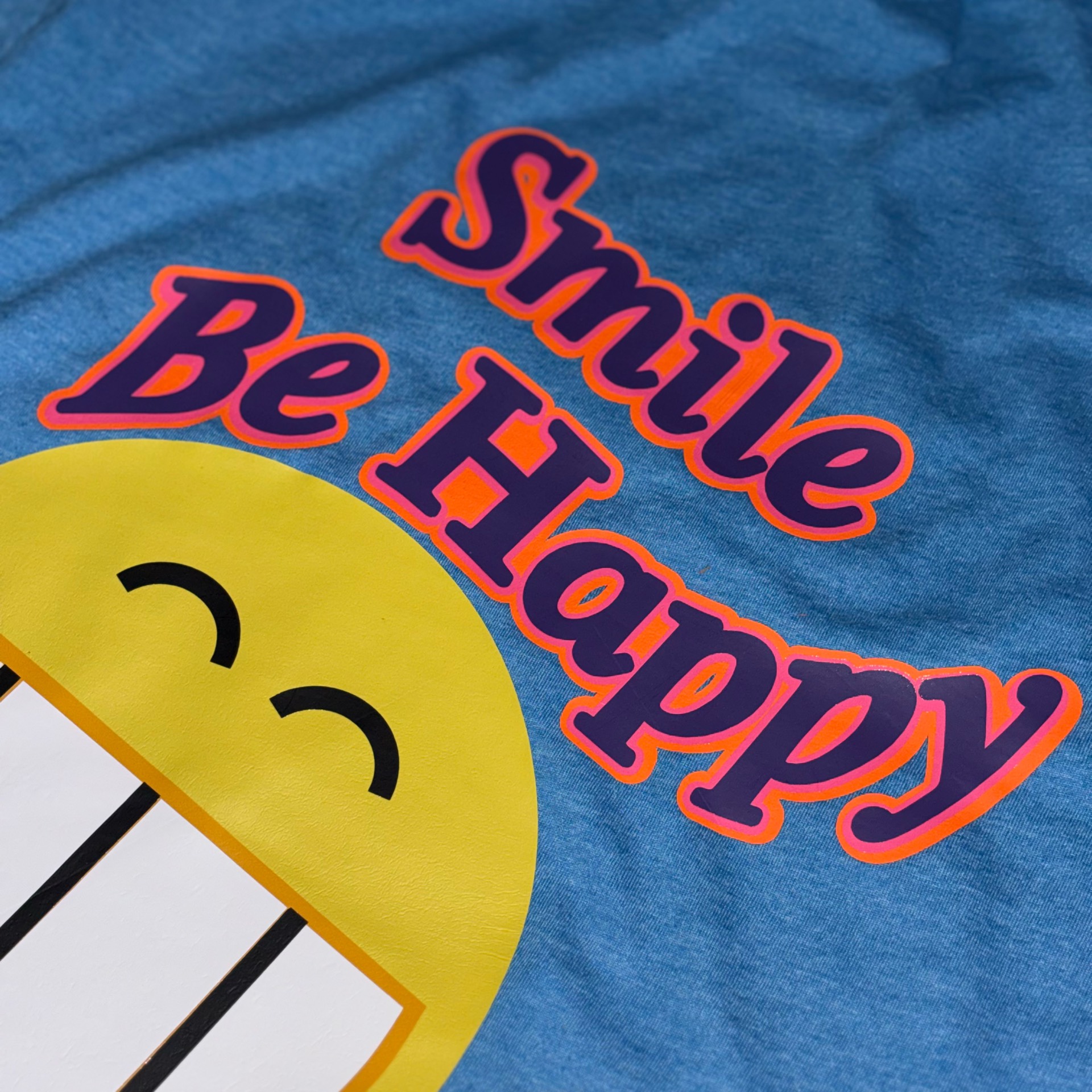

  4. Weed excess vinyl carefully, keeping fine lines clean.
Layering Tip:
Start with base layers (yellow face, hand circle), then add details (teeth, outlines, text).

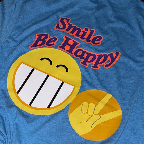

Heat Press Steps:
  1. Preheat press to 305°F.
  2. Pre-press shirt for 5–7 seconds to remove moisture.
  3. Position first layer, press 10–12 seconds.
  4. Peel warm or cool depending on HTV instructions.
  5. Continue layering, pressing each for 5–8 seconds.
  6. Final press with Teflon sheet for 10–15 seconds.

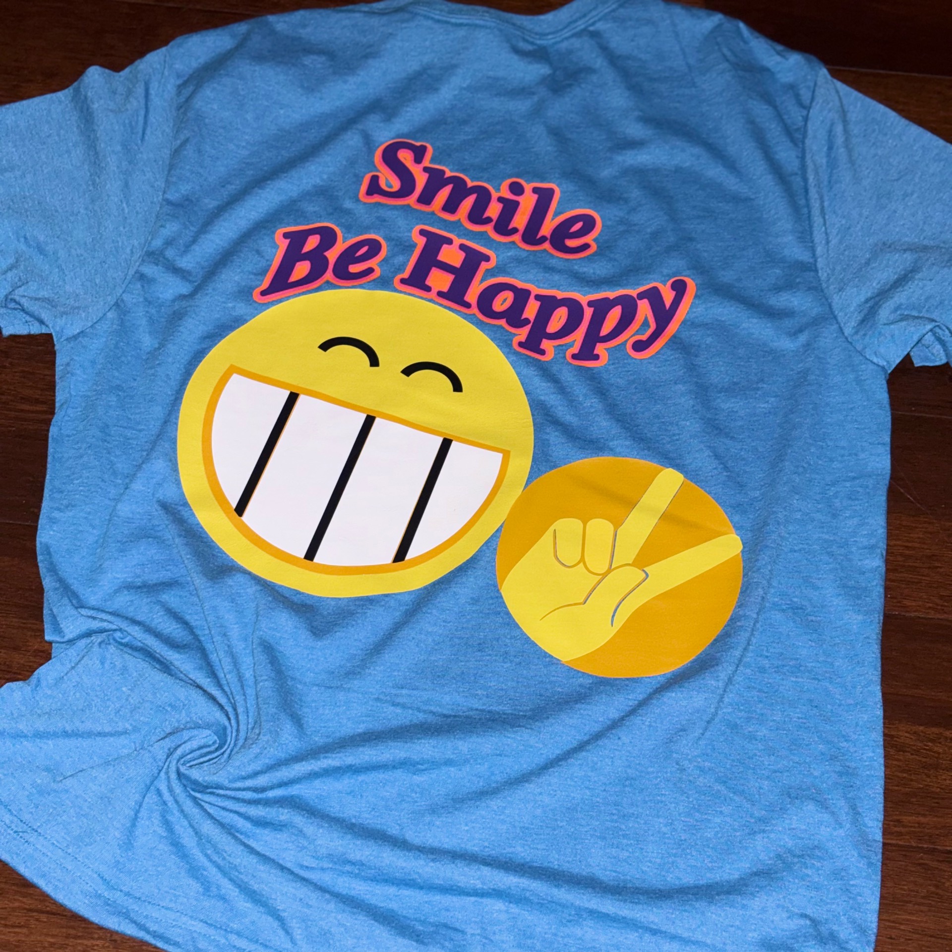

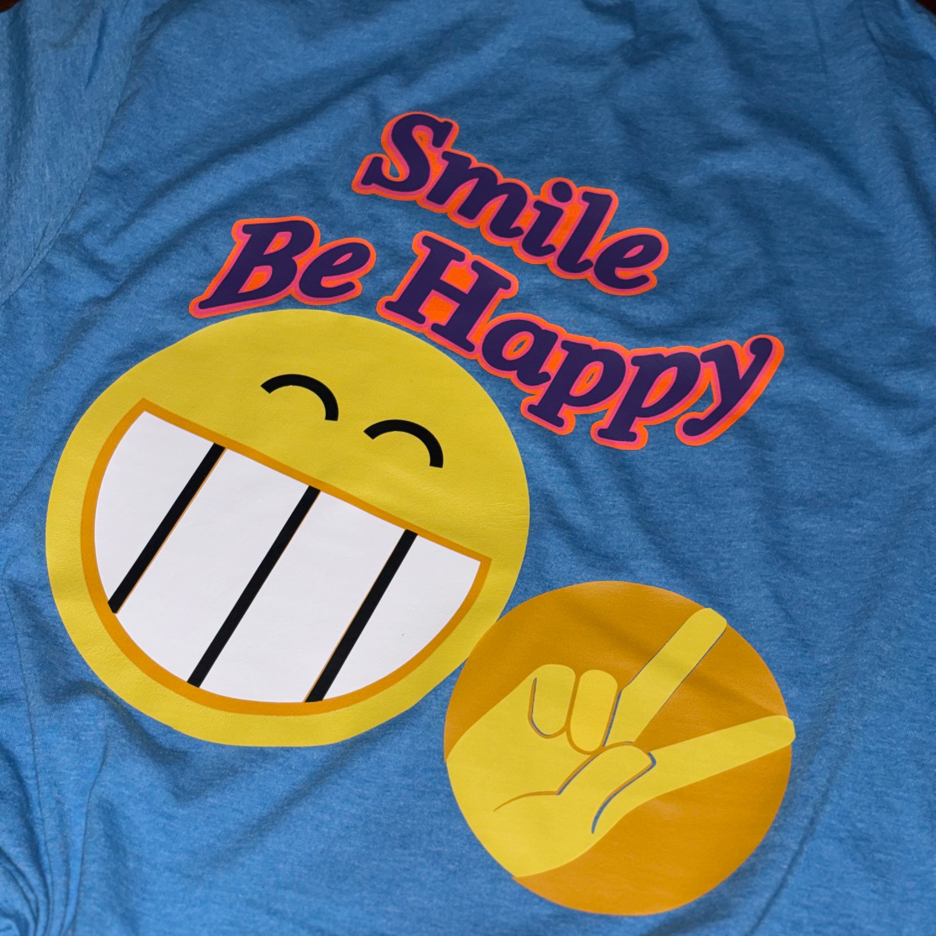

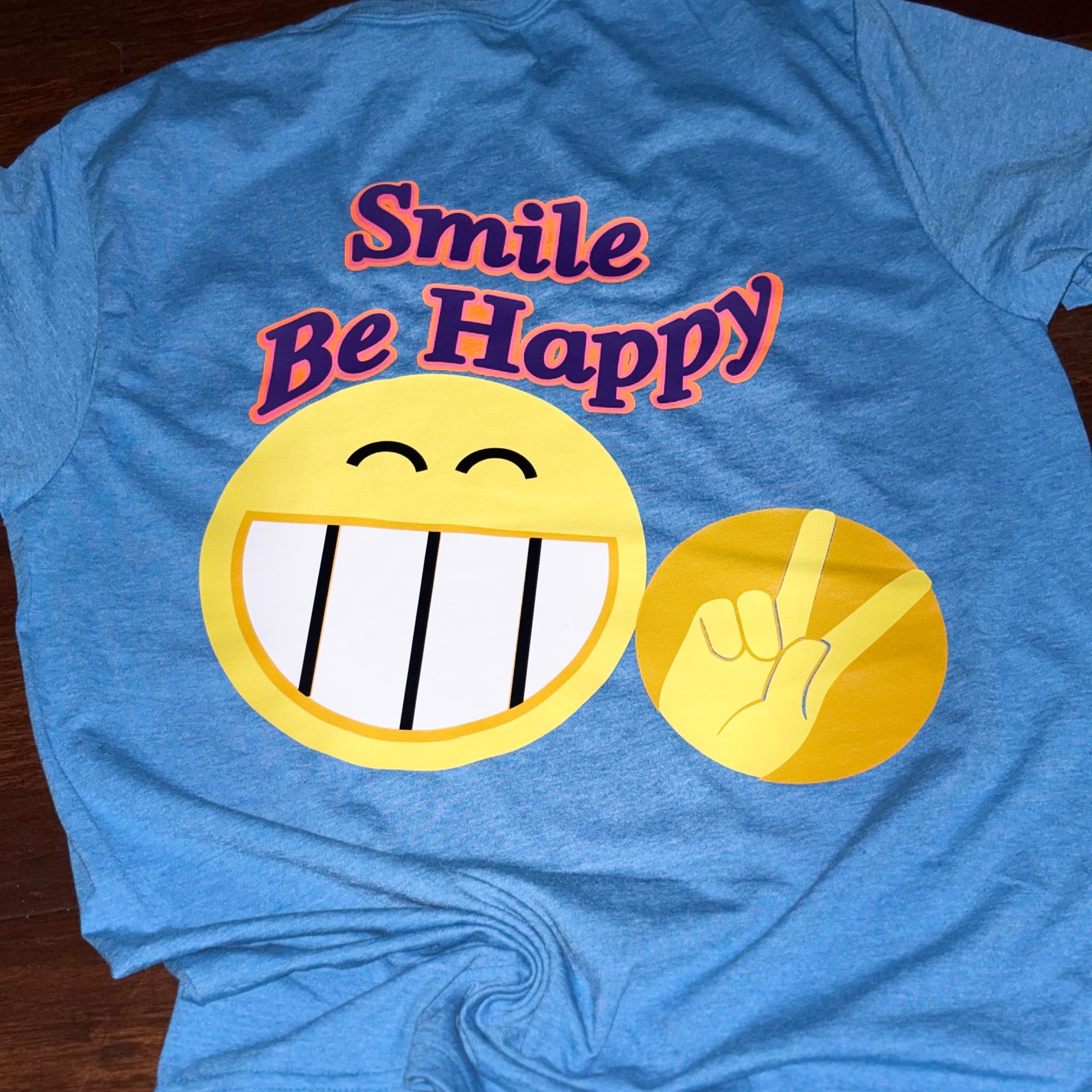

Finish:
Let cool completely. The result is a smooth, vibrant, multi-layered design that feels as good as it looks, like a wearable little mood boost
