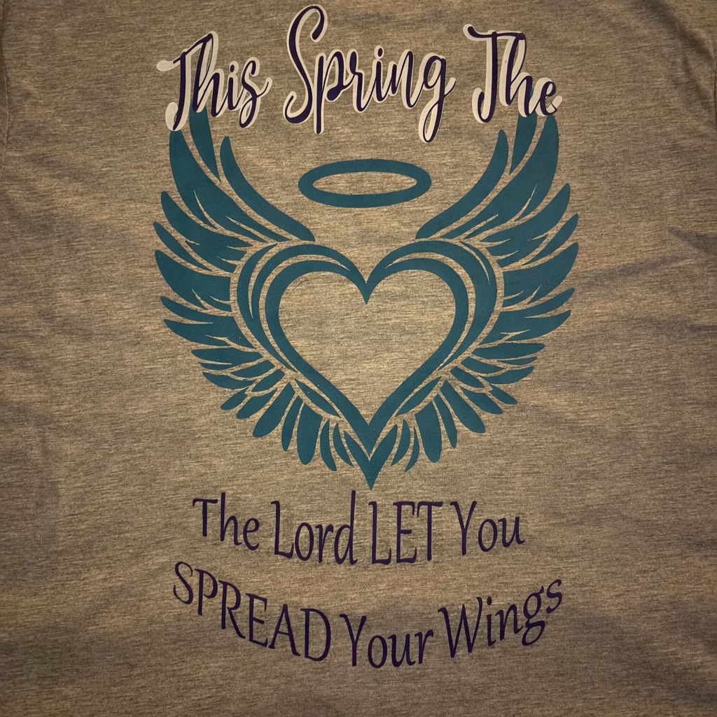

Project | This Spring the Lord let you spears your wings!

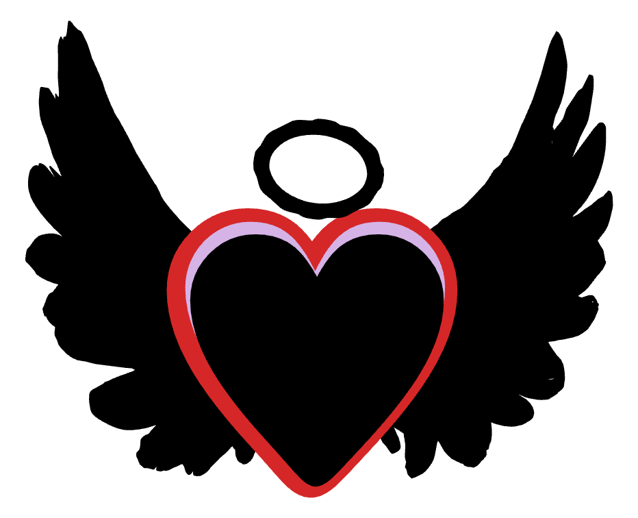

:scissors: STEP 1: Prep Your Design
1. Upload your design into your cutting software.
2. Resize it to fit your shirt (usually 10–12 inches wide for adults).
3. Mirror/flip the design horizontally
(This step is CRUCIAL for HTV—skip it and your words will come out backward like a mirror-world mishap :mirror:).

This is such a lovely design! It looks like you used HTV (heat transfer vinyl) to apply it to the shirt, rather than adhesive vinyl. Just a heads-up — adhesive vinyl is usually used on hard surfaces like mugs, cups, coasters, or wood. You might want to update your instructions to reflect HTV, so it’s clearer for anyone following along.
I didn’t use permanent it was definitely HTV! I’m so tired I will go back and correct it ! Thank you :blush:
No, it’s ok. Fix it whenever you can, get some sleep first if you need.
Thank you again friend ! I did go and fix it!
