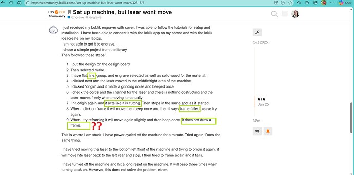

I just received my Loklik engraver with cover. I was able to follow the tutorials for setup and installation. I have been able to connect it with the loklik app on my phone and with the loklik ideacreate on my laptop.
I am not able to get it to engrave,
I chose a siimple project from the library
Then followed these steps/
  1. I put the design on the design board
  2. Then selected make
  3. I have flat, line, group, and engrave selected as well as solid wood for the material.
  4. I clicked next and the laser moved to the middle/right area of the machine
  5. I clicked “origin” and it made a grinding noise and beeped once
  6. I check the cords and the channel for the laser and there is nothing obstructing and the laser moves freely when moving it manually
  7. I hit origin again and it acts like it is cutting. Then stops in the same spot as it started.
  8. When I click on frame it will move then beep once and then it says frame failed please try again.
  9. When I try reframing it will move again slightly and then beep once. It does not draw a frame.
This is where I am stuck. I have power cycled off the machine for a minute. Tried again. Does the same thing.
I have tried moving the laser to the bottom left front of the machine and trying to origin it again. it will move hte laser back to the left rear and stop. I then tried to frame again and it fails.
I have turned off the machine and hit a long reset on the machine. It will beep three times when turning back on. However, this does not solve the problem either.
I do not know what to do with this machine from here!
