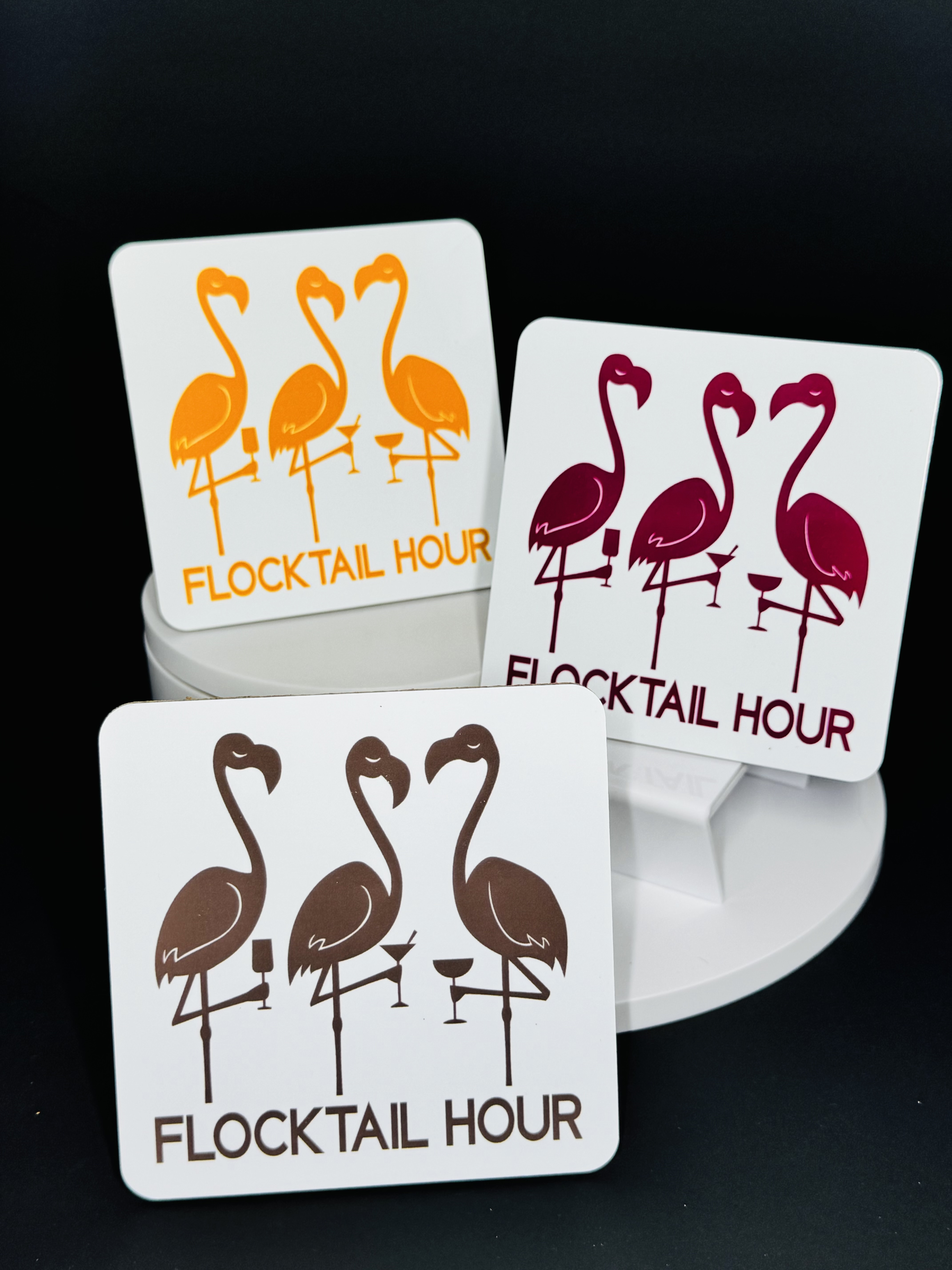

For these types of coaster which are aluminum on top with a cork backing, I do a temperature of 400F with 50 pounds of pressure for 40 seconds. These require less time because the aluminum is a natural heat conductor and will help sublimate faster.

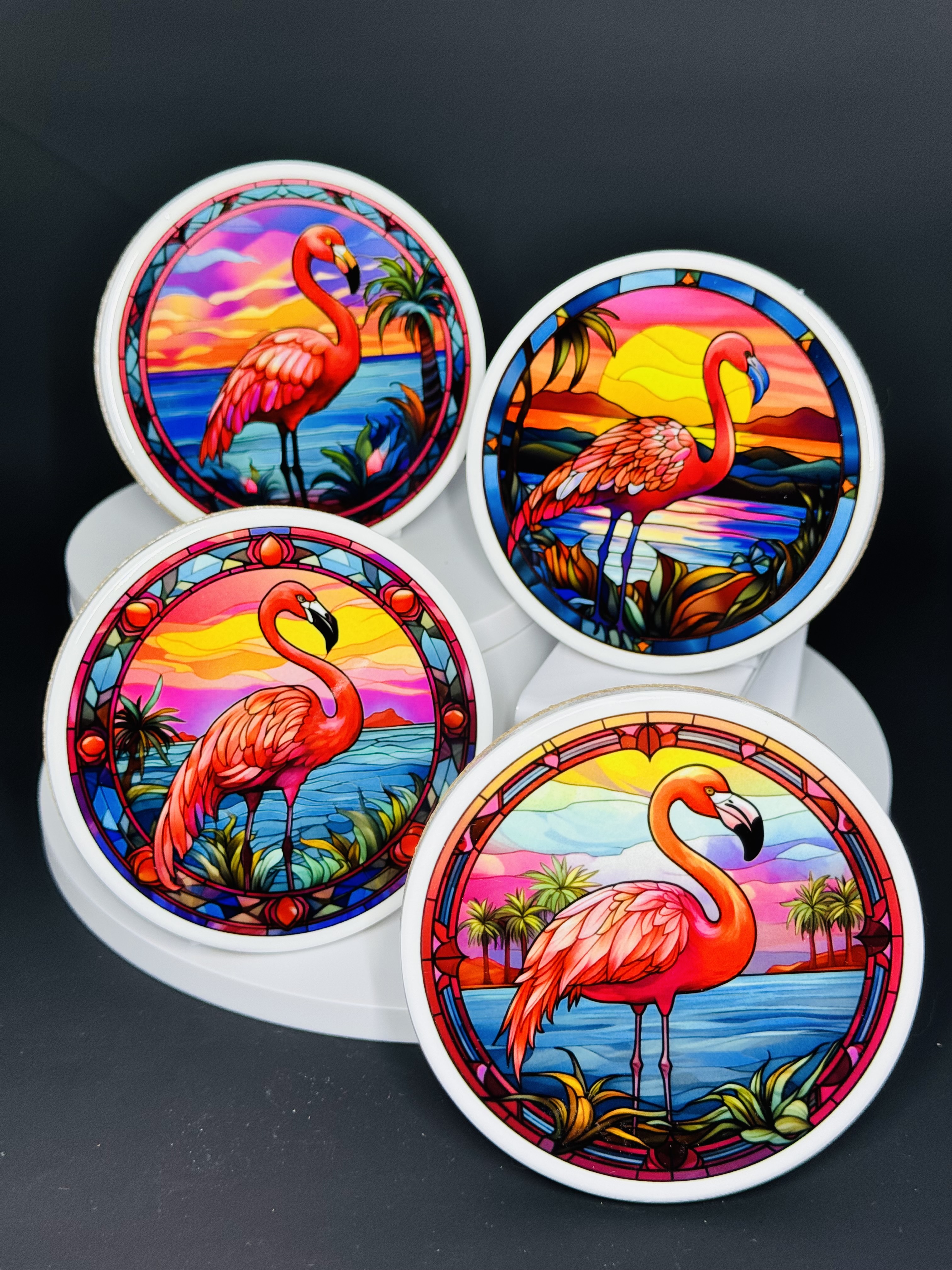

For these types of coasters that are ceramic coasters with no backing, I do a temperature of 400F with 50 pounds of pressure for 240 seconds. These require more time because ceramic, by default, is not a great conductor of heat. So it will take longer to heat these up to get them to sublimate correctly.

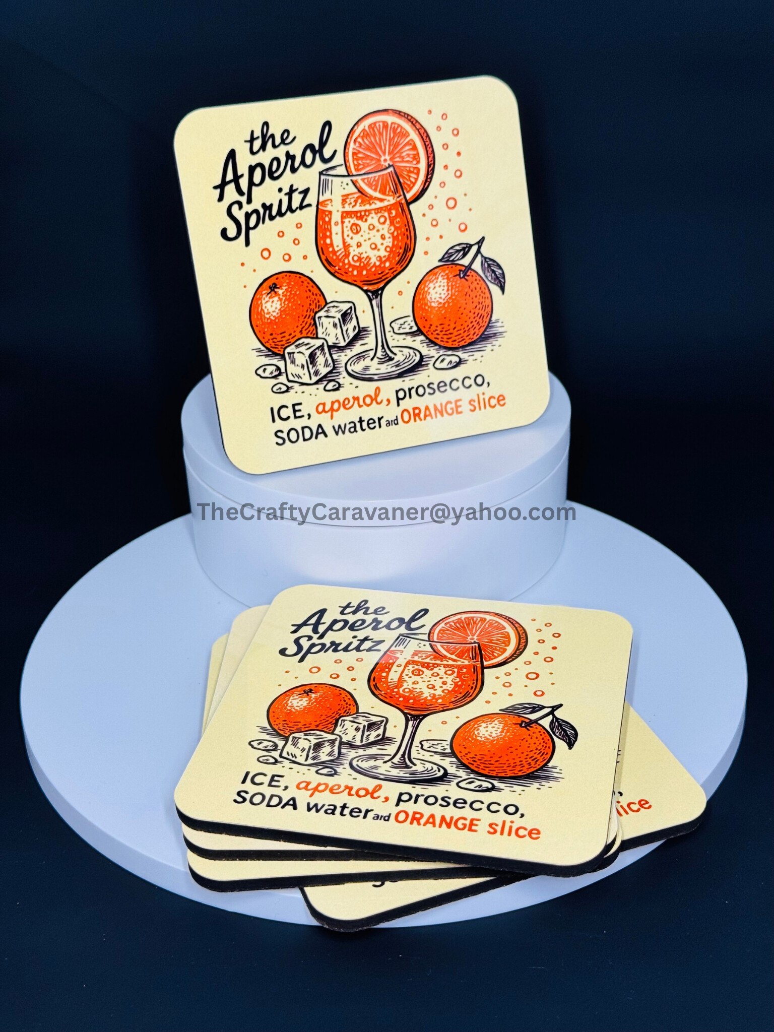

For these coasters that have a MDF core with a substrate on top and a thin cork backing on the bottom, I do 365F with 110 pressure for 65 seconds. The MDF in these types of coasters are prone to warping after being pressed, so you will need to lay something heavy on them right after they come out of the heat and leave that heavy item on until they cool completely. Even then, that may not help.
